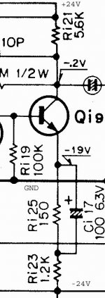

Missed the flurry of replies, sorry....here is the diagram I have been talking about. Hope this clarifies everything.
The difference between AC and DC gain is not much seeing the differences in magnitude - 1200 ohms vs 150 ohms. BUT - there is a small but insignificant change if the 150 ohms is shorted out.
Rc/Re would be overall AC and DC gain if Ce is not present. If Ce is present Rc/Re would be DC gain. Then AC gain would be Rc/re (Re is too large to take into consideration).
Addendum: The AC gain would be Rc/re when Ce is present because it bypasses Re, not because it is too large. Getting distracted by other things here and I wrongly stated that Re would be left out because it is too large.

The DC gain is not as high as the AC gain.
That is because re=~6r and Re=1k2 define the AC gain ~4.6x
and adding Re'=150r to that total defines the DC gain ~4.1x
re=~6r is based on ~4.3mA for Ic

Yes, you have all the values perfectly right. I replaced Re with 2k2. Before doing so, I removed the Ce cap and discovered that the distortion I heard went away. That was what made me decide that I would be better off turning the gain down. Now there is a 2k2 there. Everything else is the same. Gain is 2.6. Input impedance goes up as well.
Funny thing is, it plays louder at a lower volume setting now! These effects are of course in both channels. I will get this measured to see what is going on. In the meantime I am going to just keep using it, with possibly a 470uF for Ce. I like what I hear right now - it more than keeps up with present day opamp based units sonically.

So what's the purpose of the cap?
Such a large value may be a boot-strap used during large swings or turn-off?

could it be that the power supply started motor-boating due to excessive DC gain?
Reducing the DC gain then improves the stability of the interaction between the Amplifier and the PSU.

I've heard motor-boating before, this did not sound like it. More like when SS's and cymbals hit it got distorted like bacon frying in a pan - best description I can think of here 😀 2k2 certainly fixed the issue.
Antonio, the cap reduces feedback and increases signal gain. The larger it is, the lower the frequency where it takes effect.

True, as discussed earlier, but I was curious as to why the designer added this large cap for such a small change in gain. I've seen numerous designs where the shunted resistor is at least the same resistance as the remaining series resistor, and some designs where a much smaller capacitor was used presumably for some added phase margin.
