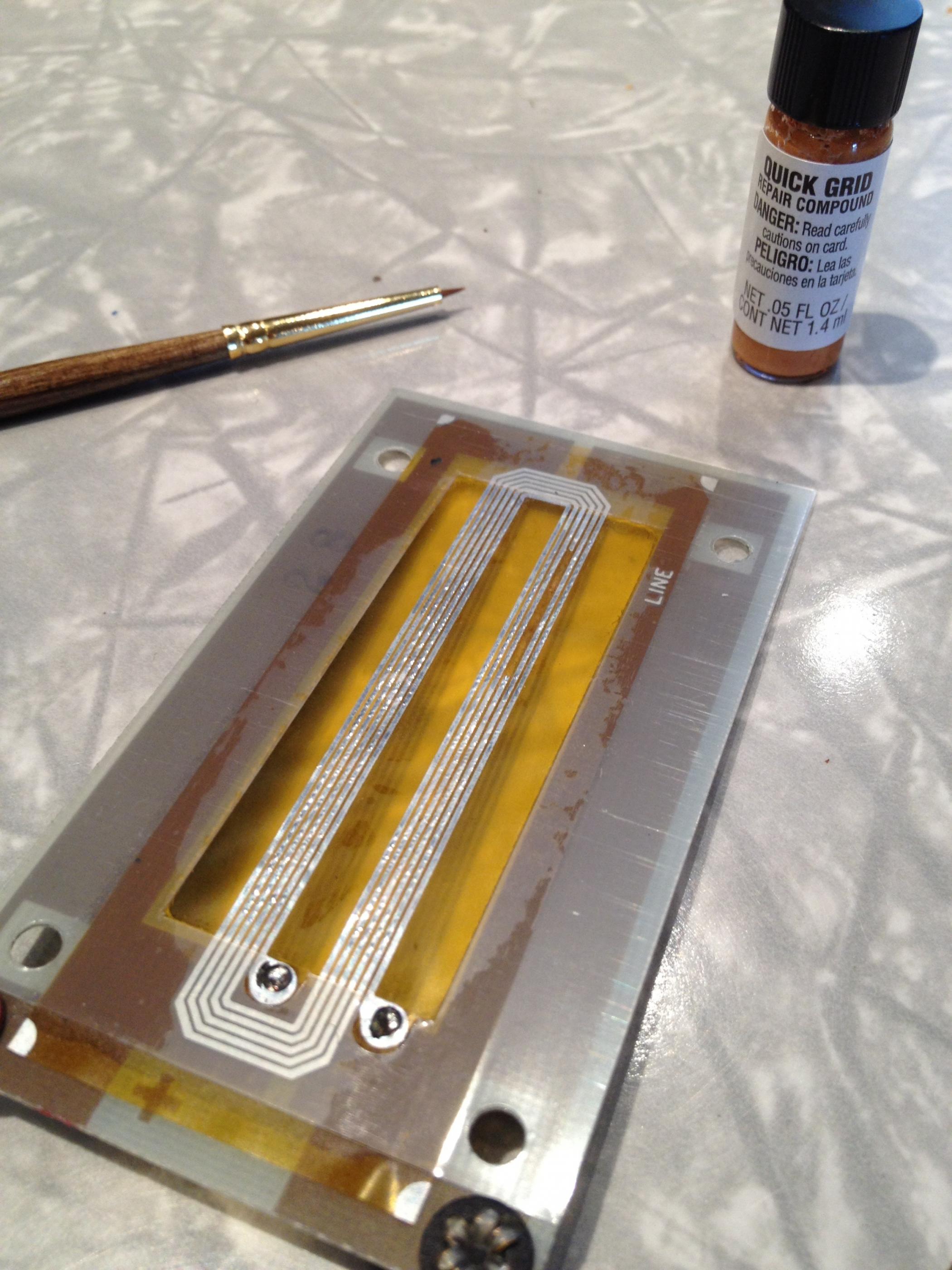

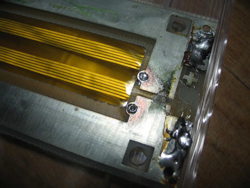

I have never worked on EMIT tweeters before, but if you are not getting a resistance reading one of two things has probably happened.... I have a pair of Infinity RS-5001 but one tweeter not working, got it out, I have put the multi meter on it no resistance...
1) One of the solder joints to the aluminum trace has gone bad
Some details of repair technique at this link:
EMIT & EMIM Tweeter Diaphragm Repair How To | Audiokarma Home Audio Stereo Discussion Forums
2) Aluminum trace has overheated and failed at some point along the ribbon path.
https://steveneudaly.wordpress.com/tag/emit/
