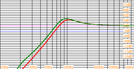

Yes i did try stuffing all 4 vents with fibreglass wadding,which i had spare from the loft insulation which was recently re-newed.
It sounds much tighter and cleaner,but only one problem,it makes the driver move like hell,and i didn't want to push it too much,otherwise i was afraid the suspension and cone might tear.
You are afraid you are going to damage the Eminence Beta 15 by overdriving it in your Euro 2.1 cu ft sealed enclosure?
Not going to happen, Bull. In a 2.1 cu ft box, the Eminence Beta 15 is 3 dB down from the midpoint at 65 Hz. Your midpoint is 94 dB, so at your point of greatest movement, 65 Hz, your are playing at 91 dB.
With a 150 watt input, (your max into 8 ohms), you can drive the Eminence to 113 dB at 65 Hz.
113 dB at 65 Hz requires about 300 cc of air to be moved. See the chart I posted-the second chart is metric-here:http://www.diyaudio.com/forums/showthread.php?threadid=5668&highlight=spl+chart The chart is direct from the Journal Of The Audio engineering Society, in an article written by Richard small of Thiele-Small fame.
How much air can the Eminence move? Well, the Eminence's air moving capability is it's cone area times it's excursion.
According to the Eminence website, the linear excursion is 4 mm. However, the Mechanical Excursion-how far the speaker can actually be driven without damage-is 23 mm, or 2.3 cm.
I have to check with Eminence to see if that excursion number is for 1-way movement or 2-way movement. If the Worst Case Scenario occurs and it is for 2 way movement, we will have to cut that figure in half, (I will check with Eminence to see if we have to cut actually do this). If we cut the figure in half, then our excursion is 1.2 cm, approximately.
The cone area, according to Eminence, is 823 sq cm. For the Eminence to move 300 cc of air-the most your amp can drive it to-the Beta 15 only has to move 2.74 cm.
That means the Eminence barely has to move out of it's linear range, and is in no danger of even coming close to the Mechanical Excursion limit of 11 cm!
About the only problem you might have is that the sealed system, by requiring the cone to move more than the bass reflex, might muddy the midrange somewhat. That will be up to you to decide. But you are in no danger of damaging the speaker by exceeding it's mechanical limits. You are not even close.
If the sound of the Euro now pleases you, keep it. I still think we have to do some work around 2000 Hz, but first things first. There is no reason to get rid of your Euro, with the ports sealed, unless you simply don't like the sound.
Sealing the vents of the Euro shut-thereby making it a closed system-actually is a very good move.
Three cubic feet-as opposed to your 2.1 cu ft-is a very popular size for DJ cabinets. Here is what your 2 cu ft sealed cabinet looks like against a 3 cubic foot ported cabinet.
The 2.1 cu ft sealed cabinet is in red.
The 3 cubic ft ported cabinet is in green.
See how little difference there is? By sealing the cabinet, it just so happens that you come very close to the performance of a ported cabinet 50% larger!
Usually ported cabs give deeper bass, but not in this case.
The only issue left is the fact that the greater movement the sealed cabinet requires might muddy the midrange somewhat. That is a debate going on among audio fans-many claim that the difference is not hearable. It is up to you to decide.
I am not trying to convince you to keep the Euros, only pointing out that by sealing the vents shut, you might actually have gotten the bargain you hoped for when you bought them. Of ocurse, if you simply don't like the sound, by all means get rid of them.

A sealed system will always make the cone move more, because the cone provides all the bass output in a sealed system. In a ported system, the vent provides most of the deep bass.
However, I shall show you the Eminence Beta 15 can easily work in your cabinet sealed and there should be no problem with excessive cone excursion.
The Eminence Beta 15 you have has a linear excursion of 4 mm and a mechanically limited excursion of 23mm-almost a full inch.
I just called Eminence about another matter, and asked about their excursion ratings. Those ratings are for both directions. In other words, going from front to back, the Eminence Beta 15 has 8 mm linear travel and virtually two full inches mechanically limited travel.
What you want in your speaker is up to you, of course, but it is unlikely that you could push this unit past it's mechanical limits with your cabinet sealed.
In the following thread is listed the volumes of air a sealed speaker must move to produce certains SPL's at various frequencies. The lowest frequiency your speaker will reproduce is 60 Hz. It helps to hit F11 when reading this chart.
http://www.diyaudio.com/forums/showthread.php?threadid=5668&highlight=Displacement+SPL
The Eminence has a cone area of 132 sq inches. With a one inch mechanical excursion limit, it can move 132 cubic inches of air.
132 sq inched for 60 Hz produces an SPL that is so high, it is literally off the chart!! However, one quarter of the Volume Displacement, (32 cubic inches) produces a whopping 117 dB SPL at 60 Hz. That is about the limit of your 150 watt into the Eminence. And the Eminence still has 3/4 of it's voice coil to go before you chance damage!!
Again, it is your speaker, do what you wish. But if cone excursion was preventing you from this box as a sealed system, you now know that there should be nothing to worry about.
