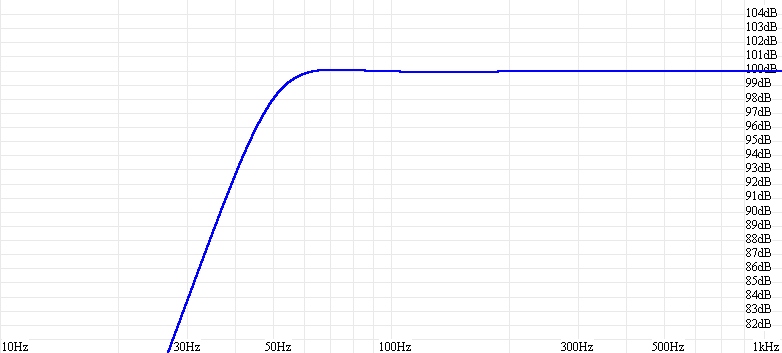

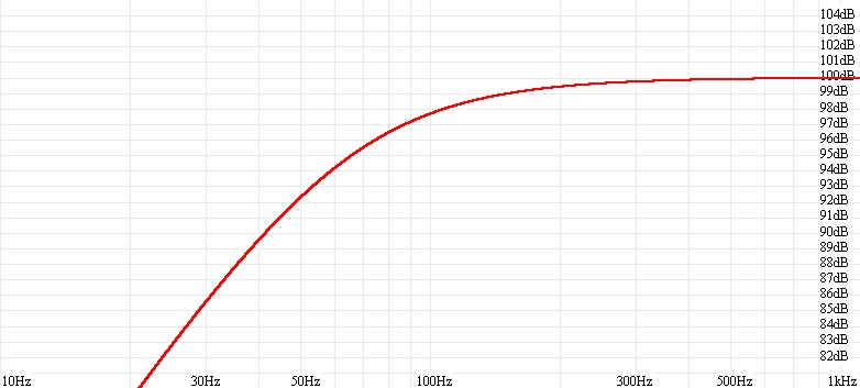

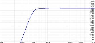

This is the response for 2 x Eminence Omega Pro-12 in a sealed enclosure ( 125 l ; 15% damping ) .
