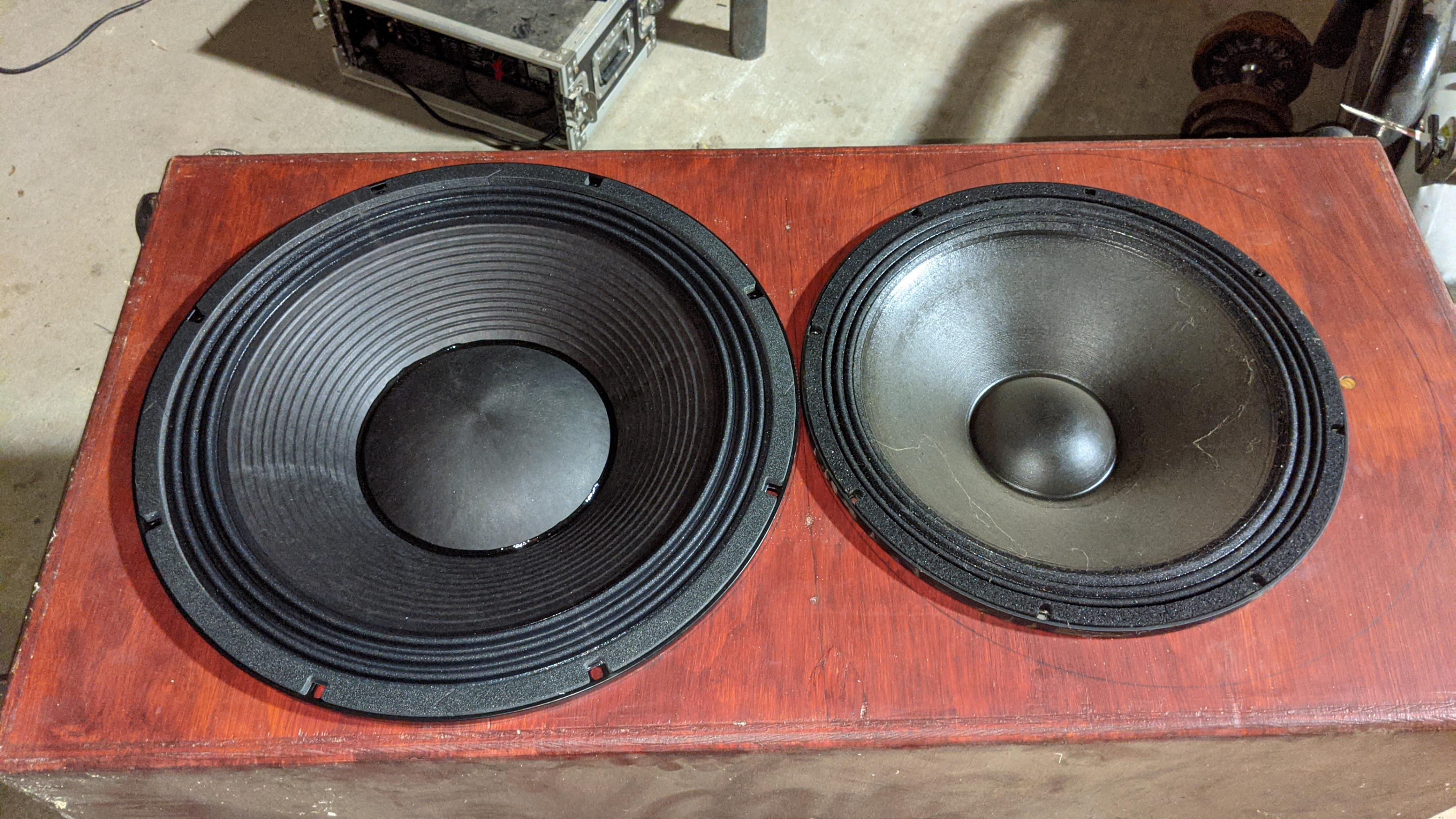

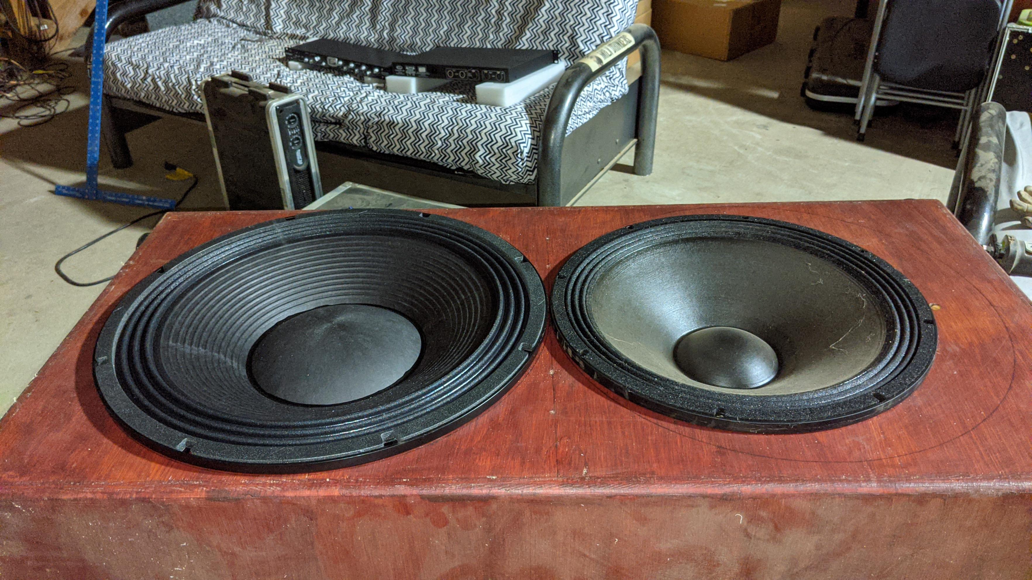

Finally getting around to it. No esoteric box here...but four of them will easily exceed my needs/wants.
Will be adding bracing to the sides and rear. Baffle is double stacked .75" glued with a thick layer of polyurethane adhesive.
New tuning will be in the mid 20's in 7.5ft. One channel per driver from a PLD4.5.
Probably won't get more than 13mm one way excursion above 25hz. Well below any force loss or suspension tightening.
