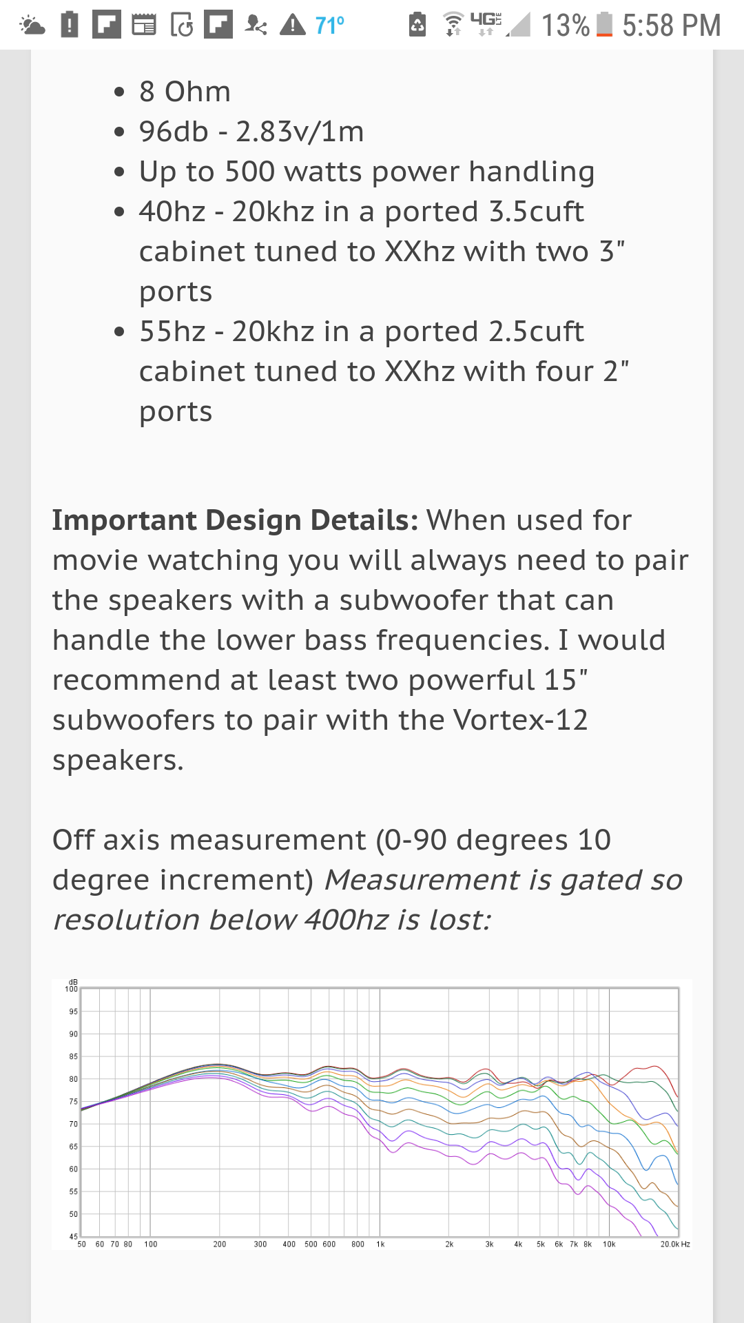

Patrick Bateman had some thoughts on phase plugs and what Kef is doing with the Tangerine tweeter in their coaxs.......I think a DIY application here with the right compression driver might take these drivers to the critical hifi level.....the DIY soundgroup stuff while well thought out, appears to be more focused on efficiency and high output for theater applications.
there's a link on the diysg forum but I'm having a hard time getting it on here!
it at HiFiCircuit
best I can do!

Seems the Vortex kits is gone?
I spoke with Erich, and he is waiting on parts for the Vortex kits to go back up. They may not do more production runs after the stock on hand is gone, due to cost and lack of sales. When they get put back up, I would jump on them. He and Matt rave about them for a music listening setup. I want to build the Vortex 15, in a Tannoy style full range enclosure. Glenn.
