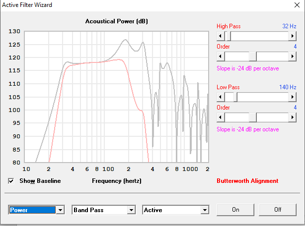

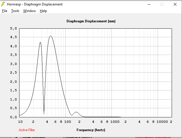

I just checked the design and the only advantage is low extension at the expense of small sensitivity loss - but the box is really small. The 40 Hz MLTL I originally suggested does not still look bad to me either. Is there something wrong with it? I of course intend to place a HP filter to limit excursion and maybe even some EQ as you and Bjorno did.

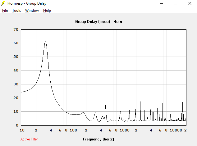

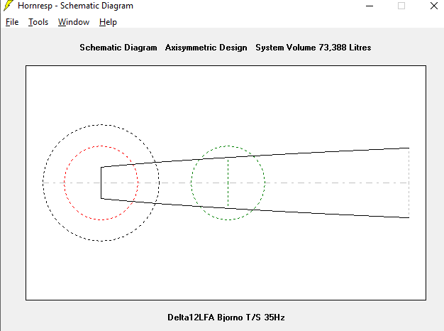

I think I settled down to standard BR - 100 l volume including 60 cm long expanding vent, so it might be called a BVR I think. The outer dimensions will be 654 x 436 x 456 mm (HxWxD), the box volume is 70 l and the vent is expanding from 200 cm2 to 800 cm2.

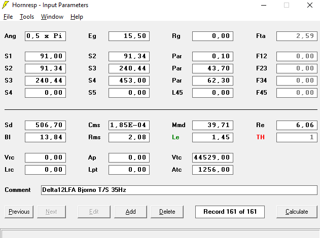

akvaro, you simed in 0,5pi...
Pelanj, you'll have to measure your own driver T/S, and it parameter will diverge from T/S. The higher order the box, the more sentitive to parameters it is. TH are kind of 6th order box depending on tweaking.

I measured the Delta12LFA - and (except for the Fs), they are more or less in agreement with the datasheet values. By measuring the impedance curves I actually found out there was something wrong with the second speaker.
Using semi-inductance parameters in hornresp change sometime things enough on it own, as did bjorno in post #15 using virtuixCAD inductance tool tweak. It's more of a concern with long voicecoil/or 4 layer voicecoil/high Le speakers/without demodulation rings, but yet his sim is reaveling.
I finally need to build a box that was designed in Hornresp and measure it🙂 I had some success with sealed and BR, time to move up to the QW league. I built only one ML-TL with Beta12CX designed by GM and that was for a long time my poor student's reference speaker and later served as a vocal PA for my band. So a success as well🙂
