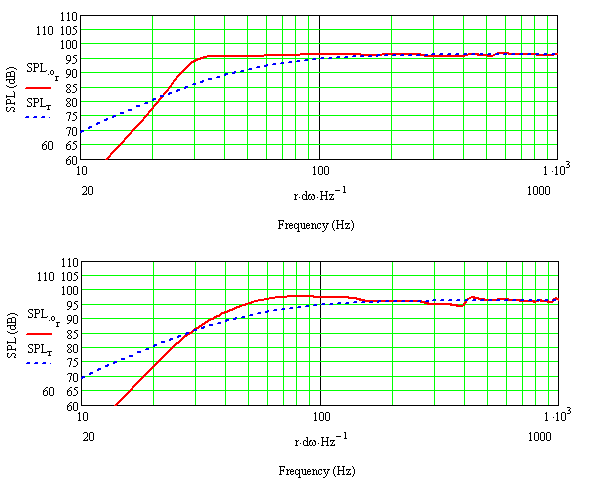

Here's two; top = max-flat alignment; 48in, 400in^2 CSA, Zd = 21.375in, Zp 45in, vent = 6in diameter x 0.75in long. Line top, back & one sidewall 1in acoustic fibreglass or similar & adjust this & vent length to suit your own requirements. Bottom = borader-band PA style alignment tuned to Fs, Vp = Vas (rounded up slightly) 48in, Zd = 19.25in, CSA = 174in^2, Zp = 45in, vent 6in diameter x 4in long, same damping.

For the upper FR trace, the box is 48" tall, and 400 square inches in cross section (20 x 20, or some other dimensions to make the same area). The driver is centered 21-3/8 in from the top. The port is centered 45 inches from the top, and is 6in diameter x 0.75in long (i.e. a 6" hole in the front of the box, the thickness of the plywood is the length of the port). Big box indeed!
For homework, translate the specs for the other version! 😉
Let me rephrase that . . .
Scottmoose, thanks so much for running the 2 simulations. I understand the response curves, but your 2 box specs use terms I'm not familiar with:
Curve 1:
48in, -- I assume this is height
400in^2 CSA -- Not sure what this references - Cross section of something?
Zd = 21.375in -- Depth? Acoustic impedance of something?
Zp 45in -- ? Acoustic impedance of the port ? Not sure . . .
vent = 6in diameter x 0.75in long -- Got it
Curve 2:
PA style alignment tuned to Fs -- Okay, makes sense
Vp = Vas (rounded up slightly) 48in, -- Port volume = 48 inches? 48 cubic inches?
Zd = 19.25in, -- Not sure
CSA = 174in^2, -- ??
Zp = 45in,
vent 6in diameter x 4in long, same damping. -- Got it
Thanks for your effort - sorry I don't totally understand the result.
Already covered above, but, internal dimensions
48in = vertical height
CSA = Cross Sectional Area of the Line.
Zd = distance of driver centre from throat (closed end of the line)
Zp = distance of vent centre from throat
Jeff, yeah, top is a max-flat alignment & it'll need adjusting via damping or vent tuning to suit the room & system etc. in practice. I generally tend to give this alignment for forums as it's the theroretical 'ideal', albeit on that understanding. It's easier than trying to second guess the room & system characteristics, taste etc.

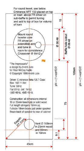

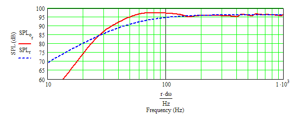

FWIW, Andre Jute's similar Impressario:

I could live with that box. It's tall but shallow, which would work great in my room. Is that shallowness what's causing the big midbass bump? Any ideas about stuffing this box? Scott, would you use the same damping method you proposed in your first model, at least as a start?

The sim is minimally stuffed its entire length with 0.2 lbs/ft^3 polyfil, so any more will begin raising its F3 as it flattens the mid-bass 'bloom' out which is caused by the box having a too small a net Vb for the driver's specs. Normally though, it's adjusted by changing Fb, so you can increase it with a larger vent or a longer one to lower it, i.e it's a common way to dial in acoustic BSC as well as a lower Q roll off for near wall or corner locations.
GM
Wow! The beginnings of understanding why stuffing a box makes it appear larger to the driver.
