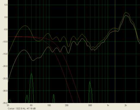

I know you asked Rudolf, but I thought it might help: here are my Ypoles with Alpha15A and their response curve (equalized and unequalized, both with a notch filter in place against the TL peak). The bump at the lowest frequences is probably a measurement artefact (measurement has been taken at approx 1 m in the middle of my room, time window pretty long, 30 ms I think)
You can see that I have shorted them from the original length (to push the resonance higher out of the passband). Subjectively, I have preferred to cross them as low as possible (as permitted by the excursion of the midrange), currently 120Hz. Higher up would be theoretically better, but I get an unpleasant resonance.
I dunno what you would get out of the Deltas, which have significantlly lower Qts. Probably you will need more Eq.

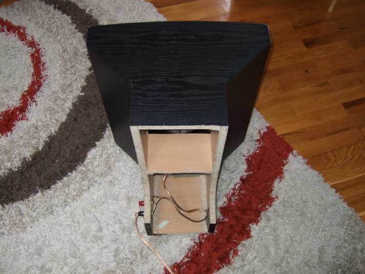

The original question was:
If I wanted to build a H-frame with two drivers, would it be advantageous to put a separator between the two drivers, kind of like two single H-frames stacked?
I answered that there would be NO difference
when putting a diagonal separator across the H frame of a single driver, I got the following measurements:
I can´t see any difference there. Regarding the proposed example I would - for symmetry reasons - see pressure (and pressure variations) on both sides of that dividing shelf exactly the same. So it should make no difference if the separator is there or not.
Of course you know much more about dipoles than I do, so I would be very interested to know where I am thinking wrong this time.

I was talking of frames of the same physical depth. That said I figure it the same way I figure a W-frame has greater effective depth than an H. 🙄john k... said:??? I'm not sure how you figure an M frame has greater effective depth than an H.
Uh, well.
May be I should not have called it separation distance. What I mean: My M-frames show their dipole peak at almost the same frequency as a U-frame of the same size.
If you could give me a bit more time: This weekend I have completed a selection of dipole test frames to compare: M-frame, U-frame, H-frame and Ripole (W-frame) - all of identical depth and front/back area. I will do measurements with the same driver to compare, what they do different. But this will probably take a month until finished.
