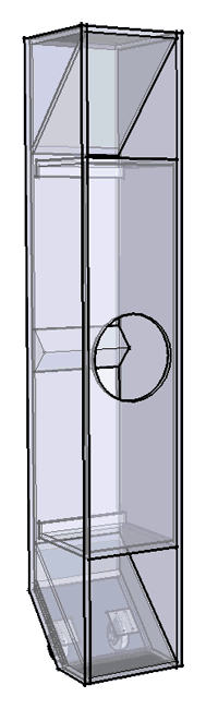

Maria Update
Any plans yet? After the double Chang I want to do a pair for my work shop in MDF. Thanks for all of your efforts.... I have placed an order for a pair of 12ltas.
