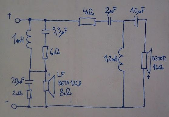

Hi, I think it was a third order hipass with "nominal" frequency at 2200 Hz (but have not simulated or recalculated the values). In any case, I have noticed no issues soundwise or power wise. I doubt that the crossover guy would do something out of specs. I cannot find the old conversation online anymore.
Joined 2008

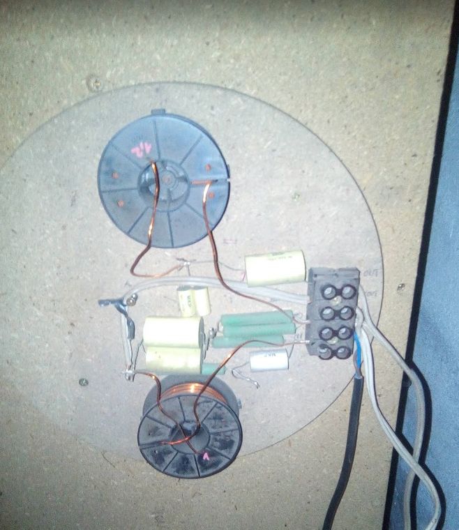

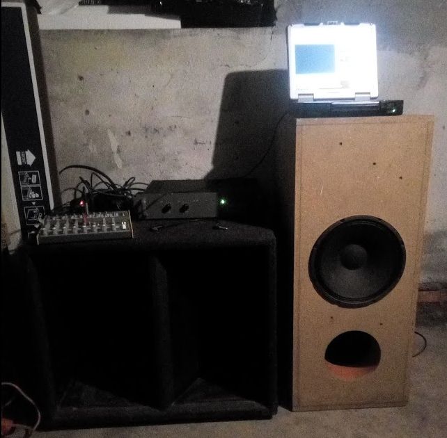

Just some clarifications
So I have redrawn the crossover schematic and taken two pictures. It has been always a basement speaker and it will stay in my workshop. In the picture it is tested along a basshorn. The results are very promising so far. My memory told me, there was bass with these speakers...but with the bass horn, there is more and better:)
