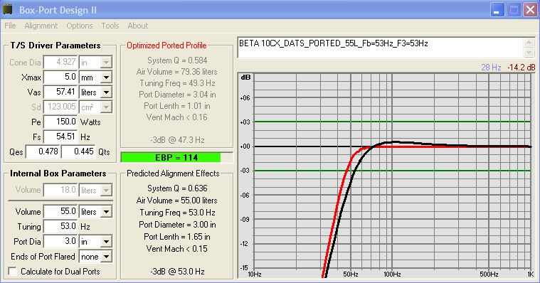

Testing out the 10CX coax. Box is BR (Int Vol=52L).
ZMA file download
Regards

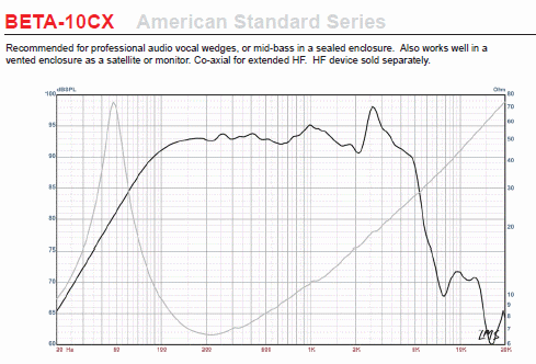

Thanks for the suggestion. Eminence plot does look rather frightening. It took a leap of faith to purchase this driver. Generally, I avoid drivers were I have to do a lot of correction. Reason I committed on this 10CX is I'm curious to know how well it compares to my Radian Coax.
If you think the midwoofer on-axis plot is bad, just wait until you measure the effect it has on your compression driver on-axis response.
We're talking a huge -22dB notch at about 6khz and several smaller notches. Off-axis it measures a lot better though.
Most important to note is that frequency response rarely has much to do with sound quality though. A frequency plot can be used to detect were something could be improved but you really can't say from a frequency plot that a driver sounds bad from the start. Horrible sounding drivers often measure really well on a frequency plot.

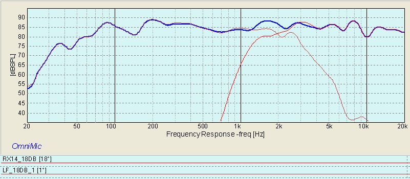

That's a deep notch. Have you tried reversing the phase of the compression driver.
Please post the fr plot of your 10CX (on-axis). It'll be interesting to see what kind of response you're referring to. By the way, what is the compression driver you're using?
I'll be out of town for a couple of days. I'll respond when I return.

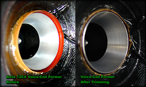

The notch is due to LF drivers voice coil former protruding from the mouth of horn. If you dare to remove dust cap and know how to cut protruding part you could get rid of the notch (or most of it). But in practice it won't bother you and will not spoil listening experience although it looks ugly in the graph.
Well, it seems that I was wrong. I found K&T CT235 project and it say that 6kHz notch is "ein Phaenomen, das durch die Bauform des Hochtonhorns verursacht wird", meaning that the bullet inside horn is responsible. And graph shows it with APT50 measured alone, without being mounted inside Beta 10CX, although LF drivers vc former protrusion seems to enhance the effect. If you want to get rid of the notch at any cost you can replace APT 50 with another compression horn driver that does not have bullet plug inside.

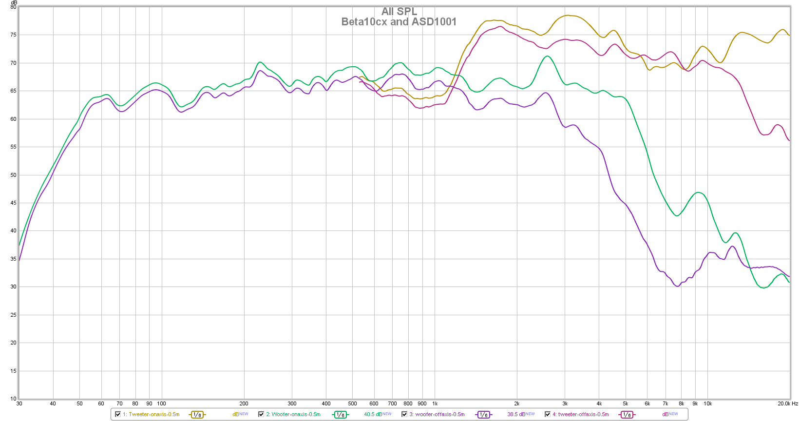

Hello All,
I am working on a speaker using Beta10cx and ASD1001. I have taken some measurements of this combination to see what the general view is.
Measurements were taken using room eq wizard v5. Off axis is as shown in the picture, I did not have an protractor to hand. Levels are all relative but are all taken at the same gain settings so can be compared with each other (as I can't find my SPL meter).
My initial observation is that the ASD1001 goes much lower than expected and that the 4k - 12k broadband notch is not observable off axis. In general the offaxis response looks much better than the on axis. The reduction in woofer level <230Hz is the expected baffle step, bass response is close to predictions.
Hello kipman725
Thanks for sharing your measurements. The 4k - 12k broadband notch is quite usual. I don't believe I've seen anything quite like it before. Normally, the horn response either tapers off linearly or sometimes with certain compression drivers, there's a sharp cone breakup at about 10K-12K.

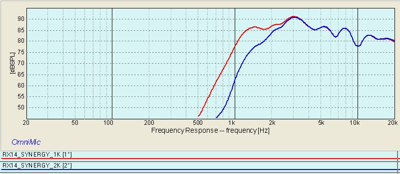

Presently, the compression driver I'm using is a Peavey RX14, a 1" titanium compression driver. The frequency response plot is below. Disregard the region below 500Hz. You can see the effects my room has on the bass measurement.
I will be testing it with a Selenium D220Ti later. I should be able to cross at 1,500Hz with the D220Ti.
