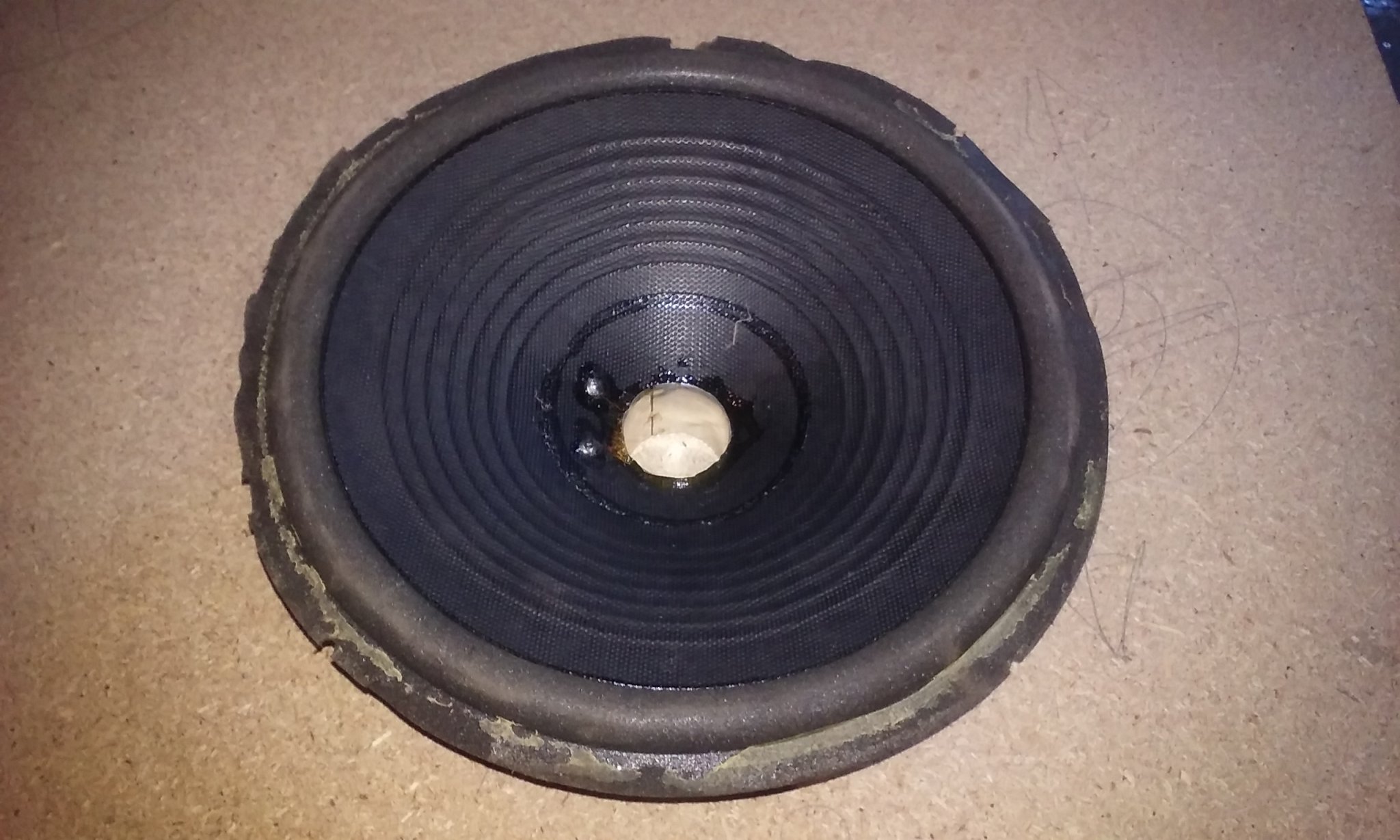

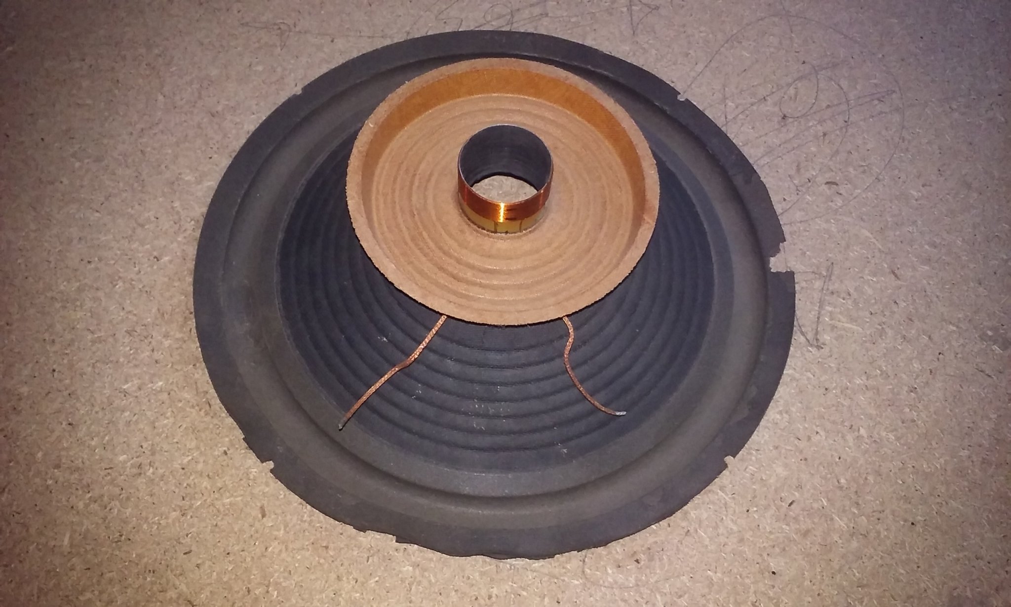

One of hundreds I unglued to recycle/clean/whatever:
Yes, it does not look "new" 😉 and in this particular case (not yours) edge suffered because it was the weakest of the weak, a foam edge.
Toluene dissolves foam.
And even so, once reglued it will work fine, specially after a cardboard edge is glued on and a couple little contact cement squirts are applied over foam edge cracks.
Guaranteed: reglued speaker will work as good as new, measure the same, etc.
Cloth or paper edges are even better, toluene dissolves cement but does not attack them.
Notice suspension which is treated cloth looks perfect.

Hard task. I never disassemble a LS in such a depth. But I did clean particles in the magnetic gap.
CB15 looks like a cast frame driver.
So Eminence should offer a re cone kit.

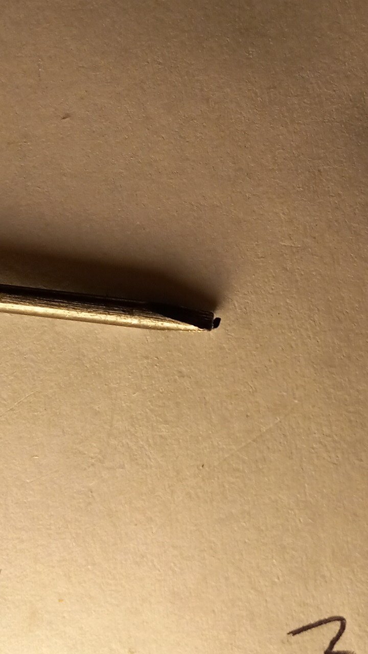

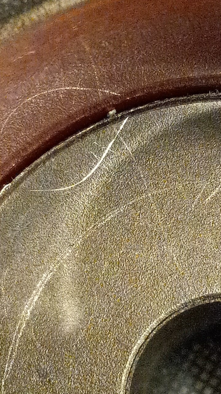

I found many of these "steel wool" particles all over the back of the magnet and they readily, or somewhat readily, attach to a small ceramic magnet.
However I don't think I'm going to get all this crap out of the gap, and I'm not even persuaded that it's the cause of the rattle. Obviously just doing this "for science" at this point and to annoy people who wish I would give up. 🤣 Your contribution to speakerology is acknowledged.
That last piece is a big chuck to come out of a voice coil gap. Have you tried it after the cleaning?I am pleased to award you the points for this answer, sir. 😆
You still can't really get to the outside edge of the gap short of un-gluing the cone.
It sure is a big chunk, and I pulled several of these out! That's why it seemed reasonable to hope it would clear up, but the rattle is unchanged. This magnet inhaled a lot of metal. Made me think these aren't even the problem. It doesn't scrape from just pushing on it, only when producing sound. I wonder whether paint thinner would work to unglue the spider and cone, because I don't plan to spend any money here.That last piece is a big chuck to come out of a voice coil gap. Have you tried it after the cleaning?
