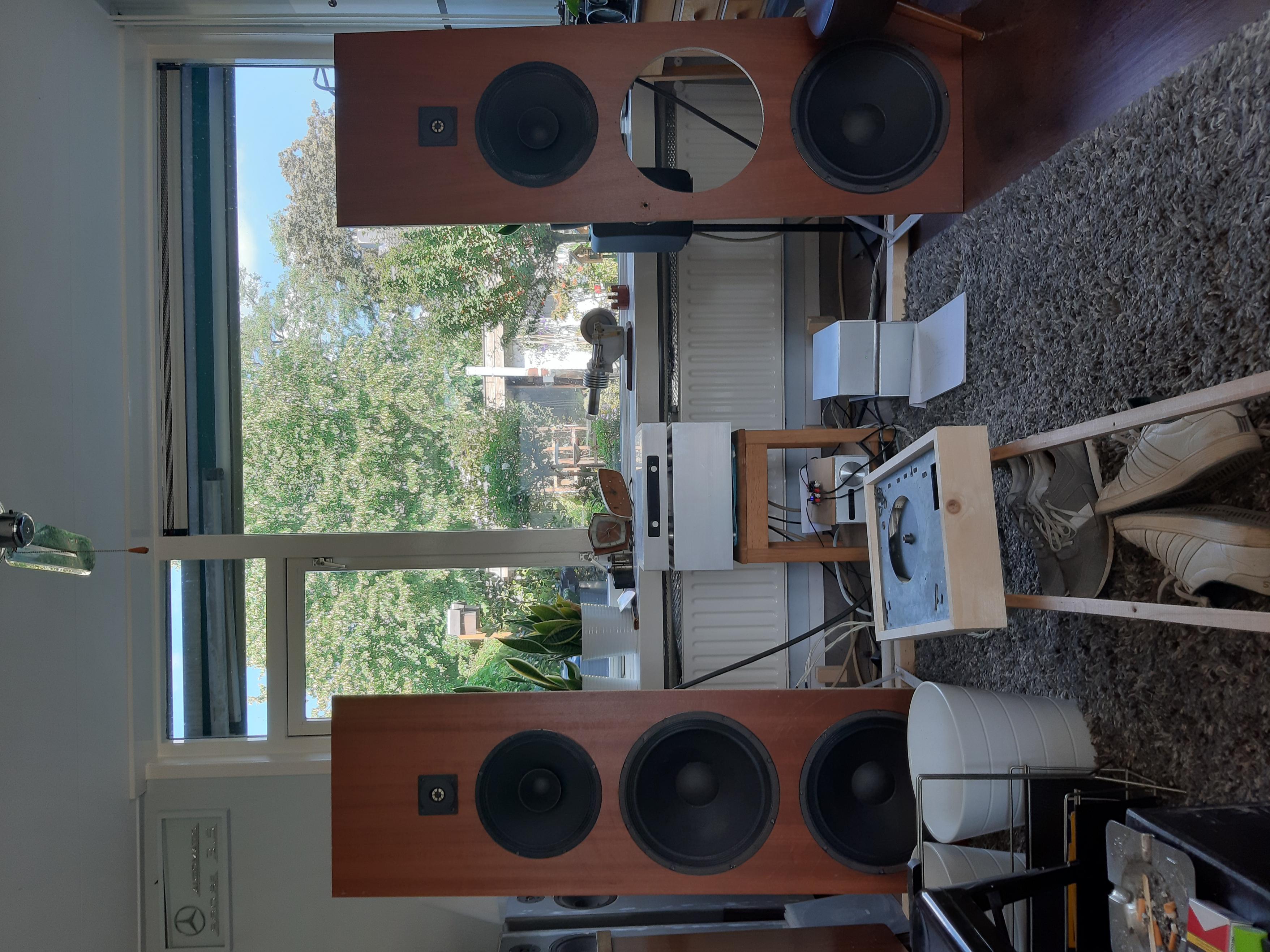

There is good news and some bad news. The good news is that my MiniDSP arrived en I managed to get some large holes in pair of old door and fitted the drivers.
I got the MiniDSP up an running... In the first test however I noticed that one of my Alpha 15A was stuck.
I removed it to investigate... It does move but very difficult.
So I wil disconnect one of the Alpha's on the other speaker so I can at least listen to it tomorrow....

The replacement driver is on its way... how was my day with "just" one pair of Alpha 15's? Is was pleasantly surprised about the amount of basic. But it is loud! And kind of cold.... I have no experience or knowledge about minidsp and put in place the simplest of simplest settings, so I think there is a lot to gain.
Oh and they are large! I have seen a lot of pictures with this setup, but now standing in my modest living room they are huge!...haha
