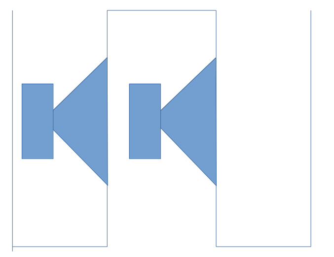

If you consider having a low frequency cutoff of about 30Hz low enough then I can recommend used them in an M-frame subwoofer. I built such a thing using two Alpha 15A woofers per side a couple of years ago and it was great. It will need a bunch of EQ to remove the resonance peak around 250Hz and flatten the response, but with two of those drivers in parallel it can work well and produces some satisfying SPL. I still have them in my basement.
Pictured here, the white things on the floor:
https://techtalk.parts-express.com/filedata/fetch?id=1421209&d=1568144365
In the picture that is the rear...do you have a front picture too? Did you make the woofers fire through a couple of ports per woofer for a 10 to 1 compression or just have the whole the size of the Alphas?
I am looking to use a pair of the 15As per channel for my surround channels with a k510 horn on top of each speaker. Crossing over @500hz and most likely use a sub too.
Do you have anymore info you could share...like dimensions of the cabinets. I will be running REW for a active crossover.
Thank you.

The front and rear of those speakers looked exactly the same. The M-frame is 100% open, front and back
@WhiteDragon there is no box... The drivers have a weak magnet, but this gives them a relatively high Qts that is perfect for partially offsetting the dipole losses. Xmax is only about 4.5mm but two of them gave enough Sd to make some decent bass in that configuration and they were only used up to about 200 Hz.
