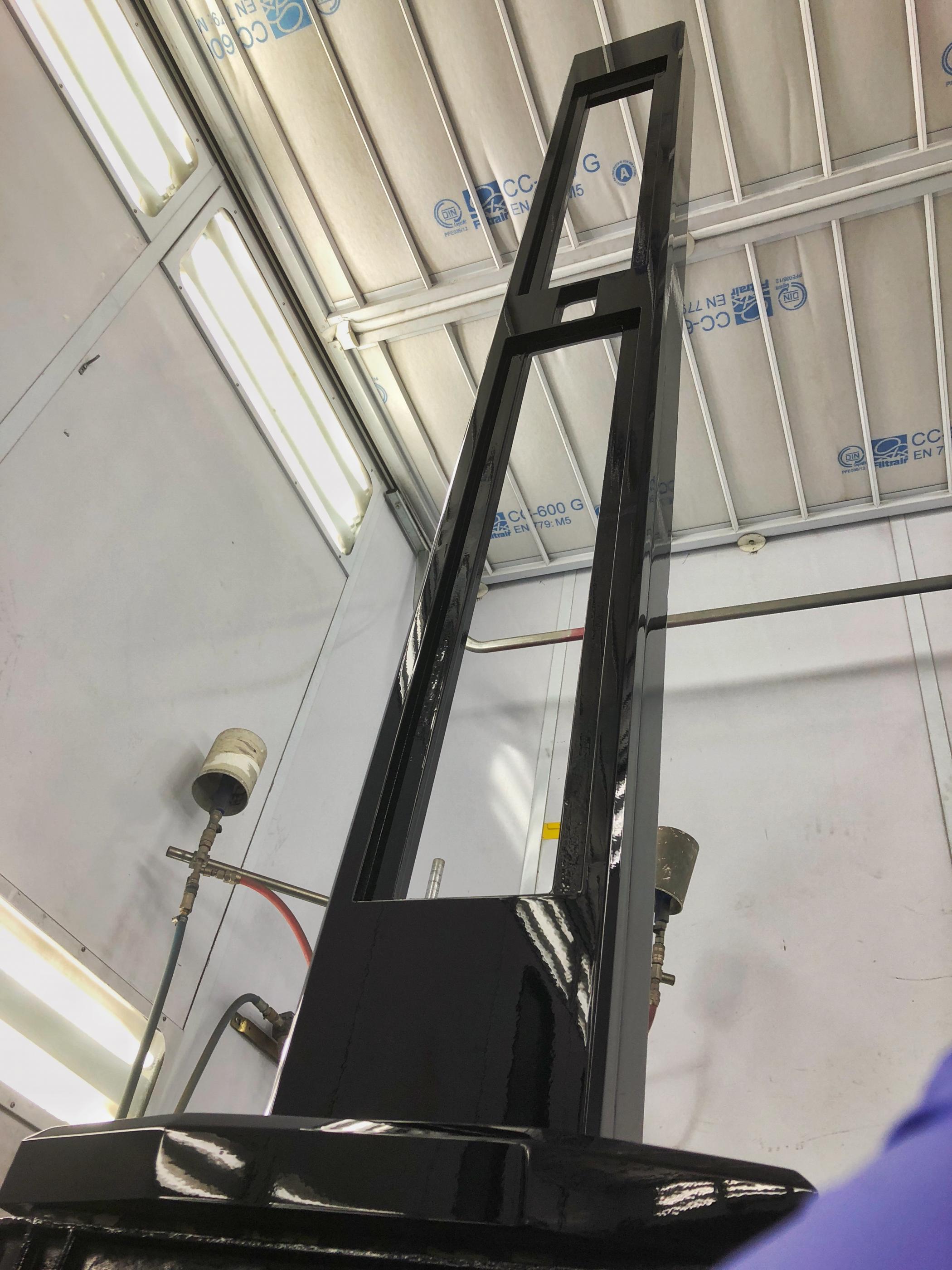

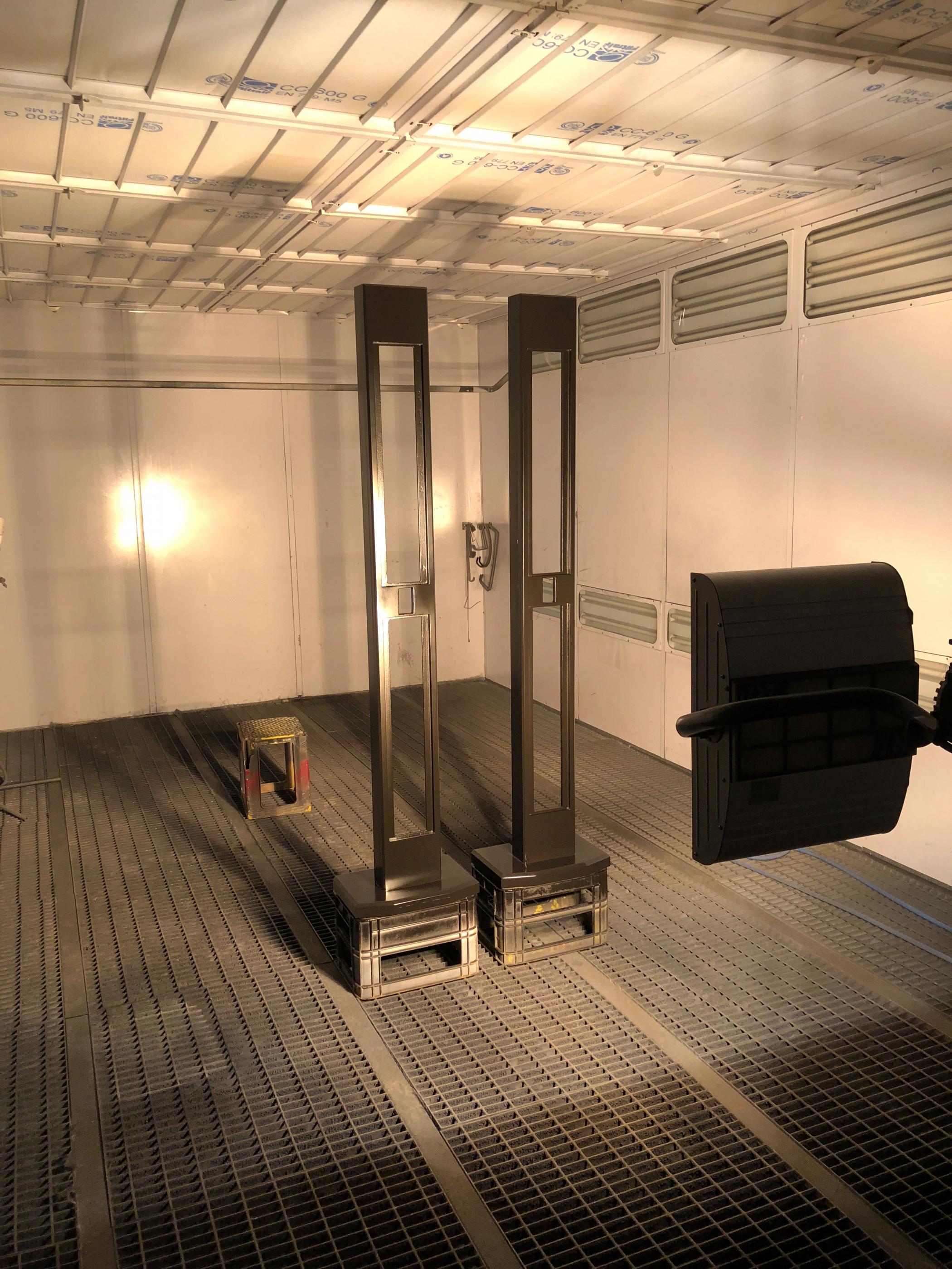

Still working on my new baffles, running with 8 Emim for a while. The new baffles wil also have 8 Emim. The senter of the baffel is made of mdf, and is about the same widt as the RS1 baffel. The sides is made og glass and vil also be about the same widt and angle backwards as the RS1 baffel. It feels safest to yuse about the same dimensions as the orginal baffel. It only higher, about 190 total.
The baffels on the picture has been primed 2 times to get enough to sand on before i paint them gloss black.
They are IR dryind on the picture 🙂

Paintet and ready for the glass.
wow thats not a regular paint job by a amateur for sure ! looks great !

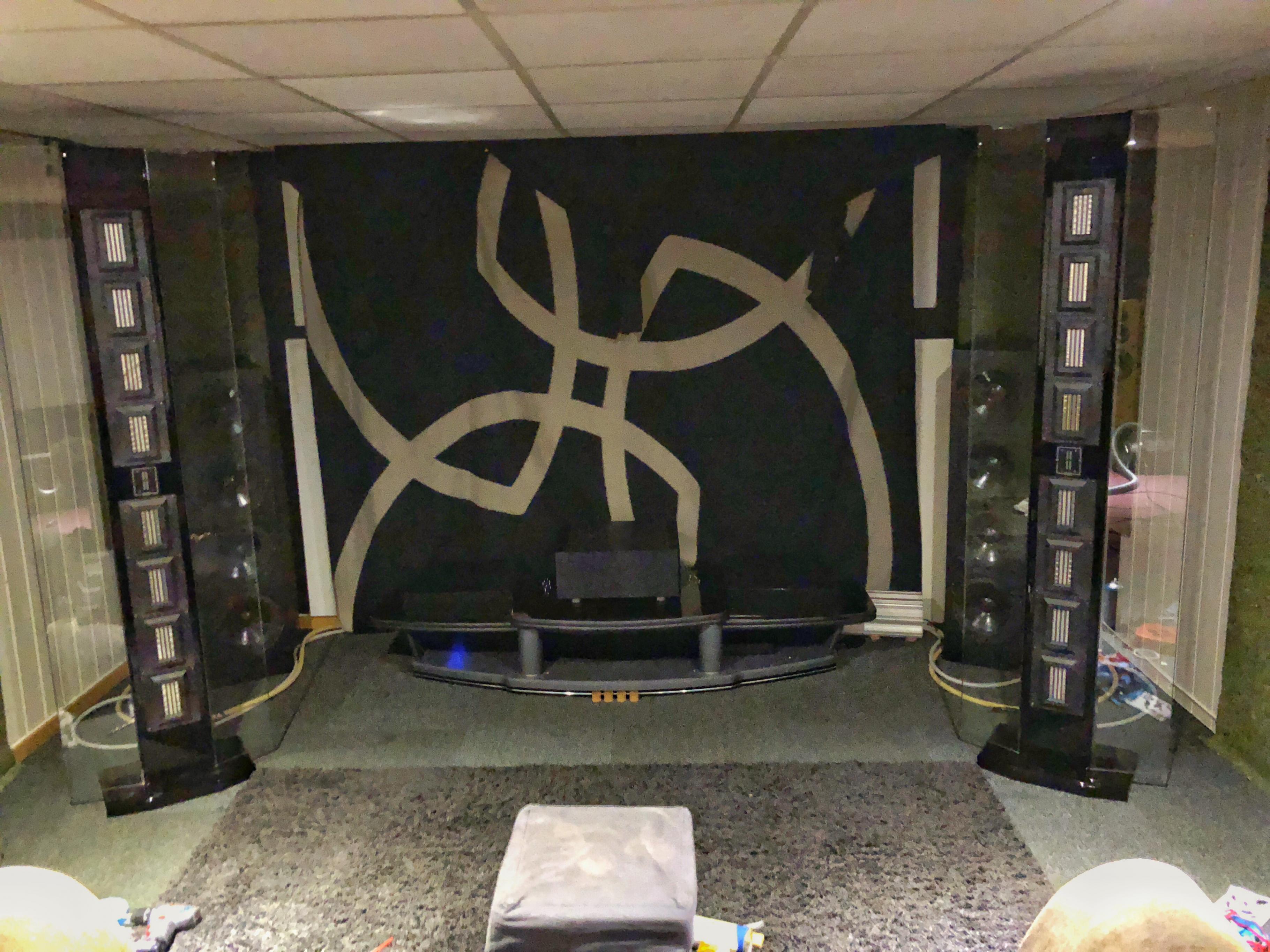

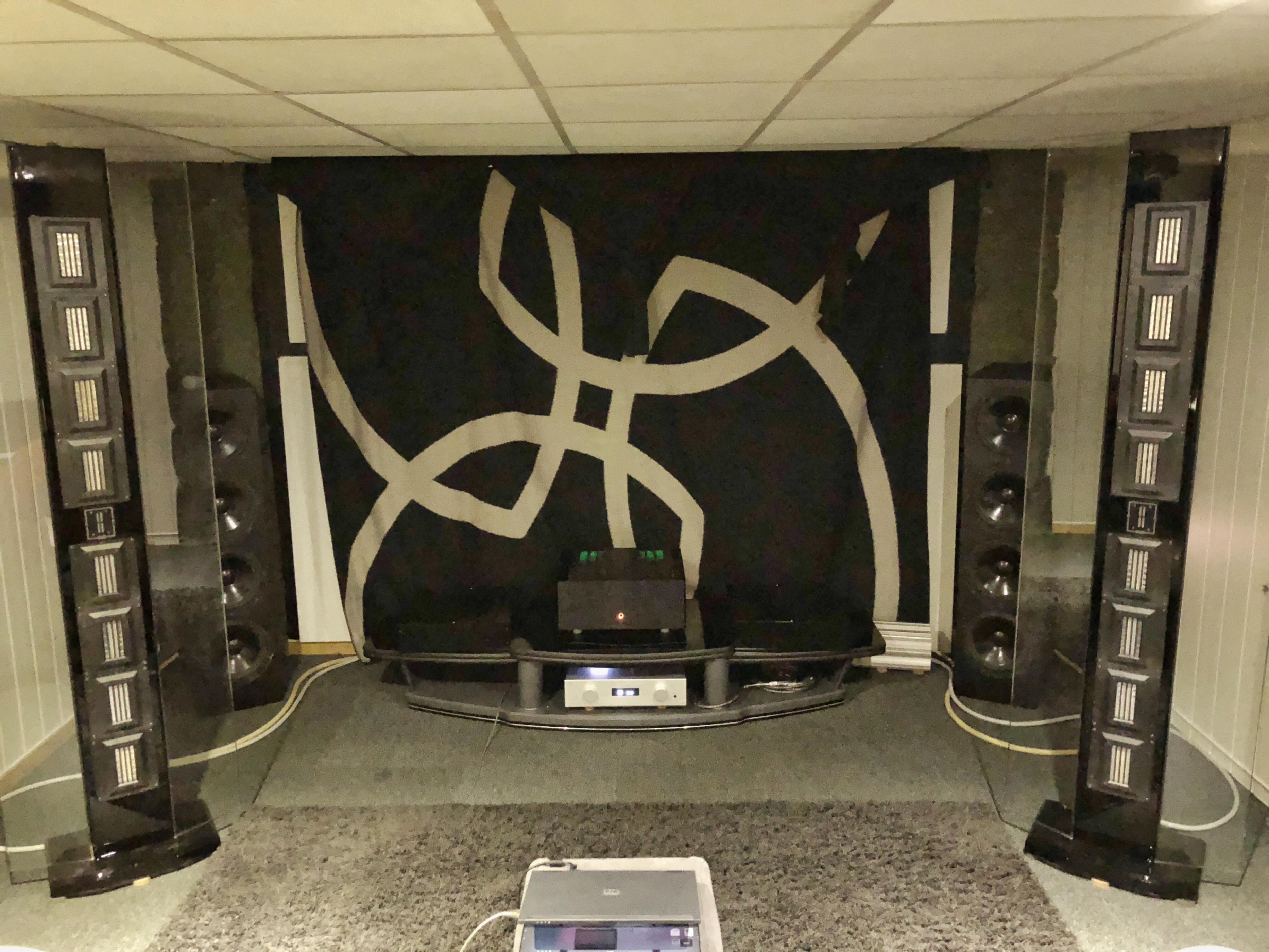

No they both are playing with the bass system. Crossed 280hz with at simple 12db passive filter. The bass system are crossed with av DBX PA filter.
The sound is awsome.
Later i build the bass system with 12 pc Infinity 10" polyprop woofers. In a dipole baffel.

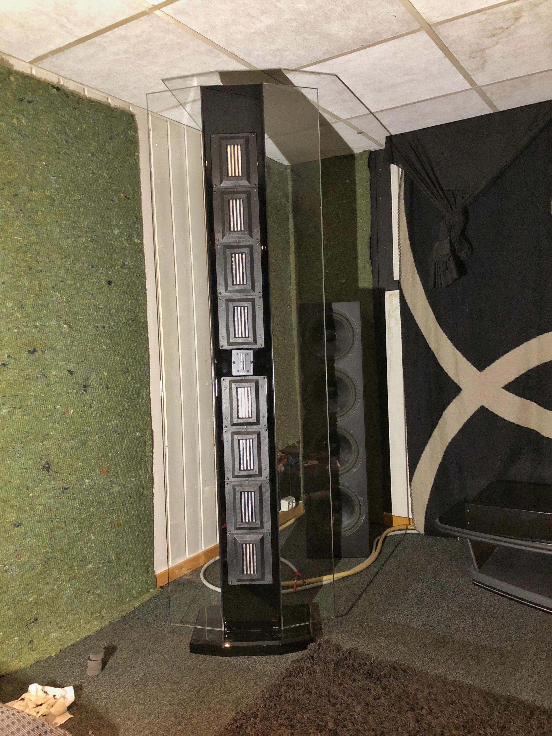

You should bring the 8 of them down to 100hz, i do that on my 4.5's with no problem, I just don't run them over 90db peaks, makes a far nicer midrange with vocals and image far better. How are they sounding with out wings, beamy at all?.
100hz i think its a bit low, but planing to test them little lower.
Havent tried them without wings, i suppose i loose the lower end with a narov baffle. The baffle is 60cm wide.
I just noticed the clear plexiglass
Its regular glass, 12mm hardened 🙂 The with is the same as RS1 baffel and
Angeled backwards is almost the same as RS1. I thaught it be safest to use sizes from the original 🙂
Looks pretty good, I sure wish we could hear it. The little bass towers look totally out of place...lol.
The bass system is just for test. Im building the 12x10" Infinity polyprop dipol bass system later, i have al of them waiting 🙂
My experiense from earlier testing says that crossing the bass so high suits the placement on sides of the Emim towers. More details smack and fun 🙂 With my Emim test baffels i used other bass system.
