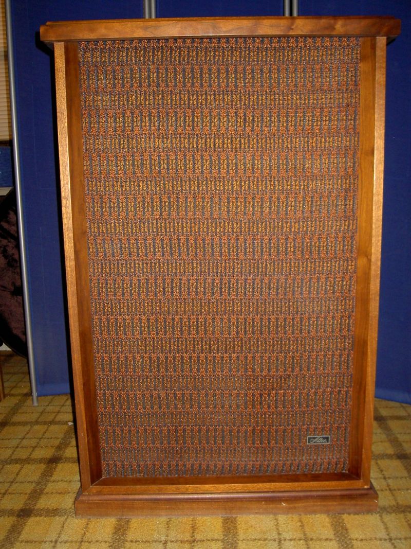

Hi, The box size sounds right. I used a pair of similar Great Plains Audio 416-8B (alnico) in an actual Altec enclosure of as near as I could figure 206 L. Lovely sound. I could not get the horns and drivers to match so I used SEOS 30cm wave guides with Radian 475PB drivers the crossover (12db/oct) worked out best at 1700HZ.
Thanks Bruce - I hope to be able to keep a bit under 200l, but not sure what could work unless having input from people like you.. and not sure these drivers are great or just old and I would be better of with a Faital Pro 15pr400 or a more common Altec. - have you ever came across the Emilar stuff?
