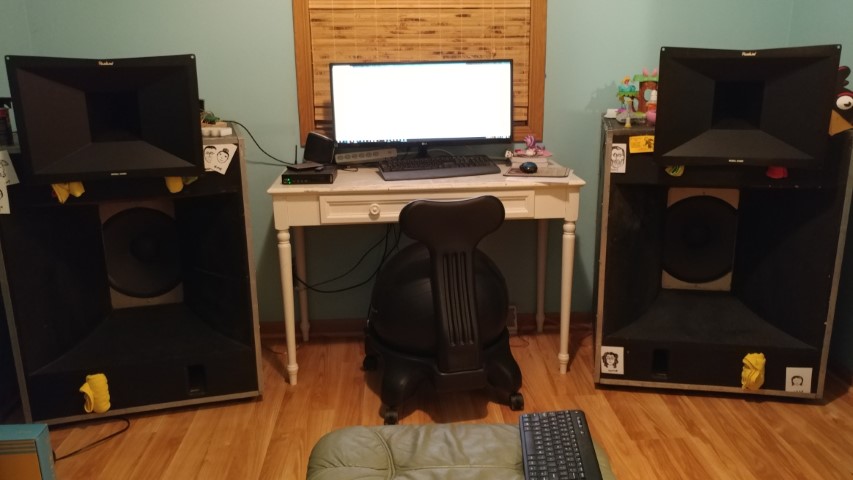

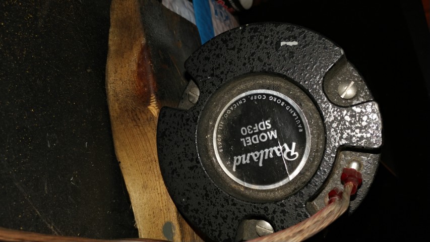

This is the hf setup in the Rauland mls1 and it sounds really fine. There's a pdf datasheet on that cab if you Google.
I prefer to cross at about 975hz to a 2220h in jbl 4560 lr4. I have a peq at about 2300hz -5db q=1.0 and with this I get pretty much flat response out of the top end until it runs out of steam at the top. They sound good even without the eq though. Some people actually prefer a peak in that same region, I belivefhat has underpinnings in some past psychoacoustic studies. But I like a darker top end and prefer to eq that out myself. My 10x10 room probably has a lot to do with needing to tame that a bit too. Yeah 4560s work fine in a small room at reasonable volume. I sit about 8 feet back from acoustic center near the back wall. It's all good.
Emilar rated these for 500hz but they fall like a stone just over 800hz. Definately wouldnt cross them lower than about 900. The stock mls1 xo was 800 and there was a big hole there until I switched to lr4 and bumped it up to about 950hz or so. That said the hole in that region wasn't that offensive as far as these things go. It rather have a little hole vs other sins. But it's easy enough to work around too so why not.

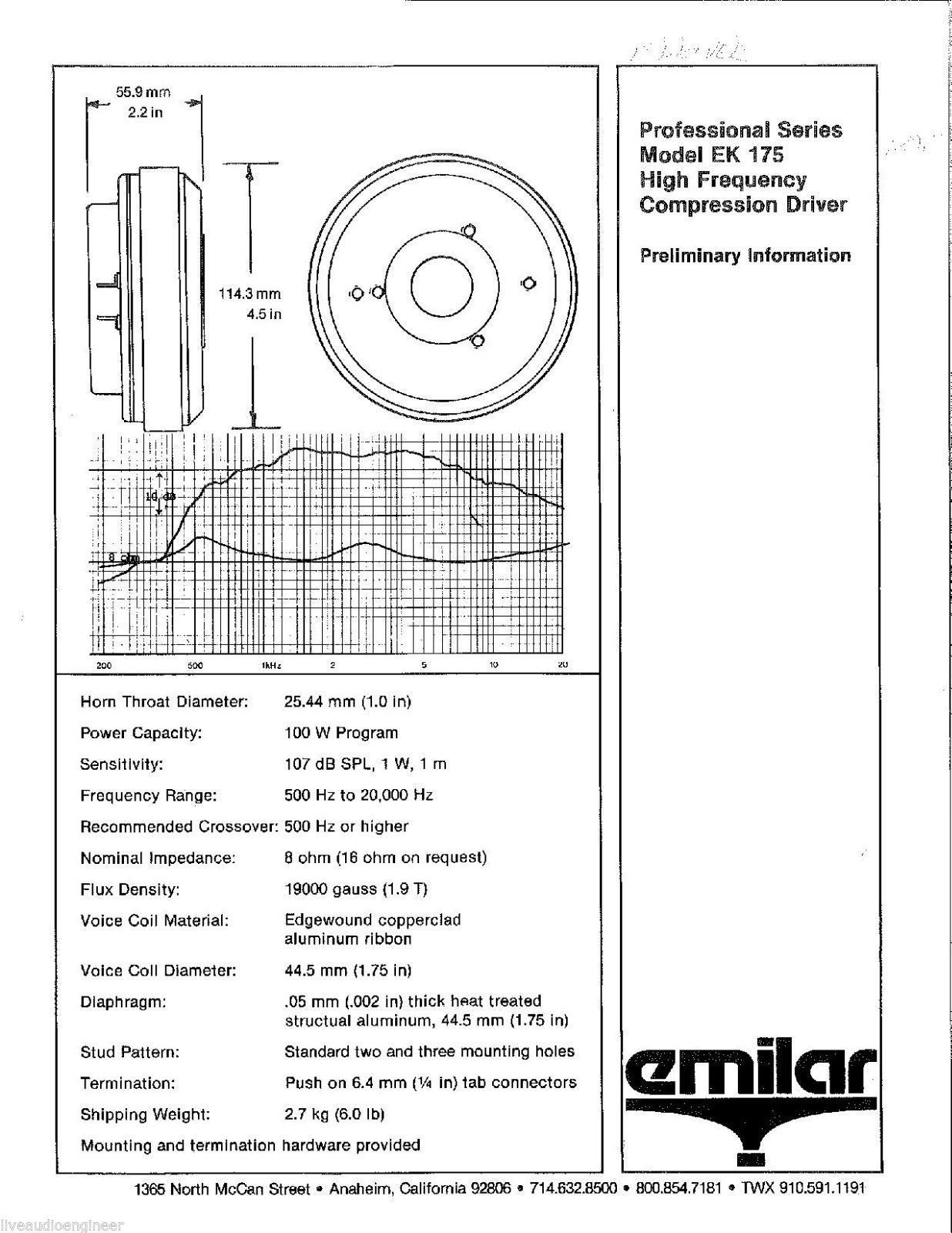

I managed to round it out with a data sheet on the EK-175 from ebay: Emilar - Model EK 175 High Frequency Compression Driver - DATA SHEET | eBay. Attached the image here in case it goes down. Looks like maybe it extends a bit higher yet.

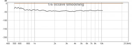

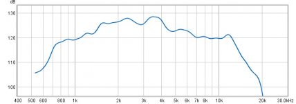

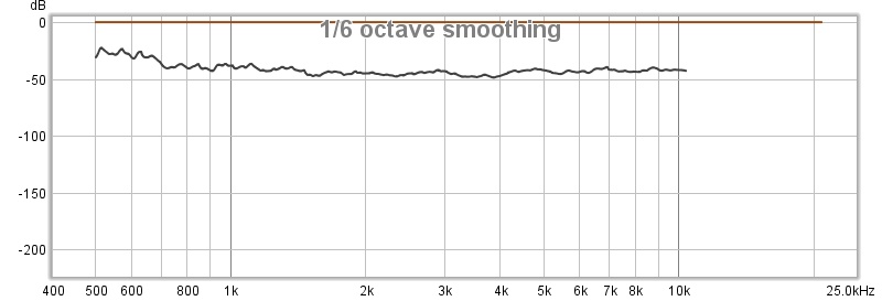

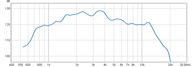

I took some raw measurements of an EC175 today. Here's the response and distortion plots from REW. These are currently mounted on Renkus CBH-500 horns ftp://ftp.renkus-heinz.com/Legacy_Products/Datasheets_and_Drawings/Aluminum_Horns/CBH500_data.pdf

*** Edit: BTW, the REW measurements are about 5-10 degrees off-axis BTW. I point them behind my head. Also I have a Renkus 1" to 2" adapter on the horns since the CBH500 is a 2" entrance. ***

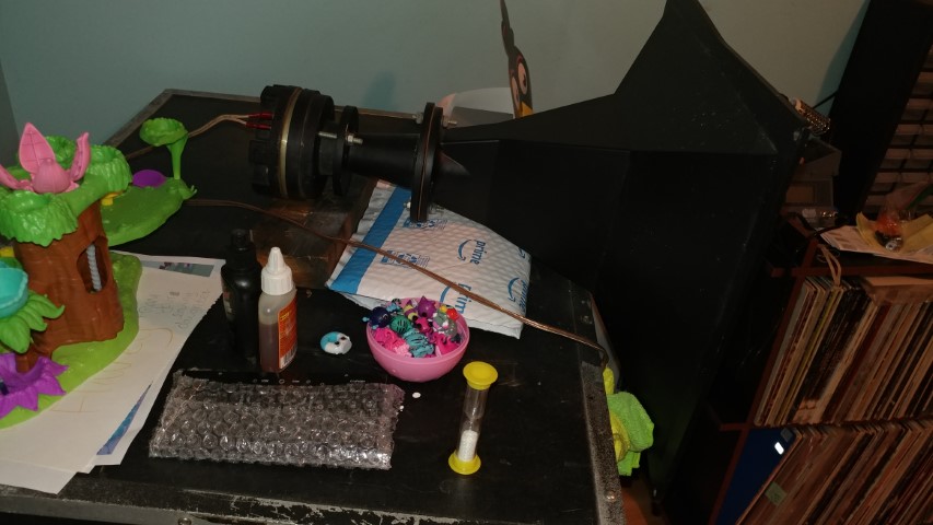

Here's some photos too.
Late reply, but thanks for the info jdarg. The response graph is super helpful.
