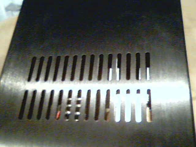

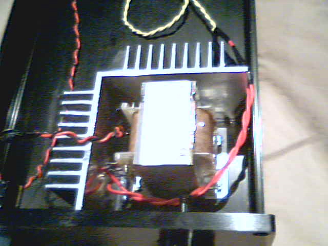

I have used the following aluminium heatsink around my transformer (which is housed in a corner with two of these heatsinks) to try and prevent RFI/EMI leaking to my circuit.
Aluminum Heatsink Cooling for LED Power Memory Chip IC Transistor various length | eBay
The Mains is 50-60Hz 230A UK power supply powering a 36VA EI core transformer. There are 3mm gaps above the heatsinks, but about 1/4 of the transformer is under a chassis vent.
I have read conflicting reports with regards to EMI/RFI, so my question are these.
1) Is the heatsink listed above along with the chassis vent (over a quarter of the transformer) enough of a shield.
2) And can the EMI/RFI escape through the chassis vents?
3) Is there any point in covering the transformer with aluminium foil, if so is there a specific way of doing so?
Have enclosed some pics.
My understanding is that aluminium can protect against RFI but you need something magnetic against EMI, but as I have said I have read conflicting stuff.

The short answer is yes. RF can easily get into your chassis. I live in a normal neighborhood. When I log onto my home network, I see 7 other networks with various signal strengths. I presume from neighbor's setups. Throw in radio, television, cell, wireless phones and camera systems and you can see most of us are heavily bombarded by a array of airborne signals.
emi passes straight through a gap.
An extreme example is your phone and transistor radio or any other "receiver".
The emi bends around obstacles to become the listenable signal.
Even when sitting inside your car chassis the "radio/phone" still works.
When the gap is less than 1/10th of the wavelength, then there is some screening effect. That's why the holes in the door screen of your microwave cooker are so small.
The 3mm holes start to have a screening effect for 3cm wavelengths (and longer) and microwaves are around 10cm wavelength.
Why use expensive heatsink extrusion when a simple piece of aluminium sheet would have the same effect? Exactly what are you trying to achieve? Stop hum/noise and other low frequency interference? Stop RF?
Aluminium won't stop hum caused by magnetic coupling. For that you need either a belly band or thick ferromagnetic screening - neither are usually necessary except in critical situations like test equipment. Aluminium will stop hum from electric field coupling, but that is not usually a problem with transformers.
Aluminium will stop RF, provided that there are no gaps. Transformers don't usually radiate RF, but they may conduct it. To stop conducted RF you need filters, not screening.
I think you need to understand your problem before you seek a solution.
