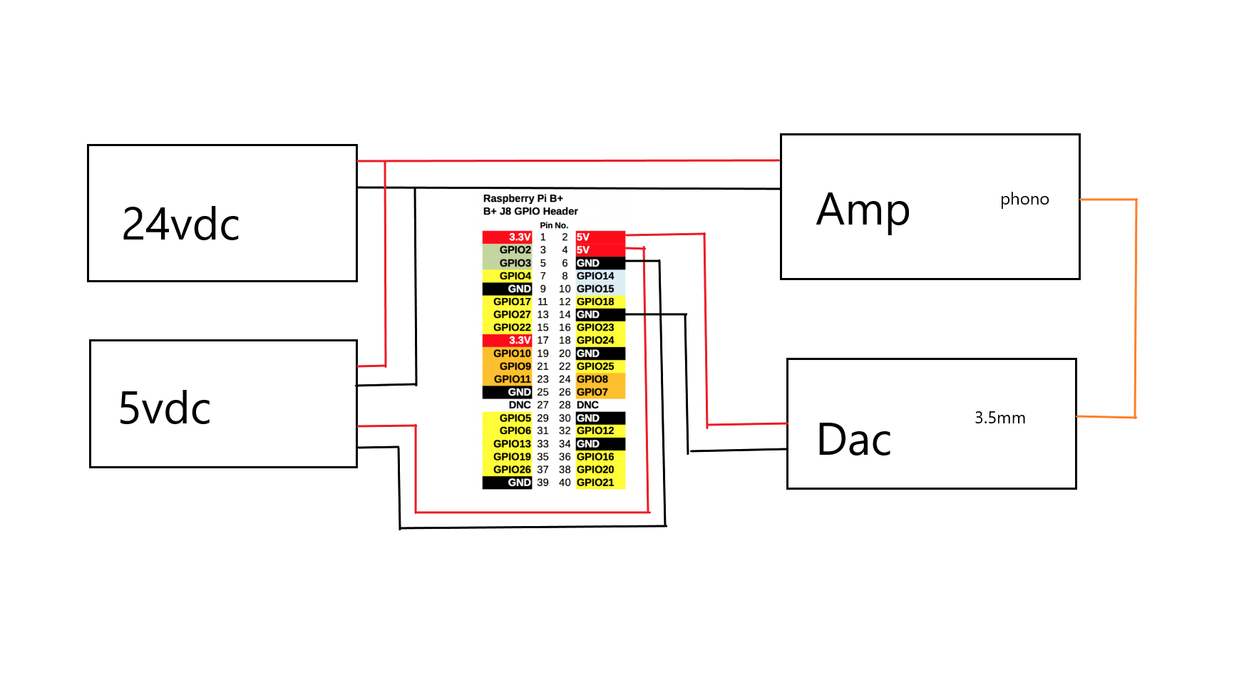

I am trying to power from a 24v PSU with a 5v step down on GPIO and tried all sorts of EMI filters, Wide Input SHIM from Pimoroni. Its EMI in fact you can almost hear the SoC at work with a background noise that often sounds like an old analogue modem.
Is it because on the same 24v DC that powers a 100 watt amp it creates a ground loop as at whatever stage I add EMI filters to the DC supply I can not seem to get rid of noise that seems to be generated by the Pi unless I use a seperate PSU for amp and Pi. Which sort of negates my idea of a neat single 24v DC supply to a small enclosure for the Amp and a step down to power the Pi. Tried linear regs, a couple of different bucks and the Pimoroni psu shim with emi filters from input to the dac to pi power input and still noise.

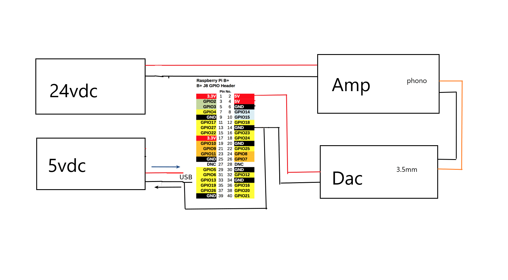

Take out the buck and with a standard Pi PSU powering the PI with the same 24vdc on the amp and all is lovely.
I am scratching my head really but thinking maybe the GND in the audio out of the DAC is creating a possible ground loop that maybe with the 2x PSU isolation doesn't exist. Anyone got any ideas?

Best sketch out your wiring schematic so we can analyze where the problem is. Or you could just try adding isolation to bypass the likely problem - try a trafo on your amp input for example to isolate it from GND.
Powering a computer and an amp from the same PSU does often create a ground loop. If your amp has balanced inputs (often the amp does, but only unbalanced input is formed on the input terminals), you can use fake balanced output which worked perfectly in my case https://www.diyaudio.com/community/threads/adding-an-amp-into-thin-client-pc.320812/

I have a 3.5mm jack to phono with on the phono side just a single jack to the wondom board that yeah its just a TPA3116 but those Wondom boards are pretty nice for $
Wiring is default Vcc/Gnd & the 3x I2S wires from pi to dac, 3.5mm to single phono on the anp.
24vdc SMPS powering the amp that feeds a 5v buck that give 5v/Gnd to the gpio via dupont jumpers that just use the nearest alternative 5v/gnd pi gpio pins for power to the dac.
The difference in noise of the setup from using a Pi PSU & 24dc to 24dc with a 5v step down is absolutely drastic and its if it suddenly picks up all EMI from the PI as if hearing it at work and the power on crackle becomes a cacophony whilst back to a Pi USB PSU its just that initial cap charge that gives any noticeable noise.
Single ended not differential and nothing special about the wiring its just how you would expect with the gear listed.

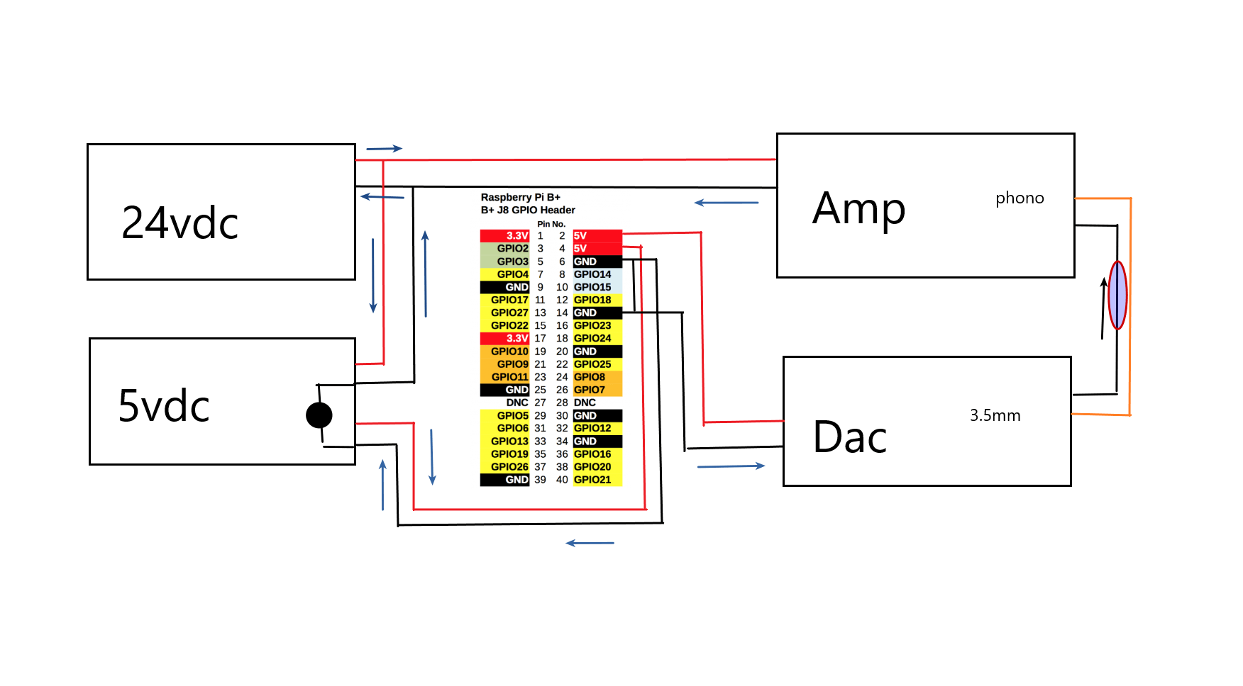

IMO it's not about the PSU, but about wiring the ground leads for RPi and your amp. Just make a drawing depicting the large currents which flow on RPi and to your PSU. The wire and RPi traces have non-zero resistance which results in the ground currents flowing also through your RPi -> DAC -> amp 0V line. Since this line also has non-zero resistance, the extra noise current creates a noise voltage which adds up to your DAC output signal voltage. You can also play with small resistors in your RPi -> DAC and/or DAC->amp ground wires, to reduce the extra currents flowing through the ground loop. But the higher resistance generates higher noise voltage, so you results will vary.

Also draw a picture where it works OK and compare the ground connections (note your step-down 24/5V DC/DC has the IN/OUT GND terminal connected internally).
Also do not forget to draw the ground analog line connection between the dac and amp - ground-loop currents through the ground return line of that connection cause the noise you hear.
Lols you don't know how painful that was but its exactly the same circuit with the 5v buck gone replaced by USB PSU and that works great.
So the 24v input and 5v output to gpio is gone as 5v is by a usb wall charger and that confuses me the most as you would maybe think the ground loop would still exist.

I guess both supplies are isolated via the transformers?

You cannot remove the gnd between dac& as every signal transfer takes two wires. If you cut the GND wire in your 3.5mm connection, for the first case the signal return wire will go around through the 24/5V DC/DC and you will have all the RPi return current part of your signal. For the second case no signal will be transfered to the amp as there will be no return path for the signal current.
Yes you can as its common elsewhere as hence it has a loop, I know this because I took the gnd away from the dac and it still worked as the gnd in the 3.5mm to phono is likely common.
The 24vdc gnd & 5v buck gnd I guess are common Amp is connected to 24vdc & Pi to 5v buck and prob why I am getting a horrendous gnd loop of noise.

So you still have the GND connected through your 3.5 cable (the shield of the two coaxes) and the ground loop noise currents flow through that, adding noise to your signal. You have not removed the DAC - amp gnd connection if you did not cut the shield in the signal cable.Yes you can as its common elsewhere as hence it has a loop, I know this because I took the gnd away from the dac and it still worked as the gnd in the 3.5mm to phono is likely common.
You can put a transformer in there instead or use balanced connection, to make the signal path avoid the wire with the ground loop currents.
