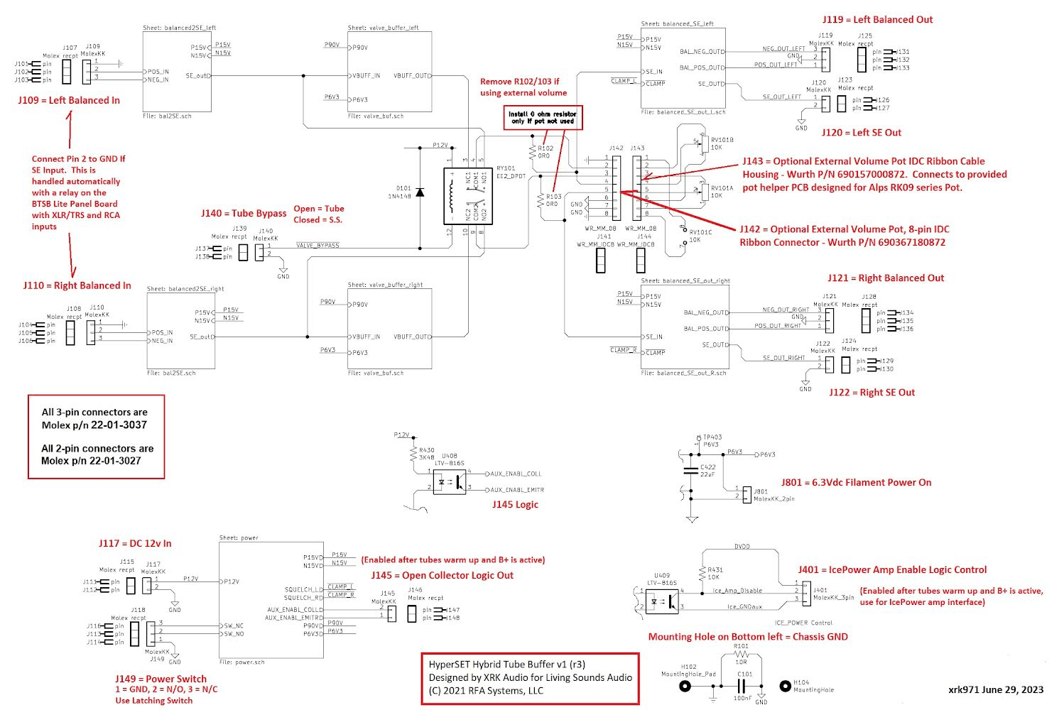

Hi. Anyone has matched the HyperSET to the ICE1200 power module like in the Emerald amp? Can someone help me with the ICE module pins to select? I built mine but keep getting a rather loud noise at power on. It is like the HyperSET start mute delay is not long enough, so the tube have not enough time to stabilize, or I’m using the wrong start pins on the ICE interface. Any help appreciated.
Btw the ICE1200 sound by itself is rather flat, but open up quite nicely with the tube buffer engaged, it will be a very nice amp once I can make it work.

Please refer to the HyperSET thread. I think several people have managed to connect the HyperSET and 1200AS2 to get behavior operating nicely like EP600 amp.
https://www.diyaudio.com/community/threads/btsb-with-tube-buffer-hyperset-gb.396848/
This connection diagram gives you everything you need.
I think Plott connected it and it works well. He gave connection tips in the thread as well.
Tell me the problem behavior you are getting. Is it a substantial pop when it comes on? The main thing you need to have is that the HyperSET needs to have power well before the 1200AS2 - this is done with 12vdc going to HyperSET as “always on”. The power switch logic doesn’t turn on tube filament or HV plates until enable is pressed. The opamps on HypeSET need to be always on (controlled via main rocker switch on IEC). The other enable functions are soft logic from front panel switch.
