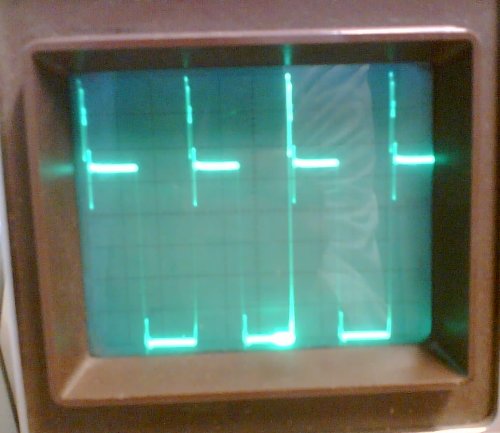

The waveform on the drain of the MOSFET, supply loaded with about 50W:
Setting of the scope: 10V/div Y axis, 2usec/div X-axis.

The "Y" common-mode shunting capacitor is missing on that schematic, that may increase common-mode EMI by an order of magnitude. It should be placed very close to the transformer to avoid resonance.
The switching waveform shows abnormal turn-on (that small peak shouldn't be here) and a lot of leakage inductance at turn off. Check Vgs and Vds waveforms together in dual trace mode, make a picture at less us/div in order to see more clearly what happens during switching transients. How did you wind that transformer?
Also note that the clamping circuit across the primary winding is very prone to ringing and must be placed near the transformer. Same applies to secondary side diodes and capacitors.
I will do that.
I agree that the clamping circuit is at the wrong place. Besides that it is going to be hard to make the current loops much smaller. wihout sacrifying cooling of the diodes.
BTW: I also tried putting a small snubber over the Schottky in the clamp; it did not make any difference.
