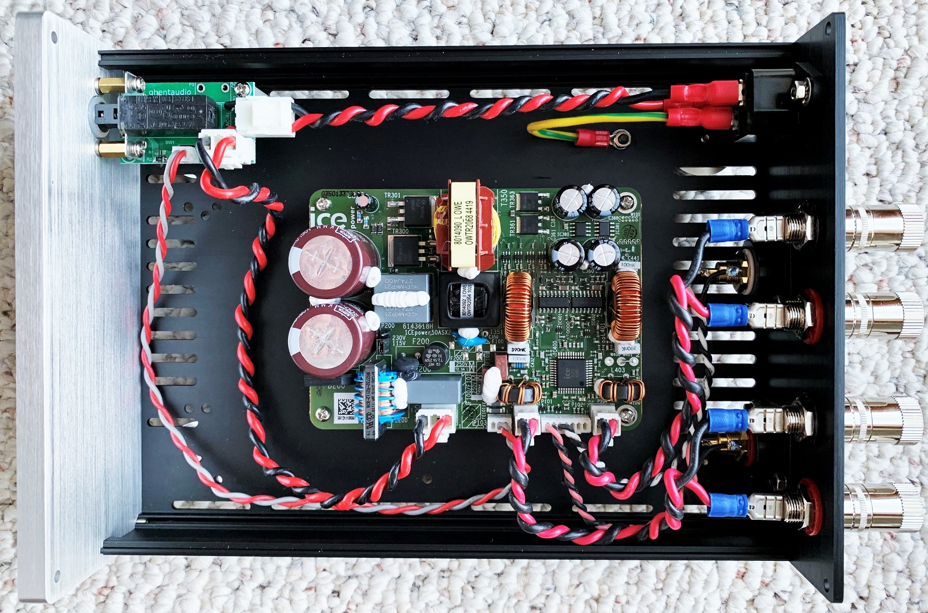

If it helps you, here is a picture of an ICEpower 50ASX2SE I salvaged and built in a casing. I don't like hot semis so I glued some leftover heatsinks with thermal glue to the hottest parts. As it was previously mounted upside down the results of heat buildup can be seen when looking at the upper right filter cap. I don't use it but the tests showed (unexpectedly) very good sonical results.

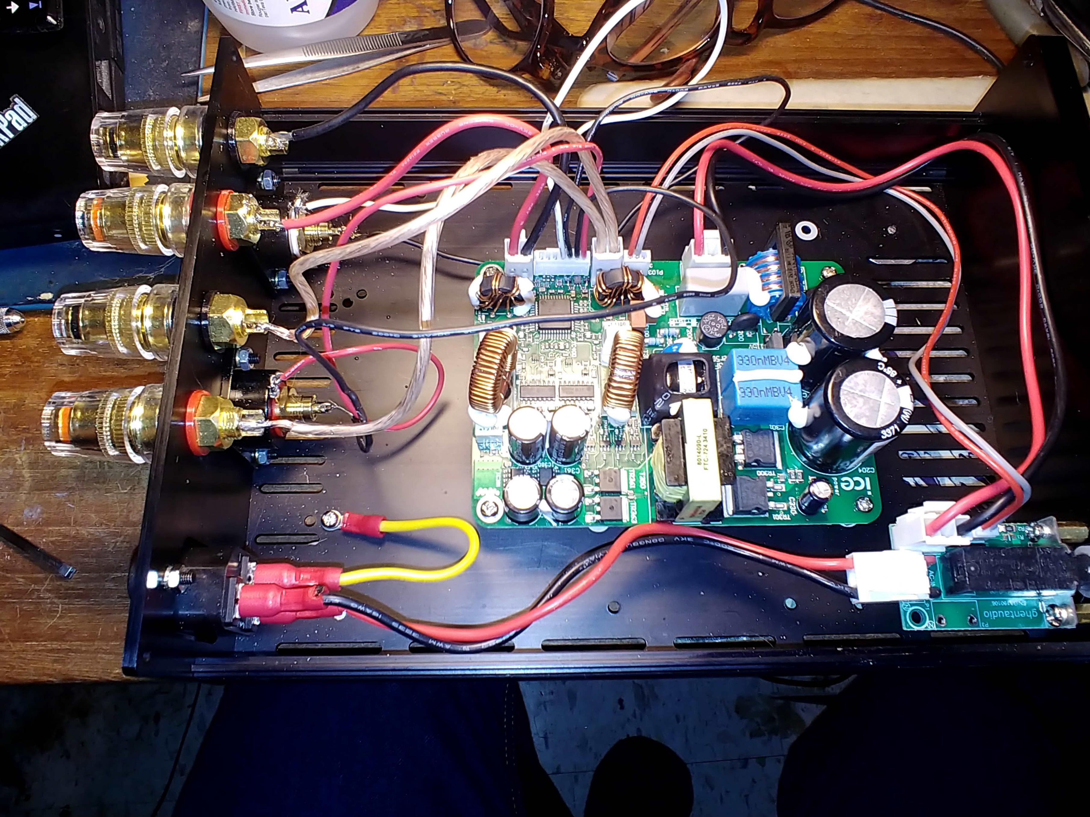

Here's a photo. Guess I'm more of an aspiring, would-be neophyte hopeful.
This detail about pulling and reinserting a clip is completely new to me! It would certainly explain the lack of crackling, of unwelcome hums, or of any hint of warmth anywhere in the module - never mind burning smells. I'm keen to give it a try!!!

I found the jumper! All will now be well. I have to wait till a civilised hour to connect the amp, but I'm quietly confident.

Sharp eyes! Also way too long input wires. Please don't make them too short either, 30 mm lack is OK and you can turn them in a loop if you wish. Route the input wires away from the mains side of things AND the speaker wires! I suggest keeping the input wiring to the bottom of the casing and a bit to the edge.
The speaker wires should be resoldered to the connectors (and they're both different cables BTW). You will have to remove the connectors as when your are soldering them mounted in the casing the plastic parts will melt. The speaker wires can be loosely tied together with a tie wrap. Make sure you move nut and isolation ring over the cables first 🙂
It won't hurt to check/measure if the PE wire really makes contact via the ring to chassis. There should be a "toothed" washer between ring and casing.
If redesign of a home depends on an amplifier I have done something wrong till now 🙂 Ha yes, you do realize this is an amplifier without volume control i.e. a power amplifier? Connecting a source directly will make a lasting impression and 2 speakers with damage.
@miv71: I noticed you have the bottom of the case rotated 180 degrees from what was the design intent. Ghent has made things simple for DIYers by masking the anodizing for key ground points at the AC ground connection and at the PC board connection (near P104) to assure proper grounding. Make sure you scrape away the anodizing at your AC ground connection for safety. Also make sure you use a brass spacer at the PC board mounting screw near P104 and scape the anodizing to assure a proper ground. (The three other spacers can be nylon since these mounting holes do not provide a ground connection.) Alternately, you can simply rotate the board 180 degrees. This will also provide a mounting point for attaching the provided 20mm nylon spacer from the bottom of the case to the switch assembly for added mechanical integrity.

Fixed! It was the jumper, which I'd not even known existed as a thing until Tuberoller suggested I check it.
