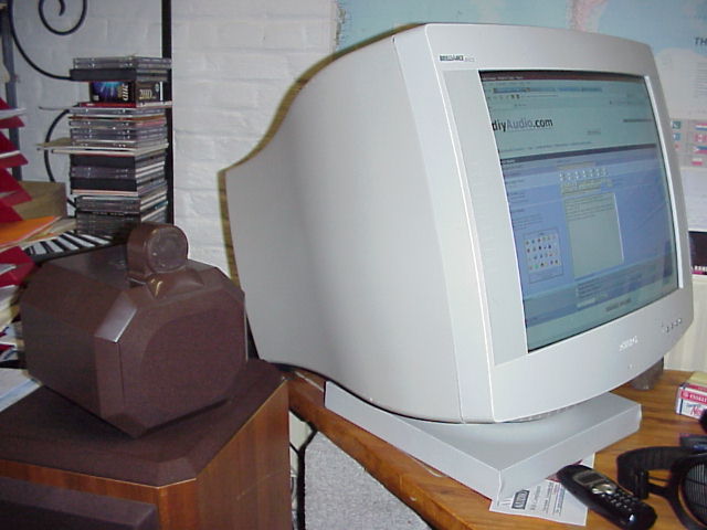

There is degaussing and auto-degaussing.
TV's need to be switched off for the degaussing circuit to work. (PTC)
An example of auto-degaussing is the Philips Brilliance 201CS monitor. A clever circuit detects changes in close proximity magnetic fields.
When I rotate the mid and tweeter part of my speakers, the effect on the colors is immediately corrected by the auto degauss system.
/Hugo
