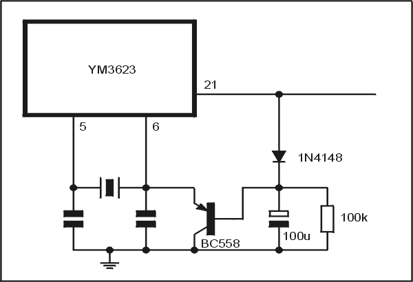

Re: Let's kill the clock!

My motto:Jocko Homo said:Too many parts, Lars.
Have you been taking lessons from P-A? [joke]
Anyway.......yes....it sounds better if you disable it after lock-up.

Hey, Lars...........
If it makes you feel better.........
The first circuit that I used to do this had so many parts that even P-A would have been impressed!!!!
Long story........but because I was lazy that day, I grabbed a little PCB that I had tons of.
555 timer.......relay.......transistor to control the timing cap on the 555.
IOW, overkill. But since I had tons of them............
Didn't take me long to figure out that overkill was not justified. Sorry, P-A.
Jocko

... he, he. Jocko thinks that I'm the worst, I have seen even more overkill.
Anyone who have seen the power amp from www.alaskanaudio.com ? The web site is down (been so for long time now) but I have the pdf of the monster I have big trouble to understand. If Jocko should see this he would not be a guinea pig for medical research but for psyciatrical!
