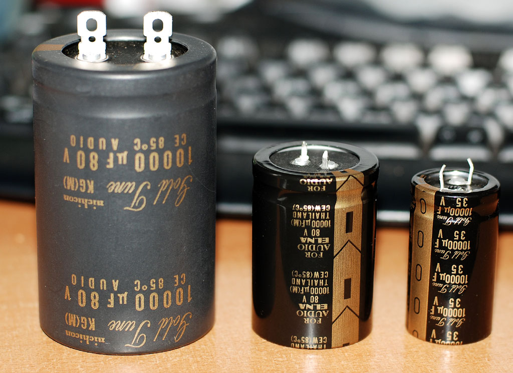

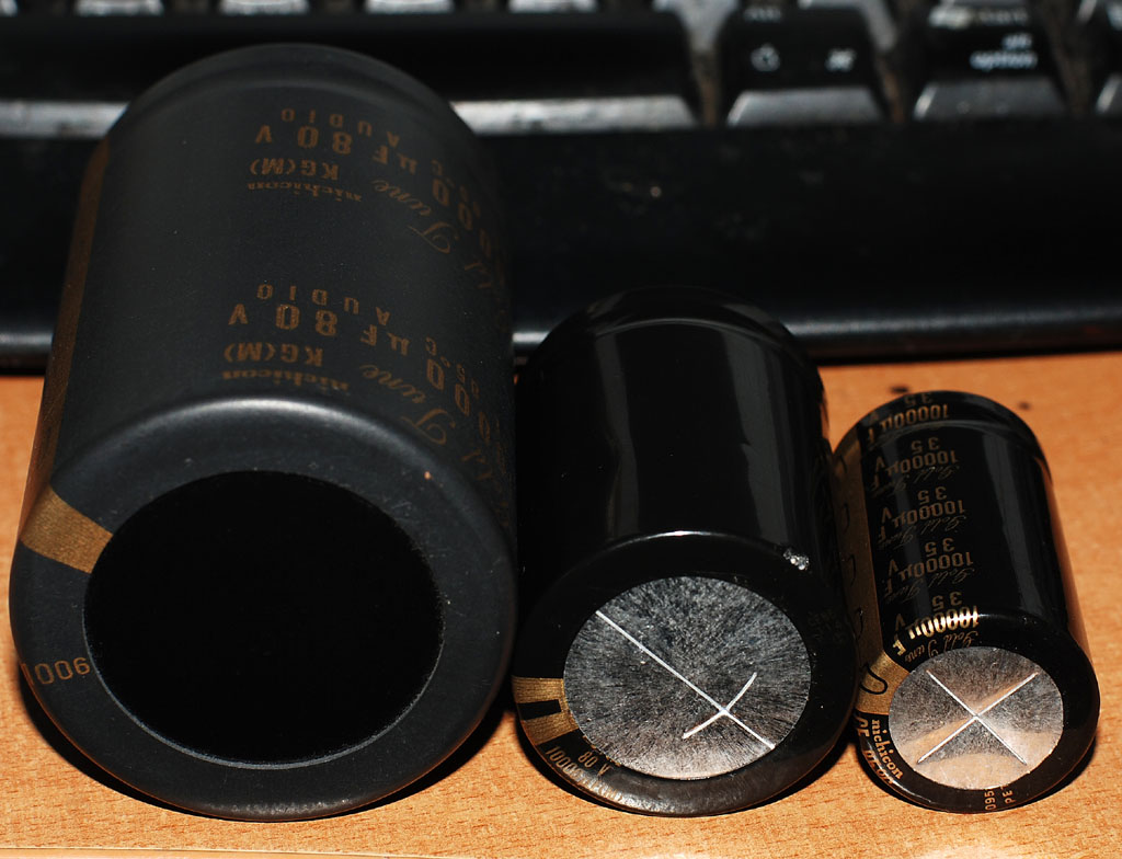

Hi Pocoyo, the cap arrived today 🙂 The only test I have done as yet is the esr test and it was the same as the two other Nichicon 10,000uF caps I have. basically a zero reading. Tonight though both the 35V nichicon and the Cap you have sent me, fluctuated between a reading of 0.00 and 0.01. so the esr may be somewhere between 0.005 and 0.01. If I get a chance I may take my meter into a local electronics store and try measuring the esr of a generic brand 10,000 uF cap for comparison 🙂
The other "test" that I did was to measure the weight of the cap. it is 68g The 35V nichicon KG weighs 26g The 80V nichicon KG weighs more than 100g (my scale only goes to 100g).
Pictures attached.
1st The Elna for audio cap is in the middle between the 80V nichicon KG and the 35V nichicon KG, as you can see there is a big difference in the size, but the 80V nichicon is a big cap!

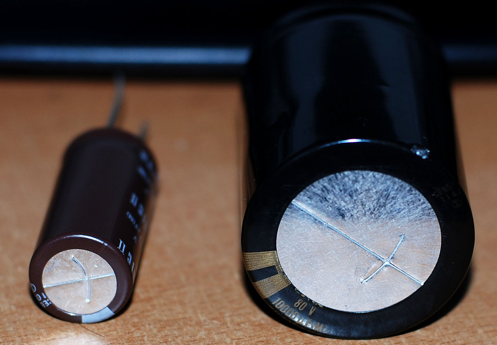

2nd pic is a comparison of the ends of an elna silmic II and the cap under test. You can see two small dents in the cap, I assume these occurred during shipping. The creases in the end cap do not look 100% even on the cap under test, the grooves look like they have been scored rather than punched maybe. I'm not sure if that is significant or not.
Anyway It is getting a bit late so I think I will leave the capacitance test until tomorrow.
Tony.

OK I've just done the capacitance test. Charge time was 97 seconds, which equates to a capacitance of 9700uF, which is well within typical +- 20% for electrolytics. in fact that is -3% which is very good.
So despite its relatively small physical size this cap is definitely a 10,000uF cap. So there is nothing wrong with that spec.
The dimensions of the cap are 35mm diameter and 50mm high (body height not counting the leads). This cornel Dublier datasheet has 10,000uF 80V caps with dimensions of 35 D X 45 mm H so there is nothing magical about it's dimensions (ie a cap of this physical size can have this capacitance and voltage rating).
I'm not too keen to try and rig up a high voltage supply to test it in smoothing duties at close to it's rated voltage. I only have a dual winding 45V AC transformer which would give around 63V rectified.
So my conclusion at this stage is.
The cap certainly meets the capacitance specification. It is low ESR, so it should be good for power supply duty.
I can't say one way or another whether it meets its voltage specification, but it is certainly physically possible that it will.
The end cap has a vent which looks like an Elna vent. This sample looks a little less than perfect but that could be a manufacturing glitch.
I can't say for certain it is, or it isn't a genuine Elna Cap. But it does appear to be good quality.
If anyone would like to suggest any other tests that I could do please speak up 🙂 I'm a bit time pressed at the moment but I will see what I can do.
Tony.
