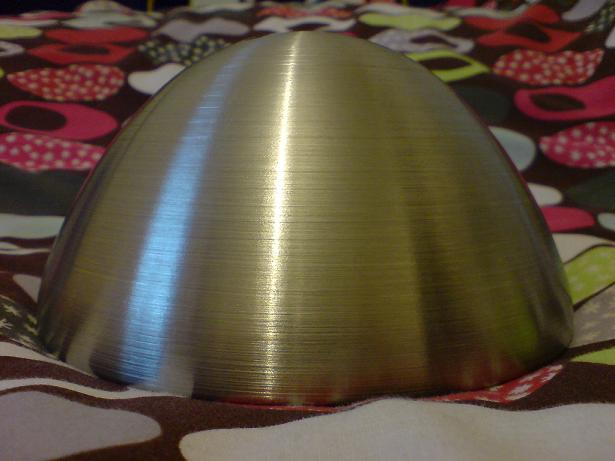

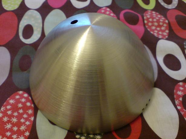

Now the thing I will use as the reflector is the metal cover of a Torino electric egg boiler, it’s made or stainless steel and looks like a perfect half of an ellipse. Now I know no matter how much you polish steel you’ll never get more than say 65% reflectivity so for that reason I will do the following:
  1. Electroplate copper onto the inside of the egg cover (a tedious and complicated process)
  2. Use Tollen’s reagent in order to precipitate a thin layer of pure silver onto the copper
Result: a 95% reflective elliptical reflector
So this is my plan to come up with a reasonably affordable elliptical reflector, if you have any pointers and tips please let me know

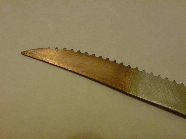

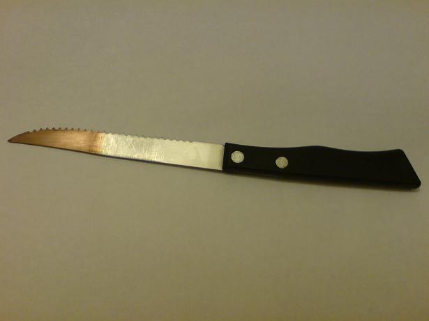

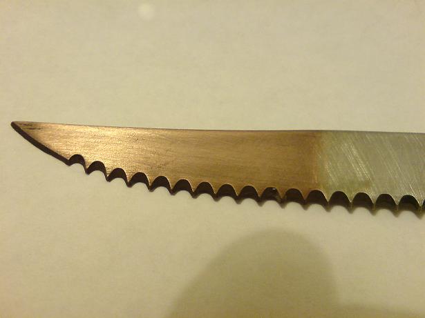

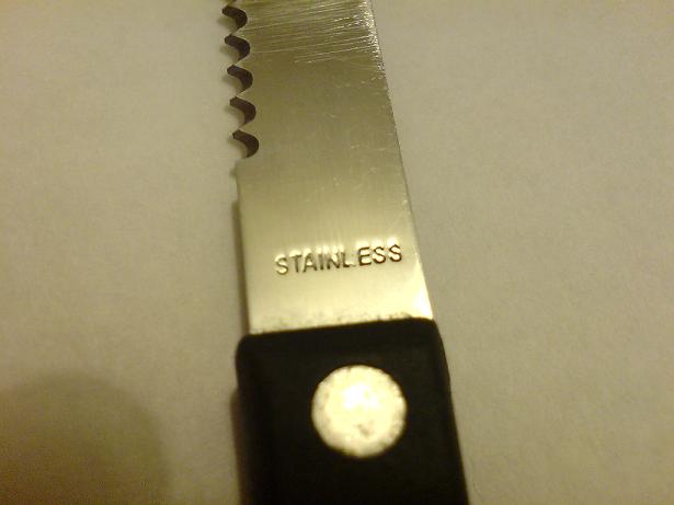

OK so now some of my experiences trying to copperplate steel:
I had a stainless steel knife and decided to copper electroplate it. I tried salt, vinegar, baking powder as the electrolyte and copper as the cathode at different voltages and currents. Nothing worked; the copper would not stick to the steel at all. I checked a local plating shop and they asked for 40 pounds to plate it.

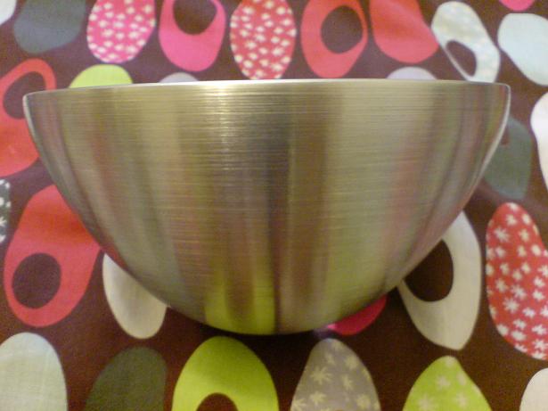

After hours and hours of searching books and the Internet I realized that to electroplate copper onto steel is a very complicated process and cannot be done directly, instead a nickel strike is used on the steel first, made from nickel chloride and HCl. One particular post on the internet stuck in my mind cuz it said you can activate/prepare steel for plating by using HCl alone. Having some more free time since it’s Easter holiday, I remembered I once saw on a bottle of Harpic toilet cleaner that it contains HCl, so it does 5.6%. I then set the knife inside some Harpic for 5 min and rinsed with water and quickly placed it in a plating solution made of vinegar only, and copper as the cathode and the knife the anode, after around 5 min in the solution I see copper starting to deposit to the knife, to my amazement the copper did not scrape of even when I used my nails, success. But after a while in the solution everything started to turn black. I then mixed around 4 parts vinegar to 1 part Harpic as the electrolyte and I started the bath again. This time everything fizzled and even more copper was deposited on the knife. I took it out and voila a good layer of copper that cannot be scratched off easily.
Through trial and error I found out the best way to copperplate my bowl would be to make a solution of vinegar and add some toilet cleaner until the solution turns blue. The cathode should be made of pure copper and the bowl as the anode.
I will be trying this maybe today and see if I can get a good layer of copper

But I managed to polish the inside of the reflector using 120, 280 and then 400 grit sandpaper and the surface looks shiny, but not shiny enough that I can’t run a test. So I ordered 2 sheets of 1200 and 2000 grit sandpaper and now I’m just waiting for them.
What I’ll do is I’ll polish the steel as good as I can up to 2000 grit and then use metal polish to get a realy smooth and reflective surface. I have my bulb already and when I receive the ballast in a couple of days, I’ll try the setup as it is to see if the light produced is uniform and to see at what distance it will cover the 15.4” screen.

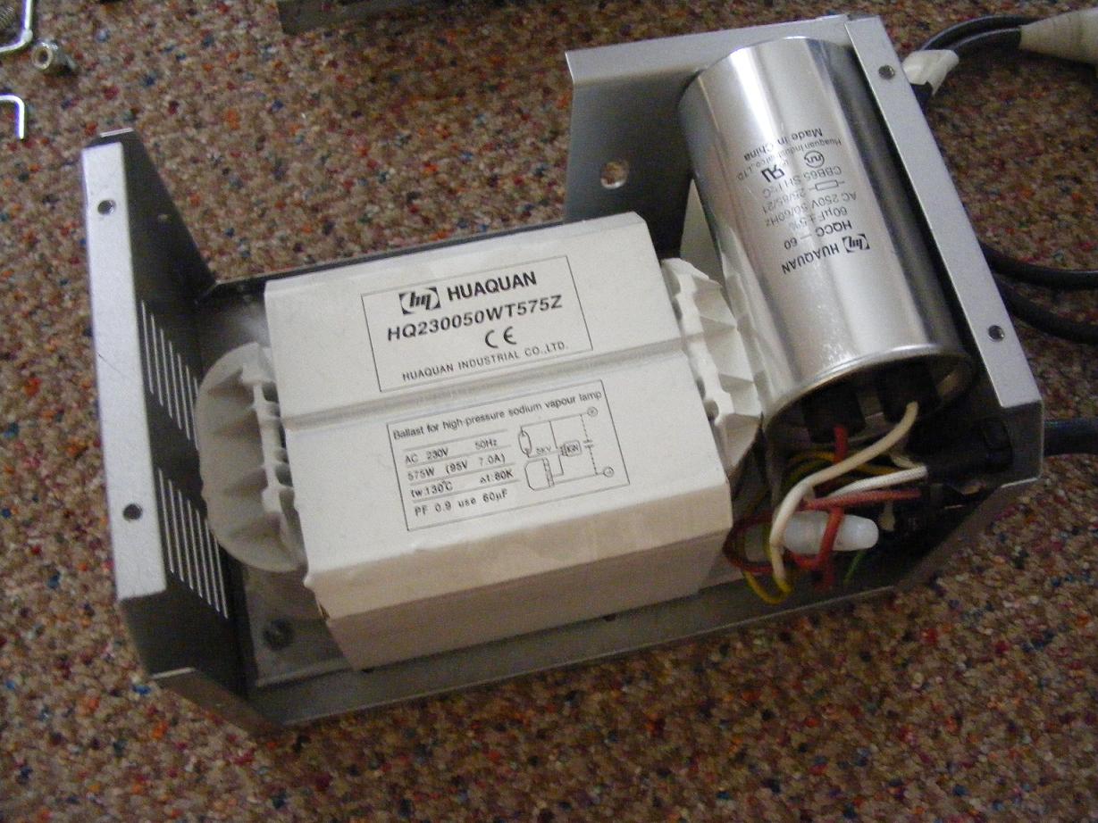

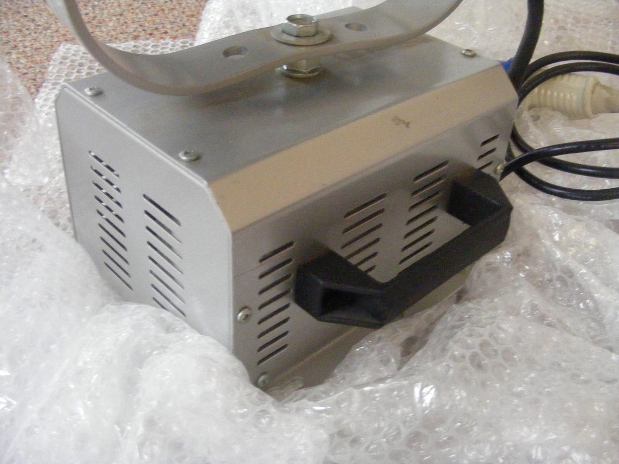

My ballast came and I also polished the reflector with 1000grit sandpaper so all I need to do is make a hole in the reflector where the lamp should be and I'll be ready for a proper test.

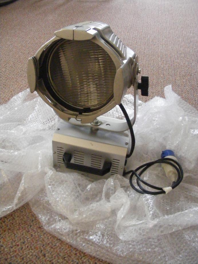

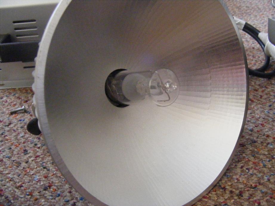

Some pictures of the ballast
It came form a light fixture, just look at that reflector that came with it 😱 too bad I can't use it, it's parabolic
I will probably get it running on Thursday and I'll post pictures 🙂
