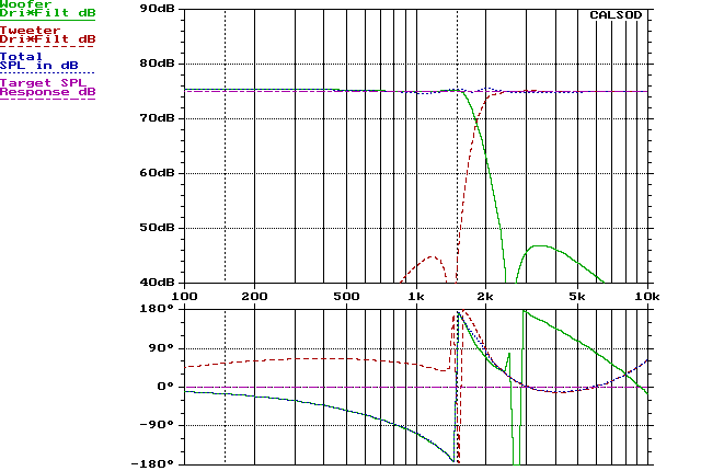

The depth of the maximum "bounceback" (as you call it) in the stopband is actually an adjustable parameter of an elliptic filter. There is a tradeoff between order, depth of bounceback, and the frequency response interval between where the response leaves the passband and where the first notch is located (the transition region). For a given order you can reduce the level of the the highest bounceback depth but to do that you must make the transition region wider.
Here is a plot that illustrates these regions in the filter response:
You can tell this is an even order elliptic filter because the tops of all the "bouncebacks" are at the same level. This is a characteristic of all even order elliptic filters with stopband notches (e.g. elliptic and Chebyshev type II). If this was an odd order elliptic filter, the tops of the bouncebacks would trend downwards at 6dB/oct due to the additional first order stage required to achieve the odd order.
Yes, I am aware of that, and its characteristics, as I'm obliged to work with them frequently. I even mentioned (well, alluded to if you want pedantry) the fact that it is adjustable when noting that attention must be paid to it when working with them.
