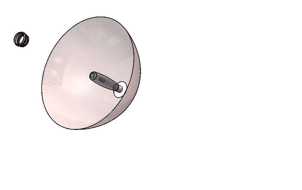

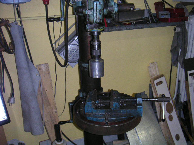

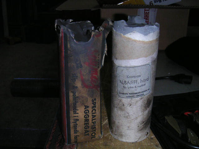

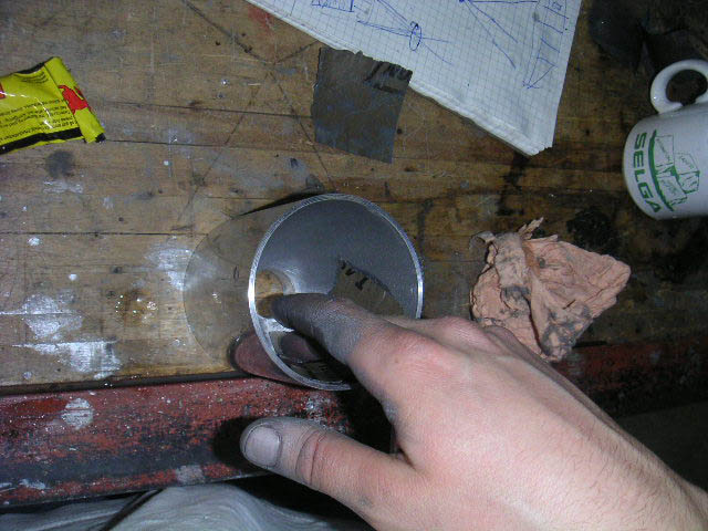

I started wet grinding it with 400 size but after a while did I realize that this would take too many hours and I were under time stress. I did this in my fathers thin metal workshop and I can tell you that I had to explain the principles of an ellipsoidial reflector at least 10 times! thereby the nice scetches on the paper

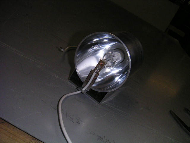

It was a shame that I did not have time to test the projector out when I was at home with the parents...and now am I stuck at the uni for another 2 months so I can't really build much until summer, but then fortunantly it will be ready! Here is another view of the reflector, if it works well is the next step to chrome the aluminium so it won't oxidize which it will do right now
R U using a double ended with that? Seems a shame to have the wire in front of the projected light.
Ever check out the G12 bulbs?
It's true that there is an wire, but because the light diverges to a focus doesn't it really matter that much. At least I think so. It's just a shame that I wasn't able to complete the projector in time... 🙁
I'll look into the G12 bulbs I think it'll be fairly easy to convert the lamp holders if i was interested in that!

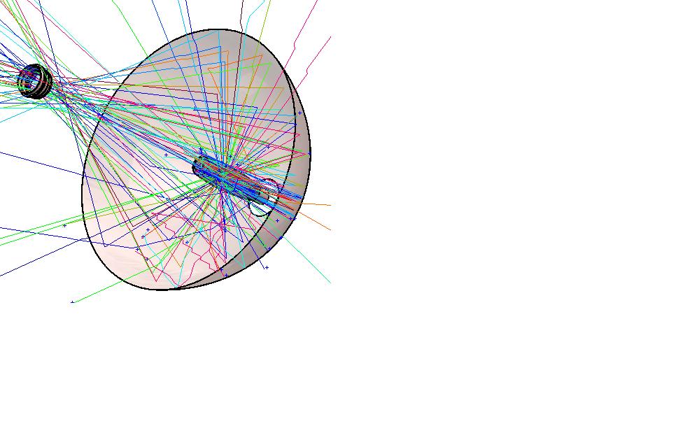

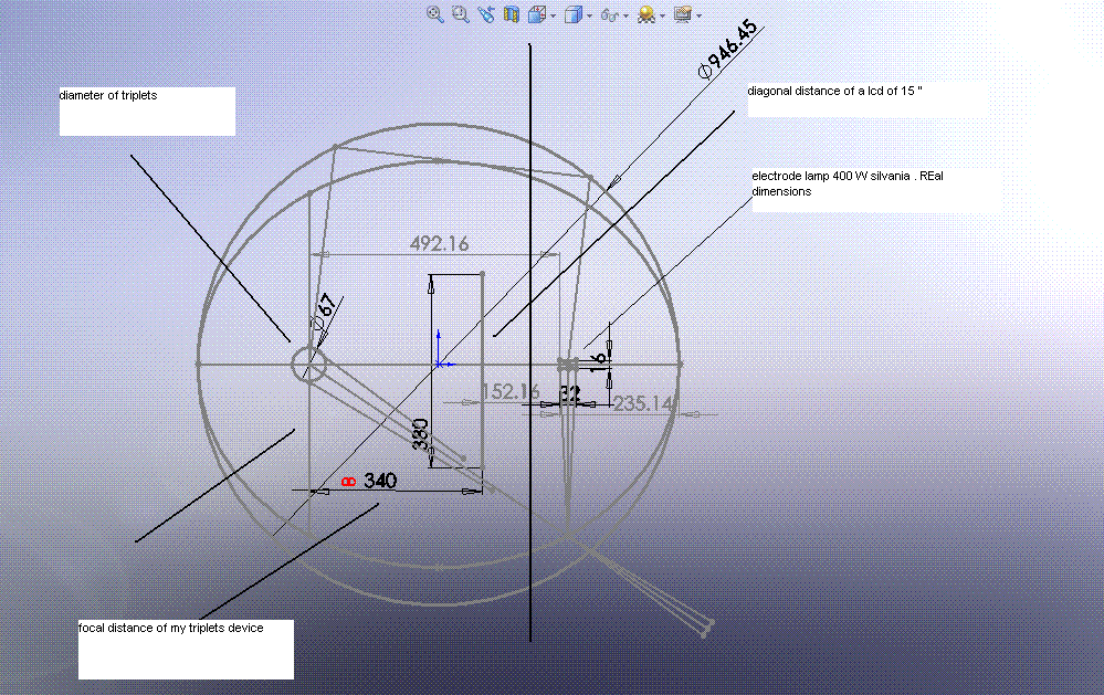

build a ellipsoidal projector using a printer !!
i thing that is possible do a correct geometry for a ellipsoidal from a cad soft .
next you create the geometry . print it and past over a plate. netx cut over the line .
this plate has de path correct.!!
next put to turn arroung a axis .
i have a not bad idea about how do it !

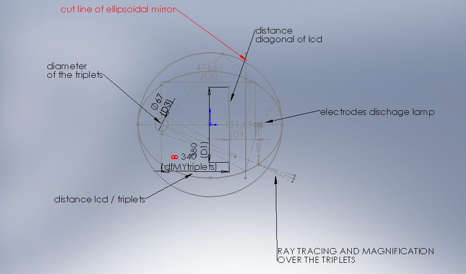

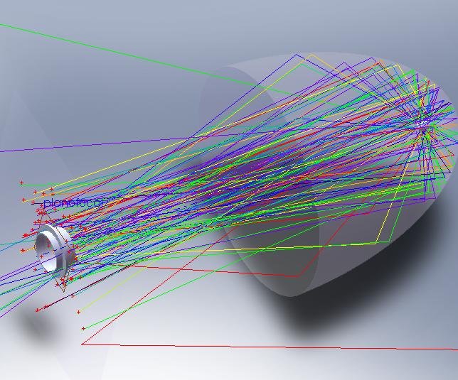

That will work if your LCD has a viewing angle large enough to pass most of the rays in the corners. Many LCDs do not have a very good response to rays passing through at angles very far from 90 degrees. If that is true for your LCD, you can still use an elliptical reflector and two fresnels. You use the reflector to focus all the light on a point between the lamp and the first fresnel. This point should be at the focal length of the first fresnel, so the rays on the other side of the fresnel are all parallel. Then they pass through the LCD pixels at a 90 degree angle, and enter the second fresnel. That fresnel refracts them to enter the triplet.
yes correct observation
yes very interesting obsevation .
my lcd has an wide angle obsevation. and i hope that works for my diy project.
if i in the correct will get more lumens output .
while shows more picture .

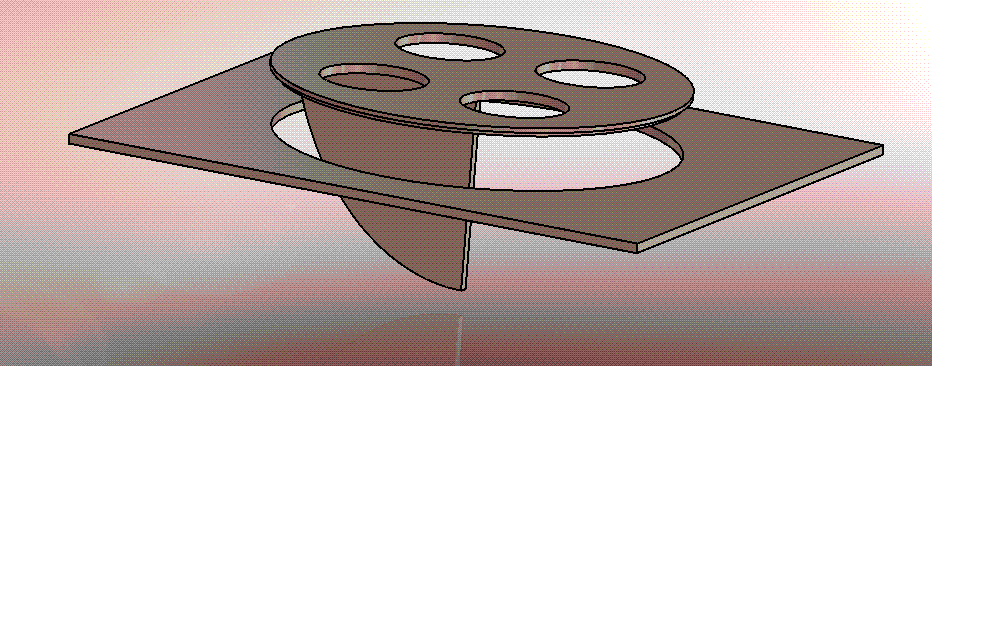

i draw the device that allow to create a ellipsoidal container recesed
made with a materal moldable .
next of solidification . i will paste over de internal surface a film
mirroring .

What kind of material will you use for molding the mirror shape? Fiberglass is very strong and lightweight, but then you will have to paste on mirror film.
If you can form the shape in metal, you might be able to polish it or have it silver plated. Aluminum can be 95% reflective and silver can be 98.5% reflective.
