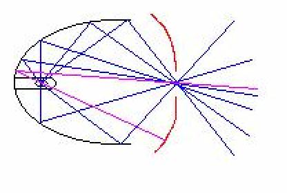

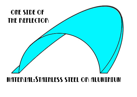

I'm thinking of building myself an ellipsodial reflector to my upcoming 7" project. It will use the familar ellipse (in cartesian coordinates x^2/a^2+y^2/b^2=1 where a,b is the half axles) that is rotated and then cut by two planes(perpendicular) to achive something like this image.
So it's basically a ellipsoidal reflector cut in half but with a shade around it so it can be assembled together with bolts or dot welded together. The idea is that this will be done in practice with the use of a english wheel
I'm not really sure if will be able to do it, and if it actually will be impossible to make to similar shapes. The material I was thinking of is either aluminum or polished stainless steel. I have seen some great results with this wheel that is used to make car chassie details. The question is if it's even worth the job, but then on the other side could it be fun to see how it would turn out. This is btw my first post, been reading some but i can't really find if there is any good MH lamp/ballast distributers in europe?

I'm playing with something similar but in 1/3s. This would avoid any dark line from the joint. It is easier for the eye to notice if is simetric - left/right or up/down. going at an angle through the lcd would be harder to spot.

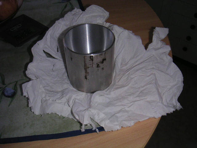

Is that you with the rolling press? Then you have access to a shop. You can also consider spinning one piece steel with spreading press wheels from inside. Must have supports outside so it wont buckle/deform.

Oh my no it's not me, just a pic from internet😉 I'm quite a bit younger than that 😎 To make it in one piece will probaly be very hard, i'm considering mayby to make it like you said out of more bits, but it depends on how hard it will be to make them look about the same!
I got access to a metal sheet workshop due to my father, the only problem is that i'm at uni now ---- 1300km from him but i'll be going home at easter so i hope it will be time to assemble my projector then, if i got all the parts that is. I'm thinking of building the chassie it of polished stainless steel, it will look just like it is chromed then, and put in some red LEDs for fan holes etc.

Even the very best stainless steel is only 65% reflective. Polished aluminum can get up over 90%. I think that dictates your choice of materials, unless you want to pay for silver plating the stainless!
I was thinking of trying this with at least four pieces. I would make a stamping mold, so I could make many identical pieces. Then just bolt them together.
BTW: You don't need to plot the equation to draw an ellipse. Just mark the two focal points on your template material. Put a little nail or pin at each point. Cut a piece of string or wire that is larger than two times the distance between the two focal points, and tie it in a loop. Put the loop of string over the pins, and then use it to guide a pencil as you draw the maximum-sized shape all the way around. That is a perfect ellipse. You can vary the width of the ellipse to match a condensor fresnel by making the loop longer or shorter.

Yes, aluminum or coated steel works. Not being a machinist i would find aluminum harder - requires more skill i think to keep an acurate shape with soft material. Steel is more resilient and puts up with my level of machining skill.
One note on the lip- I dont have a lip all the way around. When joined they leave a small gap (radius of bend) unless you weld and grind. Consider grinding the edge like a knife chamfer and overlap. The joint will be smaller i think.

I am now home and after some research did I give up the idea with building a good reflector out of segmented aluminum pieces. There is just too small angels and too hard to make it right. So this is what I did:
I went to my old gymnasium where i got a hold of a guy who can cnc mill it for me. I do not know the cost, but he seems like a nice guy😉 . It will be in massive aluminium, but i doubt it will be very heavy. The next step in the procedure is to polish it, and that will be done in a lathe. I'll be back after the easter with some more info!

Holy CRAP! Well, I guess it depends on how big of a reflector you're talking about here. But in any case, that looks like a LOT of metal to remove. You'll start with a huge solid chunk of aluminum, then cut away most of it....
It doesn't matter how nice the guy is, unless he's doing it for free, it'll be in the hundreds.
There is much quicker and more economical way of creating hollowed rotated volumes. It's called metal spinning. What you do is place a big circular sheet of aluminum on the lathe, then chuck smooth or wheeled tools in the holder and start pushing the disc into the shape you need. Just compare to a profile cut out of cardboard or plywood as you go. Then, without removing the reflector from the lathe, you can polish it as it spins.

Yes I am aware of that technique but It is unfortuantly not an option availible to me here, nor do I have the skills to do it. The aluminium will be cut out from an 80mm(~3.92") axle and it will be around 70-80mm long so it won't be extremly expensive I hope. The piece will weight around 1kg not worked and that maybe equals 30$, I hope😀 You can sell the aluminium that gets over to a decent price as well😎
Well, it shouldn't be too bad at that size. It depends on the alloy and treatment grade of the aluminum, too...some of that stuff can be difficult to chew through.
For that size of a reflector, casting could be a good option. Use the CNC mill to cut a form out of a wax cylinder, then use it for a lost-wax mold.
