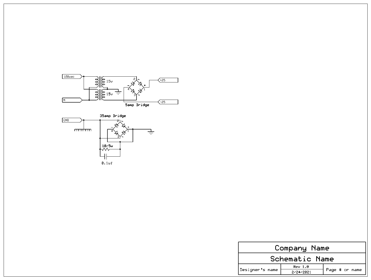

I finally finished Project 97 Hi-Fi Tone-Control Preamplifier. I ordered the board and it arrived within a couple weeks.
I wanted to incorporate a USB/SDcard music player and a SPDIF OR TOSLINK input with a couple Aux inputs.
The PreAmp needs +/-15 vdc, the Music player needs 12 vdc and the SPDIF converter and input selector needs 5 vdc.

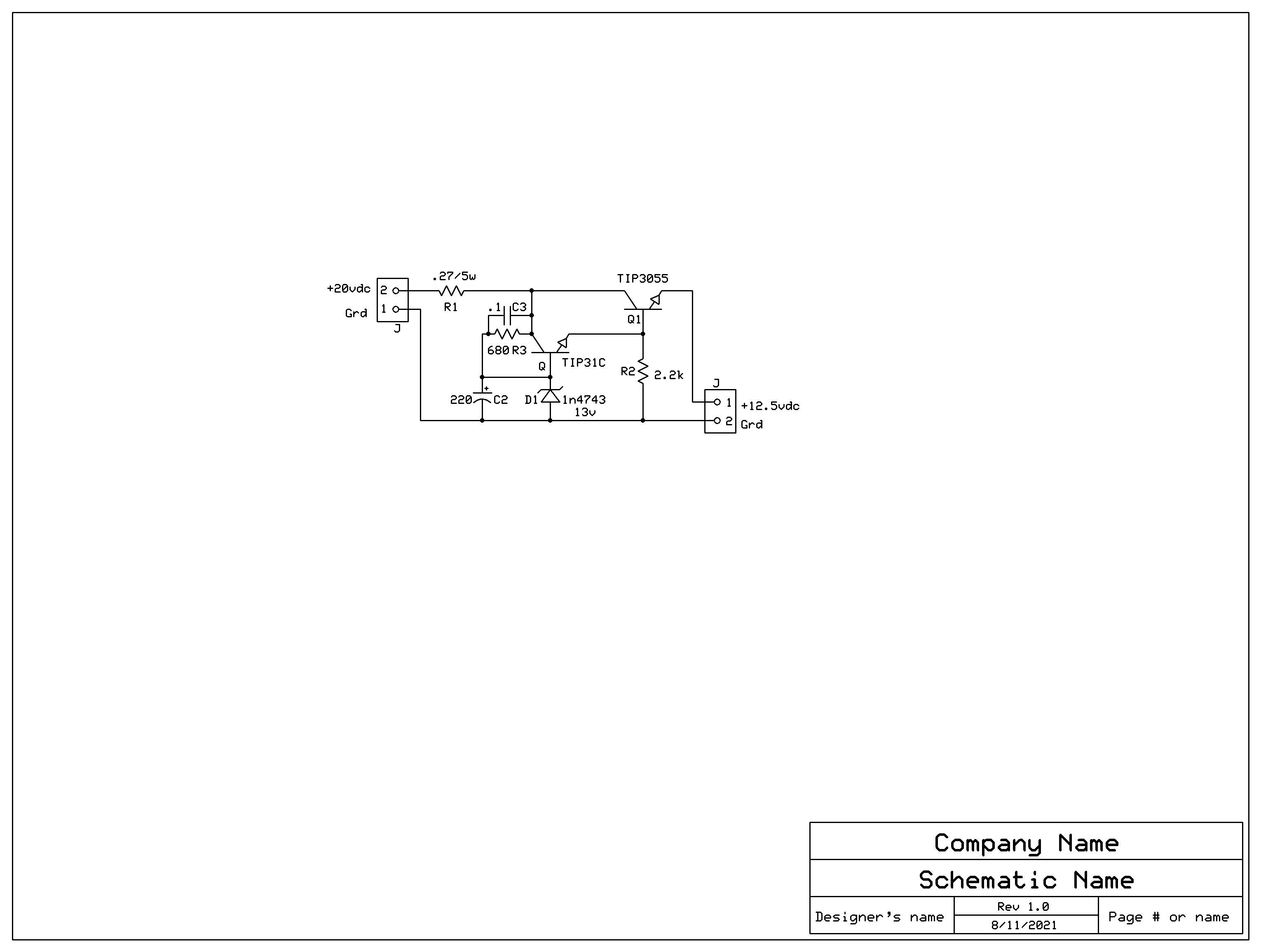

The USB Music player was a bit much for a LM7812, even with a heat-sink so I Built a regulator using a TIP3055, TIP31C and a 13v Zener diode.
For the SPDIF I used a LM7805 and powered it from the 12v regulator.
Nothing gets hot and the ripple voltage is about 1mv from the toroid power supply.

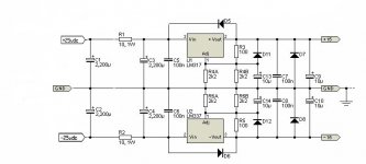

I'm using LM337 and LM317 for the +/-15v for the pre-amp.
It sounds very good, Quite (No Hum or hiss).
I did try the pre-amp kits from ebay and they did not sound as good.

12vdc regulator that I used...Works perfect!😀 and the powersupply I used from Elliott Sound
