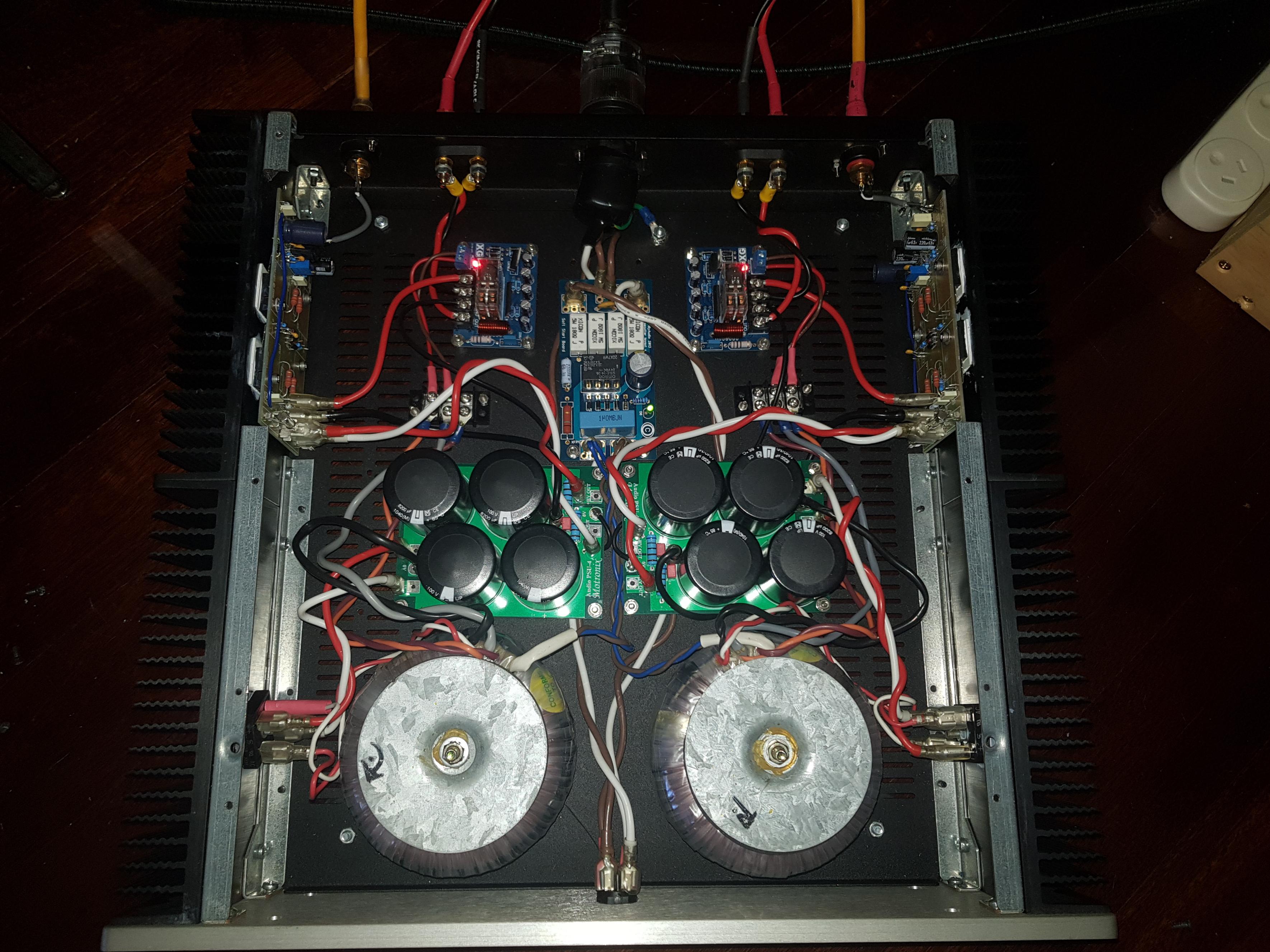

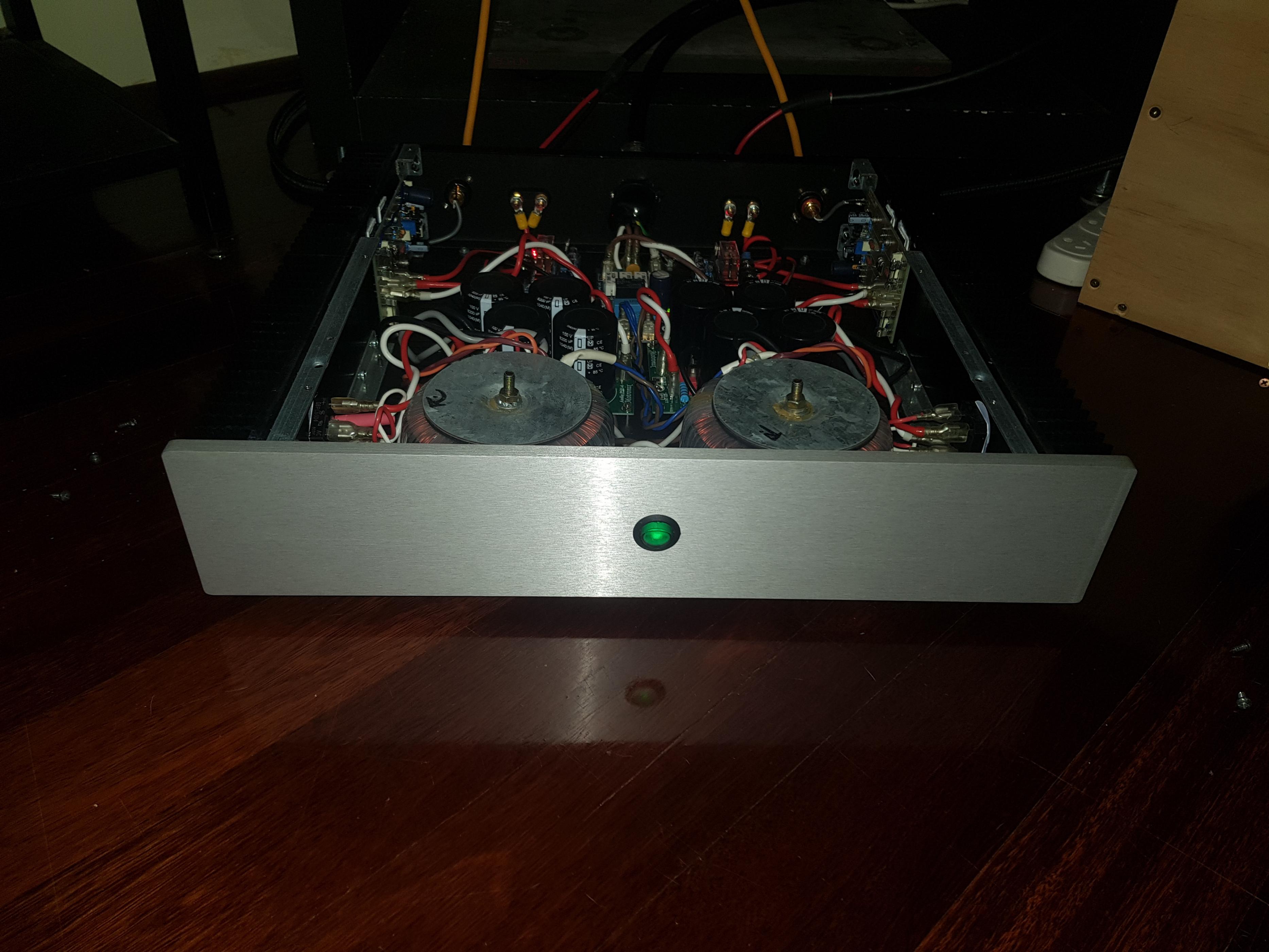

My P101
This is my P101 build of a couple of years ago. No issues and emailing Rob directly is the best way. The website help is dominated by a some more keen on showing how smart they are.
My case should have been higher. I had to make a few mods.
Just listening to them on my just finished esl63s. They sound better than any of my other amps. (Holton 350w, rebuilt quad 405, Bryson 4bst). One day I will fit some better PS caps.

Ha! That looks to be the exact case I was trying to use - the Cover and bottom support rails were to be cut to make fit (exactly like yours), but I was still worried that the Transistors would short to case, so I tried the flying leads - and had all sorts of issues...
How high did you bias?
I am using them on Quad ESL-988. Kinda deciding which amps sounds best - the Hypex NC400, the ESP P101 or an old Tripath TA0103A base amp I built...
