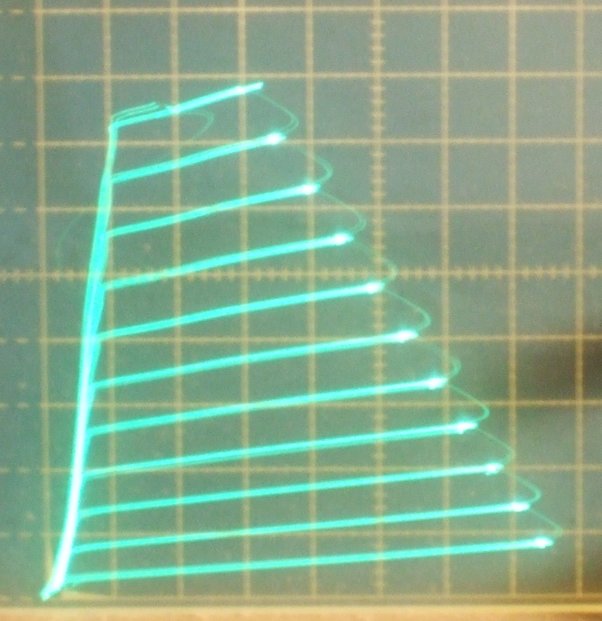

I looked at the E130L datasheet triode curves again. Looks like you just have to run with 120V to 150V B+ and all is well for max ratings. It's 300 mA max DC rating will compensate for the low B+ with a low Zprimary OT.
I also ordered an E130L off Ebay to evaluate. I'm surprised that the plate size is about like a 17.5 Watt TV Sweep tube. The big grid support posts make it apparent that it has frame grids for g1 and g2. Although the grid wire spacing is just a little closer than a 21HB5 (the closest grid wire spacing TV Sweep I've seen).
So the E130L 10% screen current (of plate current at max knee) is likely from grid wire alignment.
Looking at the curves for an 8417 tube, I see screen current at 18.5% of plate current at max knee.
Looking at EL3010 I see screen current at about 25%
Looking at EL503 I see screen current at 10%
for 21LG6 I see 5%
And for 21HB5 I see screen current at 3% to 5%
Low screen current might indicate good possibilities for triode operation. However 21LG6 only has a 200V max g2 rating and 21HB5 only a 220V max g2 rating. Both have plenty of current capability to run at low B+ like the E130L at least.
21HB5 have no plate cap. Two of them in parallel would give an effective E130L or EL503. They used to be real cheap back a few years ($1), but are now around $6. 17/22KV6 would be another similar possibility, $6 too.
21HB5 using Crazy/Twin drive below:
