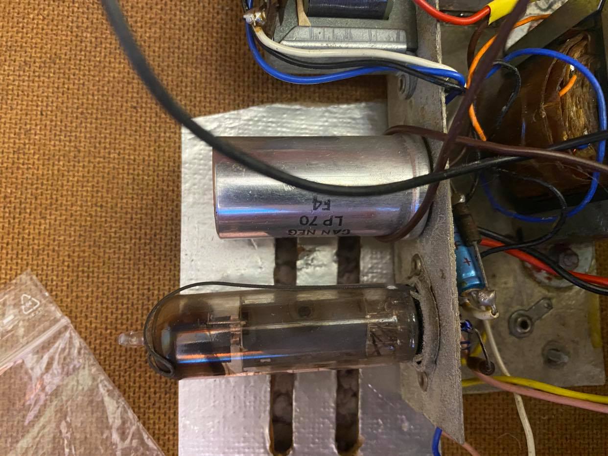

Why do you not publish some pictures to assist the forum in
helping you ?

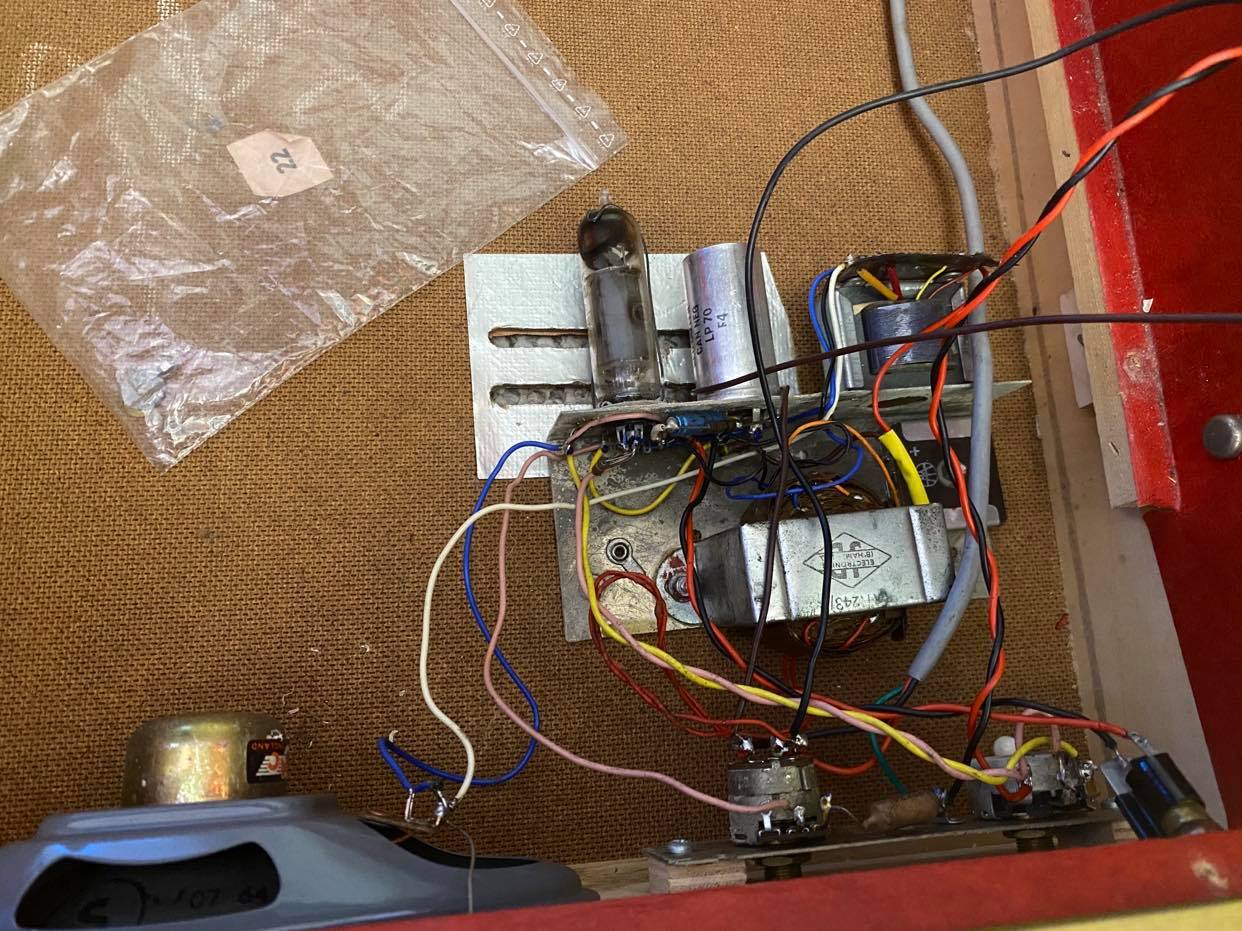

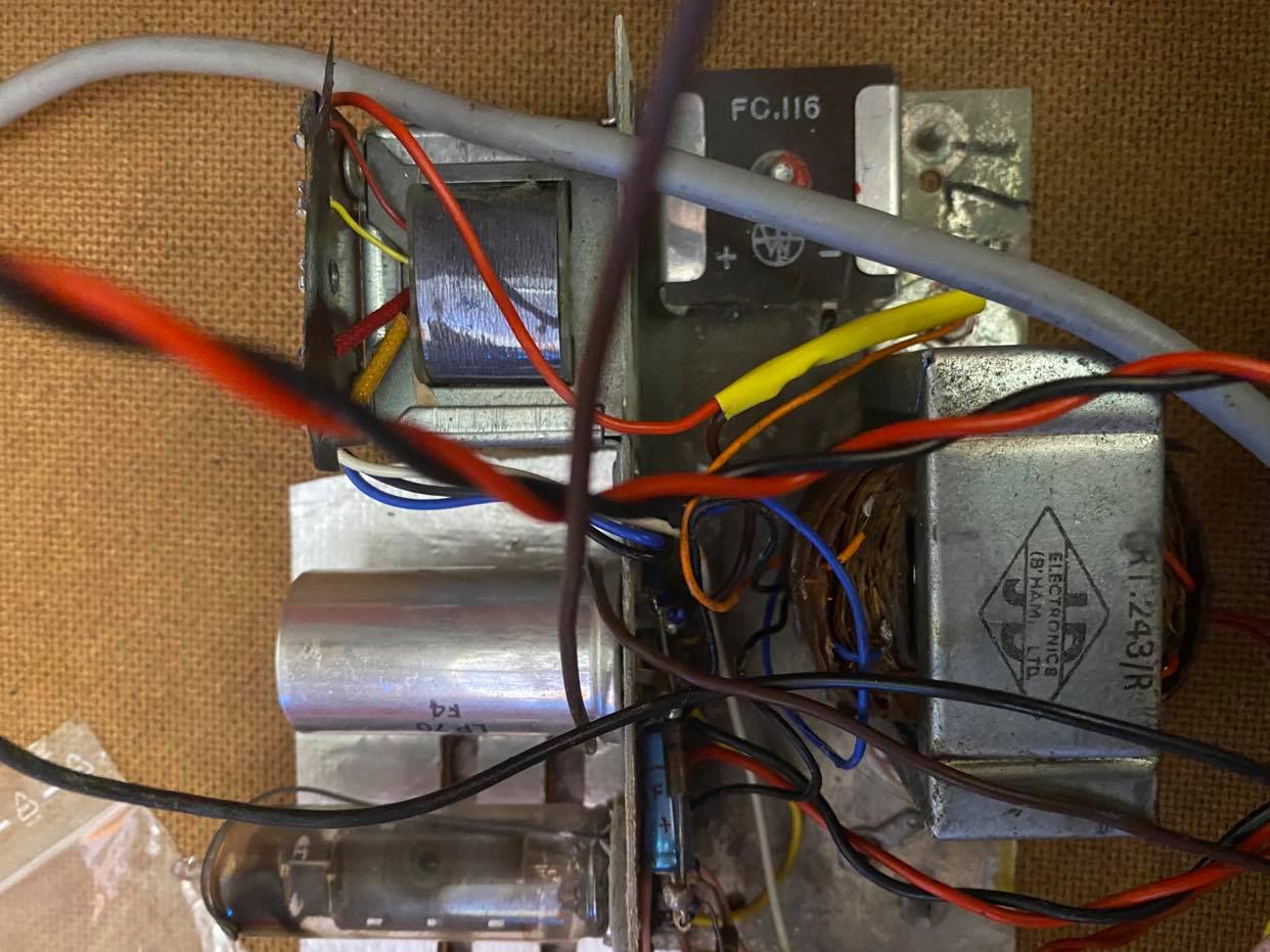

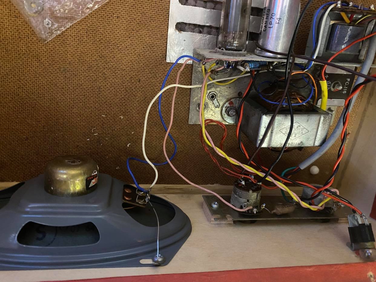

Here! Thank you.
Note: The metal rectifier is still there, but it isn't connected anymore. The 1n4007 is under the yellow heatshrink.

The transformer surely suffers from increased mains voltage.
In order to check this measure the filament voltage.
The diode rectifier resistor should be increased or an adequate
light bulb used to decrease the mains input.
The transformer should be impregnated at the local winder and
mounted on rubber.
