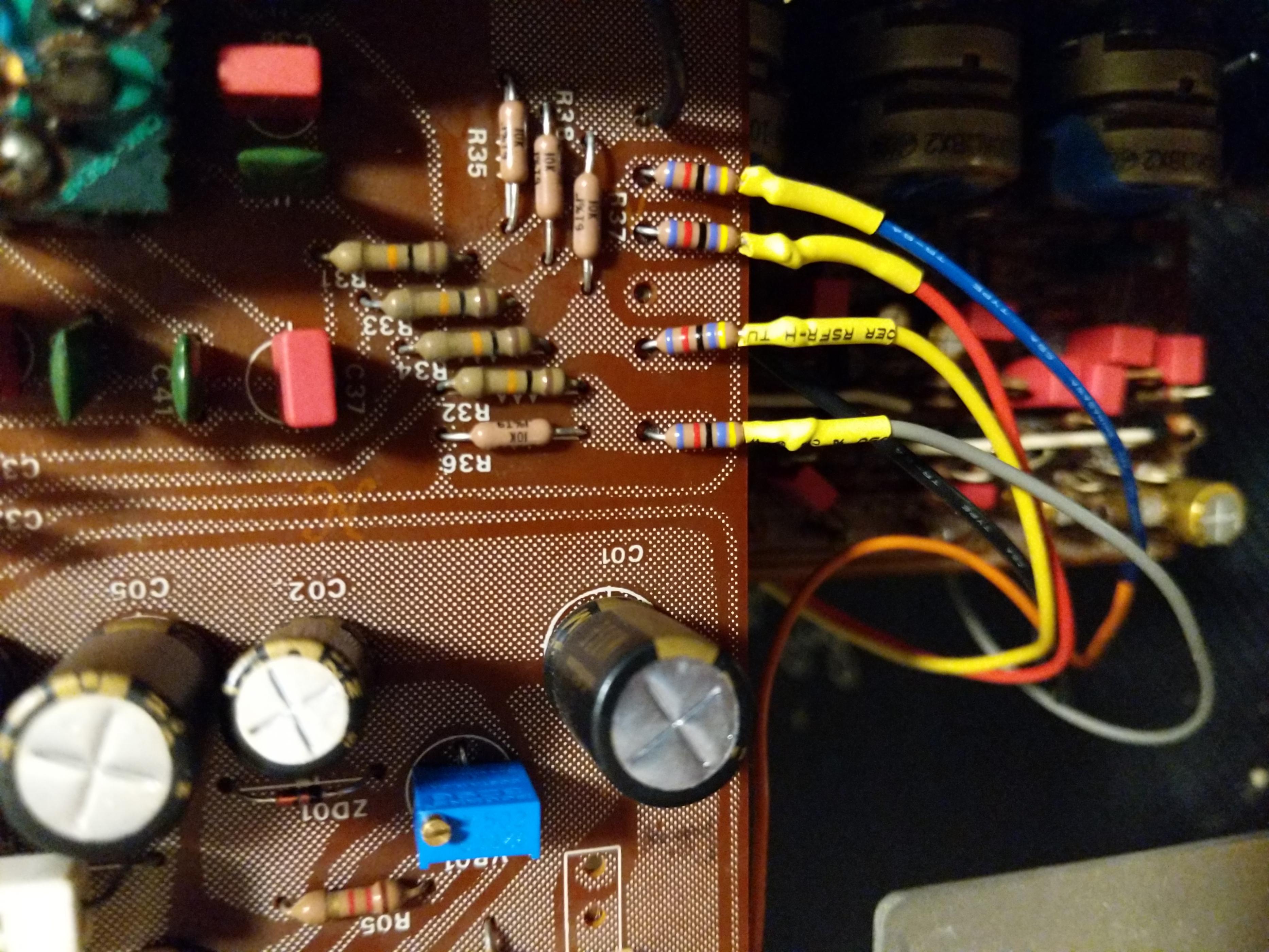

Hey folks,
Quick update here: I implemented the gain modification suggested by sgrossklass and it worked great. I can now only hear a slight hiss from very close to the speaker and the useful range of the volume control has been improved. There's no audible hiss whatsoever from the listening position. I'm very grateful for the suggestion!
I haven't had the opportunity to try the other suggestions yet - have family in town for Thanksgiving - but just wanted to update the thread and say thanks again.
I attached a photo where you can see the 47K resistors in-line with the outputs of the tone control board and the new 10K resistors to ground.
