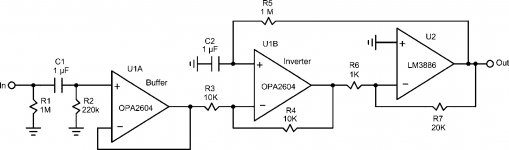

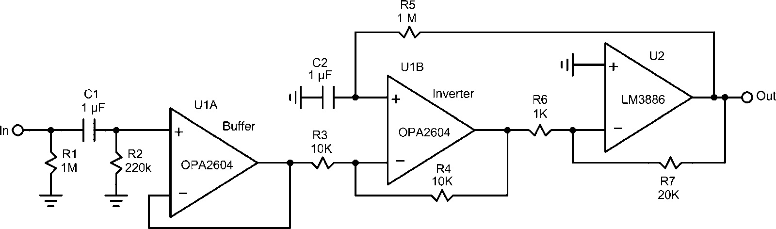

Apologies for waking up an old thread, but I have a peculiar problem .
I built a Lm3886 based on Bob cordell's super gain clone but without the DC servo .
There is around a 4v turn on DC spike and and -4V turn off spike, I have narrowed it down to the buffer circuit causing this when the rails collapse. Even though the 3886 mute timing is correct the buffer has a direct connection to output via R7 which probably causes an offset when the rails collapse and LM3886 being in mute mode has no control on this.I think the -ve rail collapsing faster than the +ve rail might be causing this.
Cordell's design with the servo might not have this as the servo would be counter acting any DC but I still doubt as to how effective the servo would be when the power supply is collapsing.

1) are you measuring those spikes with the speaker connected?
If so, there is nothing the inverter can do to directly cause such a spike on the output.
Hint: 20k in series with 8 ohms.
2) If you are reproducing a published circuit, in principle copy it in full or not at all.
3) what´s wrong with the datasheet example ? 😕
I bet it works properly and sounds very good 🙂

I measured it without the speaker and with the speaker I hear a distinct pop.
The diagram I reproduced is actually the full diagram in Cordell's book.
The datasheet is fine but I wanted to use the inverting configuration and try out the technique for removing the large cap from the feedback path in the normal non inverting configuration.
Except for the startup thump this configuration sounds very very good, no complaints on sound quality.
I have got a little hint though why it might be occurring, its on page2, http://www.analog.com/media/en/technical-documentation/application-notes/AN-202.pdf.
I don't see an option except to use muting relays on amp output.
The mute control of the 3886 is not turned on until the current through the pin drops below 1ma. The low voltage turn off threshold is 12V, so it's possible that the mute control is not activating (depends on your selection of Rmute) before the amp has reached that voltage.
In the meanwhile, the inverter power supply might be collapsing faster and lose control over its output. I see similar issues with active crossovers and buffers, and the only two options are to mute the speaker output or amplifier input, or use power timing control to ensure the small signal stages always get power, at least until the 3886 shuts down.
You can monitor shut down status through the current in the mute resistor.

Are there any single supply line level circuits before the amp, or is the amp single supply? These will often use an AC coupling cap (a first order RC HP filter). The output of the filter will have a step response consisting of a large pulse at turn on and turn off. This is when the halfway biased voltage steps up from 0V (when off) to half of supply voltage, and then drops down again to 0V when the power is turned off. The step response pulse can be quite large. You will need a relay to isolate the input (or the amp's output) until the pulse has subsided.
The same pulse can occur if there is large DC offset coming from upstream circuits to the amp. Check for DC at the amp input during operation using a multimeter.
Keep in mind that AC coupled equipment has start-up and shut down behavior that is different than the steady-state behavior.
