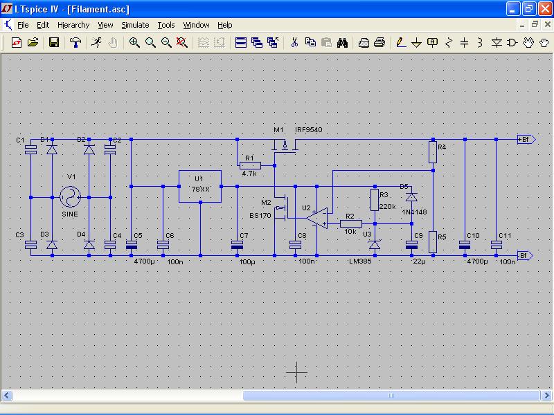

I forgot to mention, that during startup, due to the huge temperature gradients, unnecessary stresses occur inside the valve.
This can be seen and sometimes even listen with certain valves.
Solution : Soft start in heaters PSU.
Protecting a single valve, single phenomenon: 15 cents
Keep all valves happy: A good power supply 😀

Thanks for sharing the circuit!
The issue with Vgk is not the voltage, but the field: volts/m.
Well, I wrote it correctly, I think it it is understood.
During warm up the anode will be at 250V, so if there are any free electrons (e.g. due to photoemission)
I forgot the infrared photoemission. 😱
The next time that take the guitar*, I will take this into account, thanks !
* Folk musical improvisation used in these latitudes. 😀
Maybe this is not unrelated, and it is only to describe the phenomenon

I think you've used a more complex calculation than you need and plugged incorrect numbers into it. 😀
More to the point is the tendency to arc because of the point-like nature of the grid. And that's where a voltage clamp can really help for prevention. If 90V seems too much for you (that's what I use for ImPasse and HMV preamps with not a single failure yet, and there's a few hundred of them out there), use a reverse biased diode to limit it to 0.7V. Far, far cheaper than slow ramping supplies and works just as well- or better.
As a design criterion that is valid, good for you, however, place more than one resistor on the grid, scares me.
I spent years making PSUs occupying half of enclosures, never had problems with hum, buzz, audible noise, even more, I never need to use balanced inputs with 66 dB gain mc preamps.
And I do not want to brag, my knowledge is pretty limited, rather than using the standard KISS, I use WKISICW: Why Keep It Simple If Complicated Works ? 😀
I think his numbers are OK. Interpretation of what they mean is the issue. It is the E field (and local concentration such as by grid wires) which can directly ionise gas molecules. It is the voltage which gives energy to any ions. 40eV is not a lot of energy. I believe (not sure) that it is the momentum which damages the cold cathode, which would vary as sqrt(V).
Some people seem to get away with no protection. A neon is a big improvement, and can be regarded as being completely out of the circuit during normal operation (apart from a tiny capacitance). A diode is even safer for the grid, but imposes a small (but boostrapped) non-linear capacitance in normal operation.
If you consider the planes of the cathode and grid equipotential, then the V/cm is very straightforward to calculate and very low numbers. The grid-cathode voltage issue is not one of ion bombardment (the grid cross section is too small for that) but rather arcing.
I don't think the grid to cathode spacing of an ECC83 is 20u! 😀
This is correct, I just suggested it on post#31, thanks !
In the worst case, 2MV/m are under vacuum rupture eg from 20 MV/m to 40 MV/m.
However, I do not like a tiny capacitance, much less a non-linear capacitance in normal operation, I prefer many cheap components in the PSU.
I think SY is somewhat stingy, but keep it quiet. 😀
That is precisely the maximum simplification that I did in my calculations, assume the equipotential surfaces as parallel planes.
Otherwise, you would have to solve the Poisson equation in elliptic cylindrical coordinates, I'll pass, thanks.
BTW. If you use V/cm instead of V/m, your results will be two orders of magnitude smaller than mine...
Count me out to play poker with you. 😀
I swear I did not find a damn data for the distance between cathode and anode.
However, in Toshiba's paper fig.7, ion bombardment starts at something like 100eV, not to say wow, but Ion bombarment stops being a ghost.
