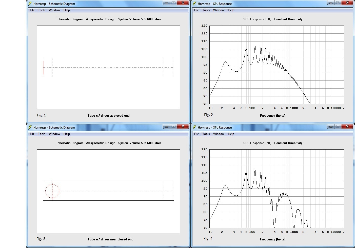

Let's build a Tapped Horn, element by element. Figure 1 is a tube with a speaker capping the left
end and the right end open. Driving the air in the tube with a one watt signal, beginning at 10Hz
and sweeping up to 3000, and results in the response shown in figure 2.
It's easier to make a Tapped Horn if the speaker is near, but not at, the left end. Moving the
speaker to the side (fig.3) results in changing the response (fig.4), but only the response above
150 Hz.

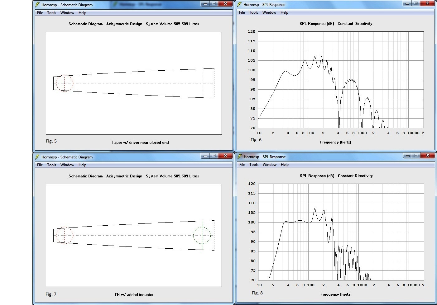

Next, let's keep the volume the same (500 Liters) while we taper the tube (see fig.5). This
changes everything. While the curve (fig.5) is shifted slightly to the right, the response on average
is smoother and louder between 30 and 150 Hz.
Last, we add in the Tapped Horn effect! We add the input from the back of the driver near the right
side in figure 7. This raises the response (see fig.8) in the 40-70 Hz area while it lowers the peak
at 85Hz. The peaks at 135 and 200 Hz are much weaker than shown.
