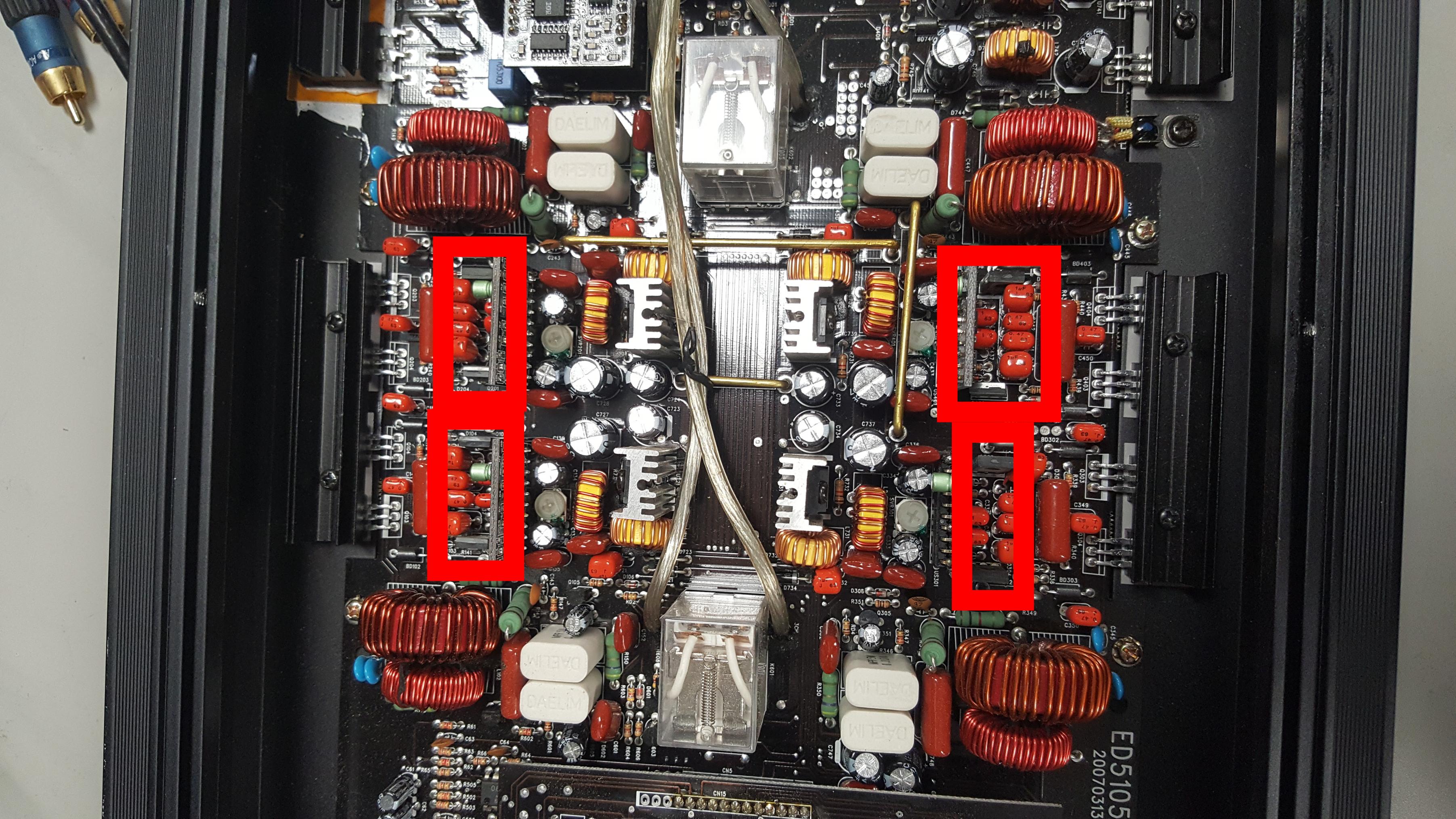

Second question has to do with some component temperatures. The amp uses 4 pairs of (I'm assuming) drivers. I think these are for each of the 4 main channels, but I am not completely sure of that. The reference designators are Q101/102, Q201/202, Q301/302, and Q401/402. They are are BD139-10 and BD140-10 pair. When I use my thermal camera, these components get really hot at around 100C. It does not seem to matter if it is at idle or at load, but they are lighting up hot. Is that normal for this design or if not where would I be looking? It seems odd that if there was an issue that all four pairs would all have issues because they seem fairly independent based on channel.
I have included a highlighted picture of the location of these components.

The drivers appear to have a brown tint in the photos I have which is often an indicator that they've run hot.

I think only the sub channel is class D. I think the 4 channel full range section is class A/B. If this really is a full range class D, then the amp chassis seems about 400% oversized and the full range section is very inefficient. I think the drivers we are talking about are for a class A/B section.

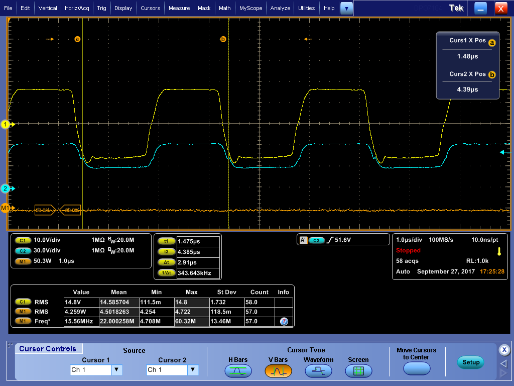

Looks like you are right. I should have taken a closer look when I was in there and not just assumed. Looks like each channel does have its own driver. The fact remains though that I'm not sure if what I'm looking at is correct for OEM or if something is wrong. I have included a picture of the base of the BD139 and the gate of the corresponding output with the amp just idling. Looks like about 340khz switching frequency. Keep in mind both scope probes are referenced to earth ground, so that is why there might be an offset.
So anyone else able to confirm what the OEM transistors are or if everything looks normal? I understand it may not be the best design, but if it is original I can live with it.
The idle current draw is normal for me, but maybe bd139 and bd140 run hot for two reason.So anyone else able to confirm what the OEM transistors are or if everything looks normal? I understand it may not be the best design, but if it is original I can live with it.
IMHO, they have too little driver capacity and are too slow for Full range class D application.
As I mentioned in my post above, I would have used couples d44vh10 and d45vh10 (unfortunately however, they have the connecting pins in a different order), if you feel like making an adaptation, then you can do it.

For options that are the same case as the BD139/140, what about the MJE172/182?

BD139 And BD140, will warm today, will heat tomorrow, maybe even for a long time, but will be destined to die.
MJE172 AND MJE182 are already much better, they are used in D class subwoofer amplifiers, where the switching frequency is equal to or slightly over 100khz, without any problem, but looking at the datasheet, it seems that they can be yours.
