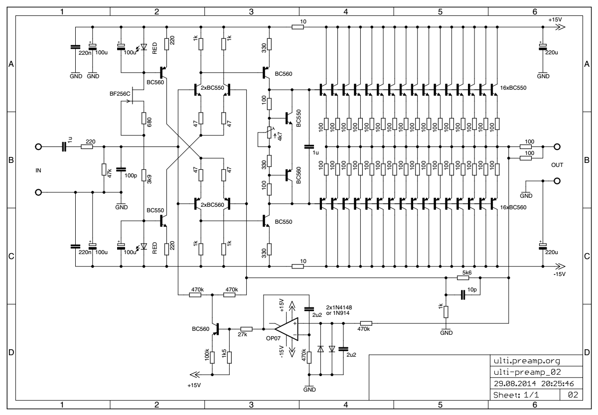

Do those zenerdiodes effect the performance (soundquality) of the amplifier? Are red leds also an option?SSM types
Hi Rudy,
I did not use SSM matched pairs in this amplifier.
I used the 2N2918 and BFX36 matched pairs for the gain stages, according to the original schematic.
If you modify the schematic it is possible to use SSM or MAT types, last mentioned pairs will make the sound better !
Just lower the railvoltage or use some zenerdiodes in the collectors.
best regards
Piersma
The dynamic zener resistance is very low, not impacting the overall gain of the first amplifier stage.
If I recall right, there was an elektor version from Ulti-Amp with low power voltage but very high output current for driving low impedance loudspeakers, e. g. ribbon speakers. The topology looks like those from Ulti-Preamp in the attached file, but instead the small signal transistors in the output buffer there was in use power BjT devices from Sanken or Toshiba.
Maybe it was this elektor power amp project:
https://www.elektormagazine.com/magazine/elektor-199211/32717
https://www.elektormagazine.com/magazine/elektor-199212/32782
Maybe one of the member can upload the schematic - thank you very much.
