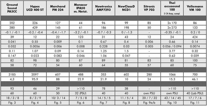

Bender.ru said:Wow, my own result is not too bad, compared to some tested class D modules...chic!
Really? Post here as chart please!
Thanx. Well, little bit strange point is -1db power, why not -3db as usual? Actually, and Bender can confirm it, i always told -real pro=Bruno IMO NCD1 THD&Noise measurement vs promises looks quite predictedly yet, Classd4sure was right..
http://www.newclassd.com/index.php?page=10
THD levels are the lowest in the Audio Industry at most load conditions, and at the most common conditions such as 1W @ 8 Ohm and 10W @ 4 Ohm, the distortion of the NewClassD module is 3 to 15 times lower than the leading other brands of Class D modules. This is a difference you can hear instantly.
Furthermore you get 115 dB of usable dynamic range, very low background noise, and wide bandwidth up to 120 kHz.

Hello Ivan
We double checked the modules when they returned from the test in Elektor, because the level of THD would be rejected in our quality control. So it looked strange that a module with this high THD (0.03%) would have gotten through.
Our control check showed that the 0.03% was correct on one of the modules, at 10 kHz, while at the rest of the audio band the THD was 0.005%. After a further examination, it turned out that the trimmers on the module had been tampered with, even if they are locked with laquer, and it takes quite a bit of violence to loosen them. The other module showed 0.002% THD throughout the audio band, and the trimmers were locked.
As we examined the test in Elektor more carefully, they measured the output power to ~100W with a 40V supply, even though it is stated in our datasheet that the nominal voltage is 60 - 63V DC. This might give the less observant reader the impression that our module is only delivering ~100W while our competition put out ~200W. When in fact the only difference on that point is the power supply voltage being wrong by the test team.
We don't know if these 'faults' are deliberate or just sloppyness on behalf of the journalist, however we find it of less importance how our product is rated in Elektor, while it is much more interesting how our customers rate the sound and quality of our modules. So we have no reasons to worry.

Klaus: Thank You for posting these questions.
You are right, maybe it does look a bit strange. I wanted to point out some discrepancies in the test, as a comment to the conclusions made by IVX earlier in this thread.
One flaw of the test is very obvious if you look at the data presented in Elektor. Our amplifier is only putting out around 100 W in the Elektor test, which is only half of what we promise in our datasheet. Some people who read the test might notice this underperformance, and think we oversell our product.
However if you study the test specs in Elektor carefully you will see they have tested our module at 40V and not the recommended 60-63V from our datasheet, building instruction etc. That is the obvious reason the module is only putting out half the promised power. Why did they do that?
I hope for your understanding that i will not wish to make any futher comment on this issue, partly because i have said my points, and also because i don't think that Elektor as a media really target our customers. Personally when i used to buy Elektor, it was because i wanted to see schematics, and new components. Not so much finished audio modules. But admittedly thats some years in the past now.

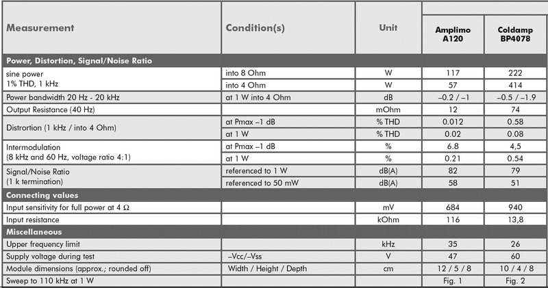

I totally agree with Pierre and Eva.
Once a reasonable good level of THD is reached (say, below 0.1%), the rest is pure make-up. Not saying that is worthless to try to improve this figure, as a better number means a careful and well adjusted design, but I am only saying that trying to reach ultra-low numbers is a waste of time when other points are much more interesting in Class-D designs that have to be investigated.
To be sincere, I am saying this when we try to make our COLDAMP amplifiers as low THD as possible. By the way, we have also seen higher figures in the ELEKTOR article than what we get at our labs (below 0.02% at 1W/8ohm). They simply didn't have too much time to setup the measurement properly and even to hear the amplifiers. Perhaps it was the same story with NCD?
However, we are not worried about that, as we know that our customers value the sound of our products above all, and some of them clearly prefer them to other modules with lower THD even for very high quality and precision demanding applications such as recording studio monitors, etc.
