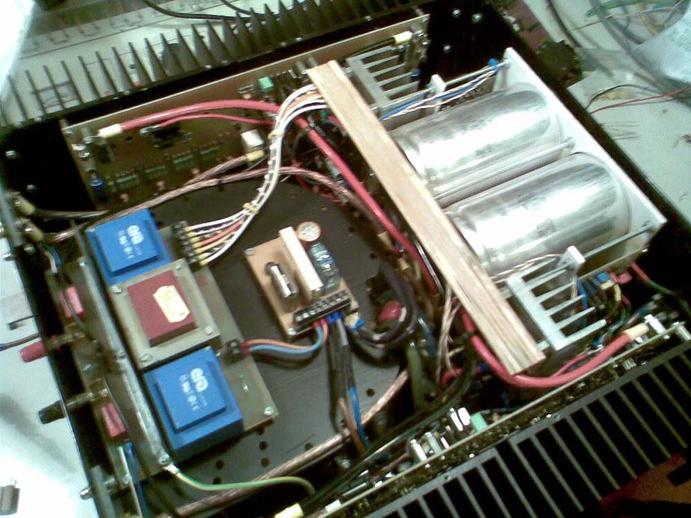

Ok something new:
I have powered up the caps in the psu.
C22,C23 each 440µF/100V
C19,C26 each 4700µF/25V
C20,C21 each 220µF/16V
4 little caps 4,7pF like in the schematic from the AF-3.
Nothing helps against my nasty noise in the power-off sequence.
So i take this caps out of my design.
It's a funny amp from elektor.
You can put in and take out elements and it wouldn't be better or worse 🙂
Don't know what else i can/should do.

Am I the only one who thinks the transformers look a little small for a 1000W amp?
I wonder if it might not be a good idea to connect the caps for the 90V supply from the 90V rail to ground, rather than to the 12V rails. But since there's a definite need for a beefier transformer, why not get a 60-0-60 transformer and skip the stacked power supplies?
EDIT: I just realized that those supplies only feed the driver circuitry. I suppose there's a hefty toroid underneath?
Still, I'd change the supplies to stack the secondaries of the transformers directly, and then rectify and filter the individual voltages separately.

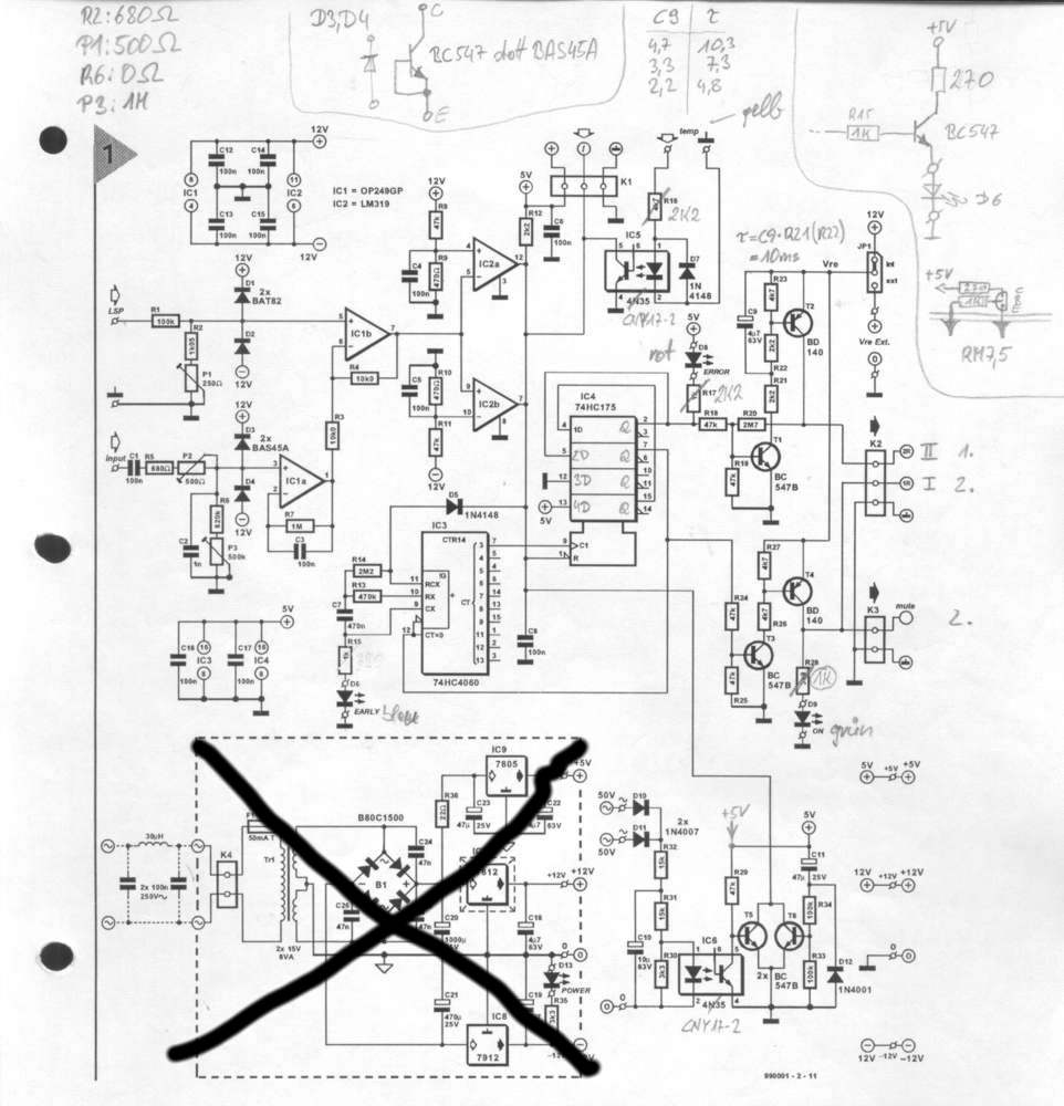

You're seeing the 70V power amp supply still holding up (from C15/C16?) at turn off, after the 90V discharges and the output devices shut off, I think.
The diodes are definitely necessary in this case.

What is the sound at switch off, high pitched or a low thump? I'd connect it to a dummy load and scope the output, then do the same with speakers attached to see what's happening. It sounds like the amp is oscillating at SW off.
One thing to note, doubling up the capacitance in the PSU is in general not a good idea, it stresses the main tfmr, you have a lot more surge current, some heavy duty thermistors on the AC IP would help as would a slow start circuit.
Andy.

do perhaps have some schematic of the changes you made, it's hard to follow from just the description.
