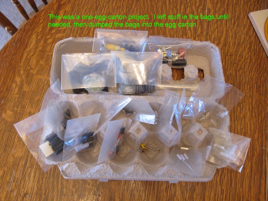

I purchased a TU-879S from Tube Depot (they are in Memphis, so pretty local to me) with the intention of building it this weekend.
I'm at our lake house for the labor day weekend, so I'm not sure how much progress I can make with all the other holiday stuff that will be going on.

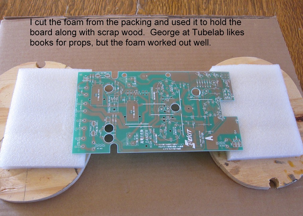

A couple of initial observations: with my kit, the documentation is entirely in japanese! Still, it looks simple enough, the pictures are clear, the board is intuitively marked (components that go on the reverse side have a dashed outline) so it looks like no big deal. The board looks to be very high quality.
The output trannies look to be sized identically, as in drop in replacement with no drilling, for the 10 watt XSE Edcors!
More later, and pics if I can figure it out from my cell phone.

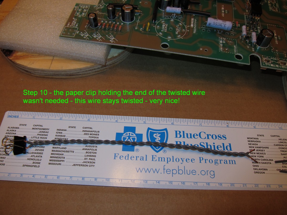

Just bought a TU-879s from Victor - who is a true gentleman - and finished the build in something like 7 or 8 hours. I was having too much fun to track the time closely.
I used to build Heathkits as a teenager, and also a Dynaco or two. I am happy to report that this is a great kit, with quality parts, plenty of wire and hardware, and Victor's English instructions are very well done.
I think David Kan really covered both the build of this amp with his photos, as well as the sound, in his 2008 6moons review, so I don't intend to repeat anything he said. With that in mind, I took a series of pictures of the build, and will post several of them here in this thread.

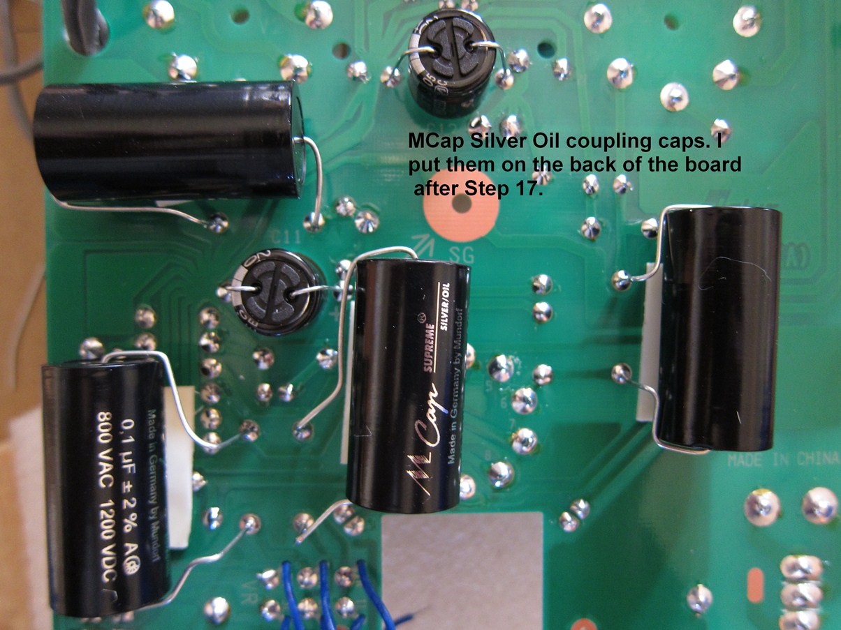

The only modification I made was to substitute better coupling caps. I have found this really can make a difference in several other projects. I was leaning towards Auricaps, having had good luck with them before. Victor strongly advised oil caps, but he was out of the Vitamin Q's he sells.
Based on various reviews of caps around the internet I splurged a little and chose Mundorf silver/oils. Cap tests are highly subjective, and the results vary like crazy, but the silver/oils seem to do pretty well everywhere.
