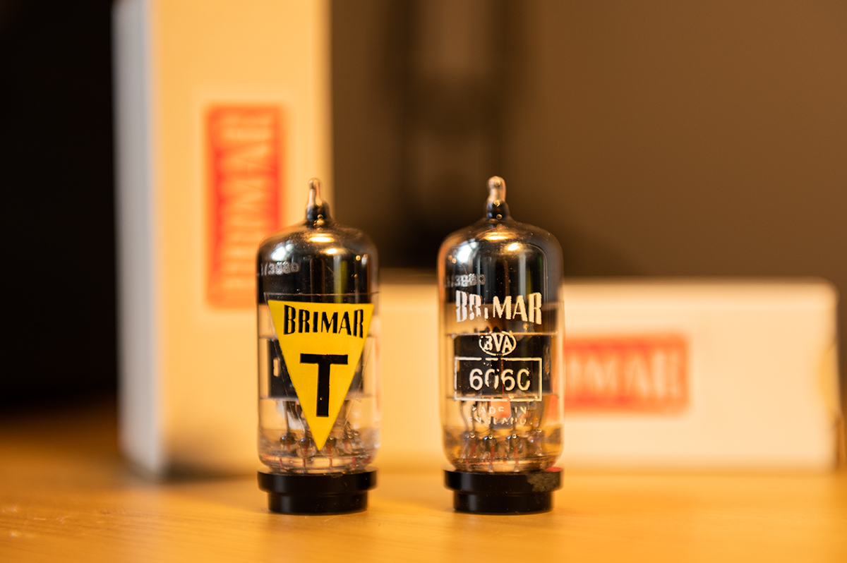

vkung, changing the pair of tubes was the first thinng I did. as mentioned above, it was the faulty power strip and everything's working fine now 🙂
Installed now is a pair of Brimar 6060 Yellow T. sounds exquisite with the TU-8500. it's worth a try 😉
Do you have another pair of tube set to test TU-8500?

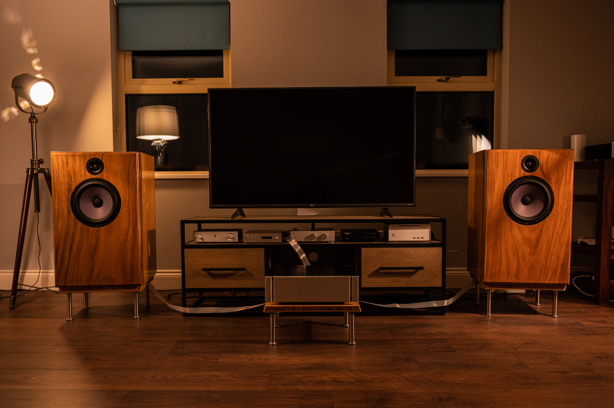

I don't have 40yrs experience on building electronics but this is not my first diy project. In a way you are correct, this is my first tube device build. Attached is a photo of my system, all diy except for the TV and DAC. still gaining experience and knowledge along the way 😉

Hi Peter,
Thanks for the compliment.
From far right of the rack: Fanless PC running Daphile, next to it is the Denafrips Ares II DAC, then the Elekit TU-8500, at the center on it's own stand is the F5 power amp.
Far left of the rack is DCB1 preamp, next to it is diy dual mono AK4497 DAC. Speakers are Devore Orangutan clone. there's also a rack on the right, out of the picture where other diy stuff are placed.
