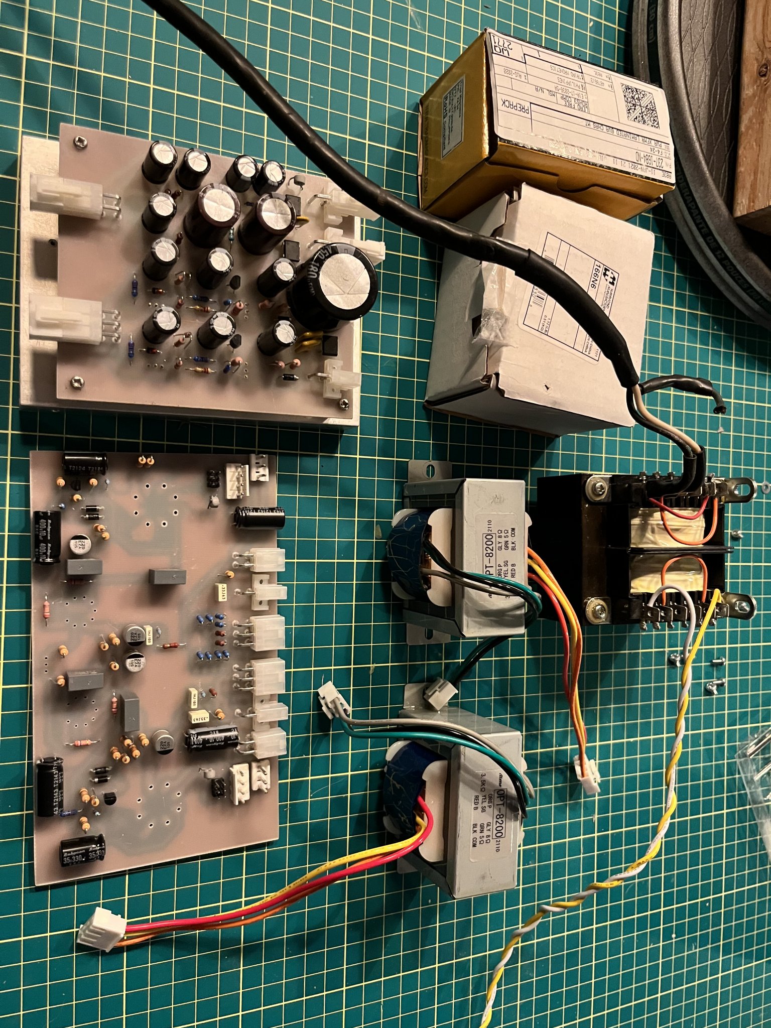

Hypothetically, could one alter the “REF” reference voltage to run the target bias cooler? Say if I want to run lower dissipation tubes
I’m not too afraid of popping parts since i’ll be using the original OPTs out of my TU8200R (which was upgraded to the lundahl transformers) to build a clone of the 8200R which I intend to use for such reckless experiments. (as long as i don’t burn up the OPTs themselves)
Do not change REF voltage as it can cause auto bias to fail. The plate current is approx. 72 mA, which is set by R19-R22. The current is almost inversely proportional to the value of these resistors.Hypothetically, could one alter the “REF” reference voltage to run the target bias cooler? Say if I want to run lower dissipation tubes
