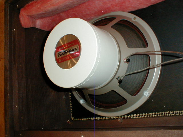

I have an SP-12 and would love to find a match to make a pair. This has a huge alnico magnet, 2-1/2" VC, long lived treated cloth accordion surround and a whizzer cone. Efficiency seems pretty high.
Amyone got specs on these? The SP-12B looks totally different. I haven't seen a SP-12C.
Holy smokes, that is way different from the 12C.
The 12C has a tiny magnet on it, though it does have a cast aluminium frame.
Yours looks a heck of a lot better.

Here's a nice site on Vintage E.V. speakers.
Also I have this data for the SP12C from a forum post, but I don't recall if these are "official" or messured by s.o.
SP12C likes 140L vented cabinets, and goes down to ~ 40 Hz.
37-10000 Hz
100dB /1W/1m
111 dB max
25W
8 Ohm
45Hz fs
0,67 Qt
0,1672 m³ VAS
best, LC

I owned a pair of sp12c's many years ago. I had mine in a 5.5 cu ft bass reflex cabnets based on EV's own plans. They are excellent speakers.
