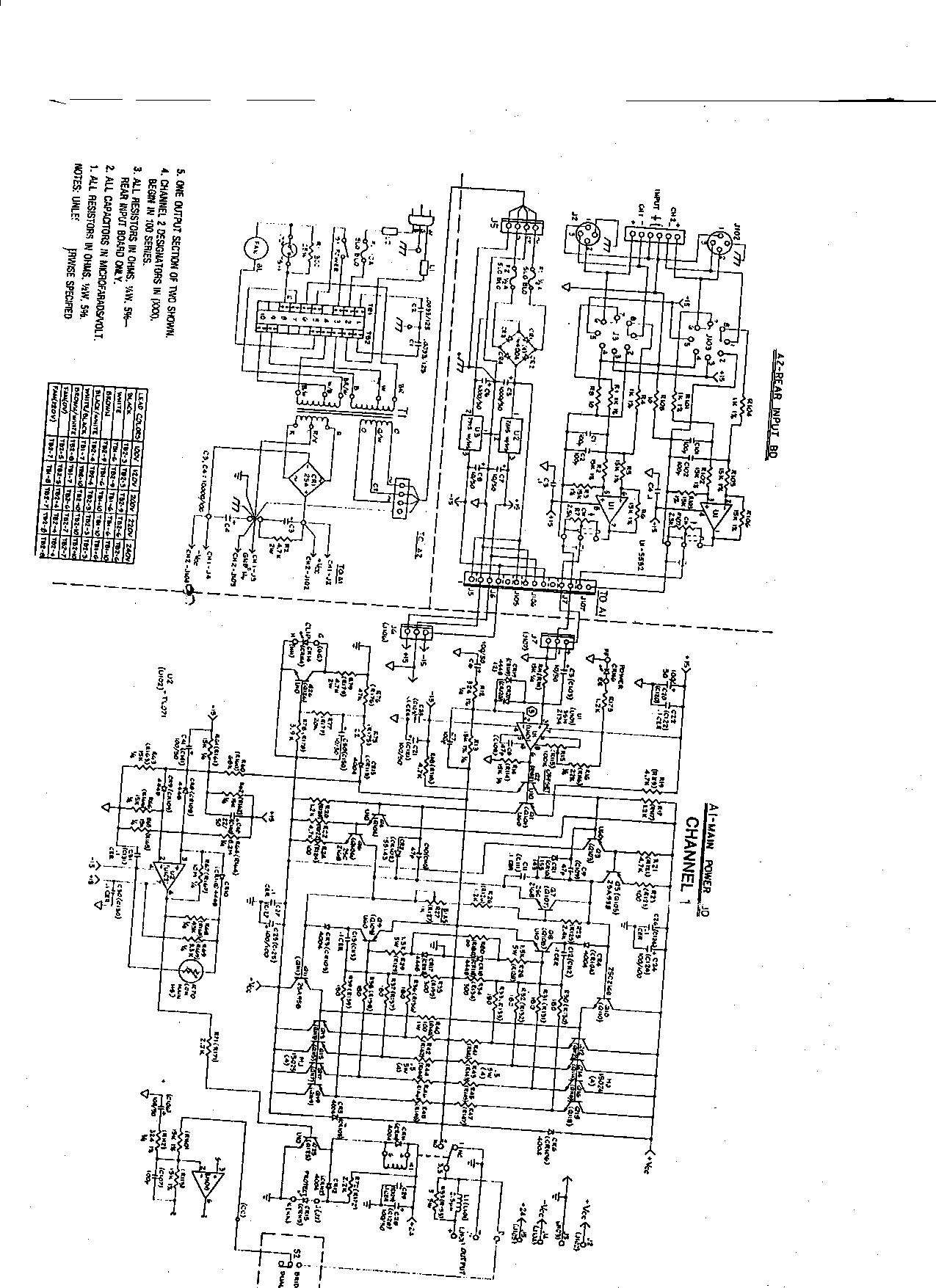

Unfortunately there are some problems with amplifiers that cannot be fixed in 10 min or less. Your friend should have let you work on this a few days. My suggestion is that you contact your friend and buy a few more days with the ailing 7300A. I can and will obtain ALL the information needed to enact a complete repair of this animal. Building and or buying something else will not be the solution in my opinion. Its far more cost effective to repair this old work horse and have something capable of taking some abuse. If you lived in this country I would ship you a working EV2400, or Altec 9444B/SA but shipping to your country would be excessive. Lets get it back so we can fix it.😀
The 7300A,7300,9444b, 9444B/SA, EV2400, and EV3600 are stout amplifiers. They aren't nearly as stout as the Altec 9440 (my favorite) but they are surely better than most out there in a commercial and or industrial setting or in a situation where they will receive a lot of abuse.
The 7300 has separate +15 and -15 volt regulators and doesn't suffer the same faults as the the 9444B/SA and the amplifiers in that family. The protection circuit in the 9444 series must be perfect in order for the supply voltage to be correct to the Op Amp. Usually the caps in the protection circuit start to get leaky and then you will obtain a lop sided supply to the OP Amp and as you know it just doesn't work correctly then.

Thank you for the information on this amp. The image doesn't look that clear as an attachment, but compared to nothing it may be a life saver.

Did you look at the schematic I posted? First look and see if yours is the 7300A or the older 7300 series as there is a difference.
Things that go bad in this series of amplifiers.
1.) Check the protection circuit operation.
2.) Check the caps in the protection circuit.
3.) Check the bias controls and replace with fixed resistors (after amp is running).
4.) check the 4.7ohm resistors in the bias circuit.
5.) Check the 5.1v zenier resistors protection (B) (D)
Rail is going to be the same B+ and B-

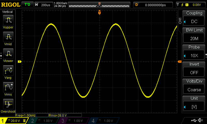

This time i knew that DC on the output is irrelevant because the output is AC coupled by the caps, and after many hours of trying to stabilize it's quiescent point i gave up and put an 8 Ohm load and an oscilloscope on the output, and a signal generator on the input ( on pin 2 of the opamp ), and powered it up, that way i could see that the negative swing of the output was missing, to make sure the output stage is ok i disconnected the output of the opamp from the drivers, and injected an ac coupled signal directly on the input of the drivers, the output looked ok ( ignoring the crossover distortion on the sinewave ). Then i knew that the problem must be on the opamp side, and after masuring voltages i found a problem on R34 and R35 divider, and after removing both of them i found that one of them was open. This is the unexpected part because those resistors do not need to dissipate much and they looked just fine visually, no heat damage, no scratch or anything else , i did replaced both of them with 2 paralleled 100k/0.25W/1% each, and the amp was working again...
This is it's maximum output just below clipping on an 8 Ohm load:
https://i.postimg.cc/SR5Pff4c/Pmax-8R.png

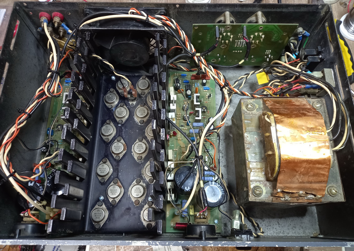

And the inside...
https://i.postimg.cc/L40GS2Ph/Inside.jpg

Turns out i do know how to measure BJT's 🙂 , they were not at fault, in fact it was something i did not expected...Sorry, no. I don't buy that statement without knowing you.

That's fantastic! I am so glad you finally licked it.
Yes, I have seen resistors go open like that before. Something you don't expect, but can happen. Anyway, you must feel like a million bucks!
