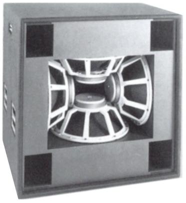

Does anyone remember a sub electrovoice used to make many years ago,it was about 45" by 45" by 30" deep. It had 4-18" subs all loaded with their magnets almost touching in a cavity that was open to atmosphere,and the front of each woofer was loaded into it's own ported box ,I guess all the 18's had their polarity reversed?
Weird configuration but I have been in a club and at parties where they were used .The bass was so tremendous with 4 of these cabs,i've not heard anything close since then.
If you have a model # it would be much appreciated. EV's site has been down for a while and I can't find any info.
You mean the EV MTL4??

With these newer drivers that handle twice the wattage of those specs this box should kick some serious *ss. Imagine 4 -18" Peavey lo-riders running off a Crest CC5500 in that box!!!!!! Can't wait to get some 5 by 5 baltic!

"I suppose a lot more drivers will fit as well. "
Might. The volume is only about 3.3 cu ft per driver though, most 18s like more than that. The ports are also quite small, EV data showed them going into compression and changing the box tuning at high power levels. You are still left with moving them.
The design in my photo uses a long x-max 15, which has more total displacement than an EV 18. The box is easier to construct, is about 4 cu ft per (net) driver, has bigger ports, and can be moved by one person with a two-wheeled hand truck.

There's been alot of people that have questioned my sanity when it comes to setting my mind to doing weird stuff ,but with some planning and maybe some driver resizing and box finagaling I could make a newer version work. Perhaps with some Nd mag. 12"/15" drivers to make it more versatile plus I always use large ports.
Maybe 4- Lab -12's??
