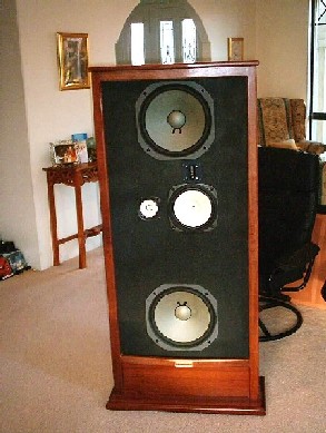

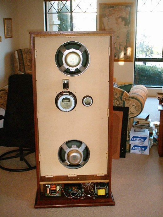

The Excel is meant to be more detailed than the equivalent (Phoenix) Scan Speaks, but I thought primarily in the upper bass. But is it much better in the mids?
It’d be interesting to compare an Excel dipole mid with an electrostatic.
Actually I know a guy who has an Excel dipole – the SL Orion, who lives only about 5 km from a guy who built his own very good, and relatively compact electrostatics.
If I could convince/ help the electrostatics be schlepped over to the Orions, that would be very interesting. 🙂
I agree that (as a centre speaker with diploe L & R) in terms of integration; and in any configuration for power response - the Excel dipole would win.

Michael,
Don't worry too much about the objectivism from Peter and others about what ESLs can and can't do. Their opinion is to be respected, but needs to be sorted in your mind like all things written on the web.
I have noticed over several postings that you have a 'gut feeling' that the ESL-3 is for you. Just go for Mackinlay's ESL-3, you will NOT be disappointed !! It's laser-like precision and Electron Microscope's view on the music is a revelation.
As someone who has kind of done it all recently with the best of cones and ribbons (Accutons & Ravens), see pic below, the ESL-3 with it's ultra thin 3.8 micron membrane is up there with the best.
Steve M.
Steve M.

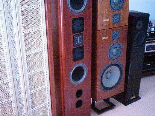

And, another pic of a mega buck $10,000AUD x 90kg speaker I bought using all Seas Excel magnesium drivers, the mighty VAF-I93.
Believe it not but for my tastes in music which is mainly acoustic material, jazz (shimmering cymbals etc) and female vocals, the humble kit ER Audio ESL-3 @ $1,300USD beats them all really...
Steve M.
Steve M.
