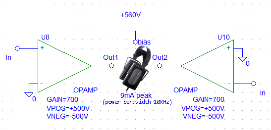

110pFd is embarrassingly small; device and wiring C is super significant.
Specs work out to 1,000V and 9mA peak (at 10KHz). (I note that the companion amps mostly aim for 350Vrms 500V peak.)
I was under the impression that even shrill recordings did not have FS levels past 6KHz; if they do now, I would not want to hear them. 20KHz power response is not needed. We do not wish to strain at 6Khz; 10KHz seems a good pencil target for a very-good ear-burner.
Then the "ideal" amplifier is as shown in the attached?
NDFPD1N150CG is hasty-search candidate for an all-N-type output: high voltage, low C, ample dissipation.

yes the headphone cable C is very significant part of the load for ES headphones
and Coss, Crss are 1st order important for Q choice
NDFPD1N150CG seems to have good specs
I looked into IXTP01N100D - depletion mode is nice, a little high Coss, may need to cascade at higher V
and I believe the Cree SiC C2M1000170D is used by Gilmore's "Carbon"

the cable itself is 45 pf. So a significant amount of the load. And yes if you hold the cable, the capacitance goes up. (measured stator to stator)
the 2.5 meter extension cable is 95 pf. (sre725)
you don't want the stator voltage swings to exceed the bias voltage, 580v otherwise the diaphragm attracts particulates.
the cable is a 6 wire flat cable, and has different capacitances depending on where you measure
pin 1 L+
pin 2 bias
pin 3 L-
pin 4 R-
pin 5 bias
pin 6 R+

All-- (available) P-type MOSFETs still only go to 600V?
.... NDFPD1N150CG seems to have good specs
.... I looked into IXTP01N100D - depletion mode is nice ....
Yes, that also looks promising. Depletion means we can have active pull-up without floating battery, or the significant "efficiency" hit of resistor loaded. The "efficiency" gain with active pull-up just about cancels the lower breakdown voltage for +/-500V swing. While we could brain-pain the different capacitances, active pull-up just seems sweeter.
ixys 10m90s cascade with dn2540 works well at up to 900v as current source.
there are other ixys depletion mode parts that work past 1kv but are slower due to input capacitance.
anything else that is better is far more complicated requiring a floating battery
and npn transitors >1kv are now hard to come by
